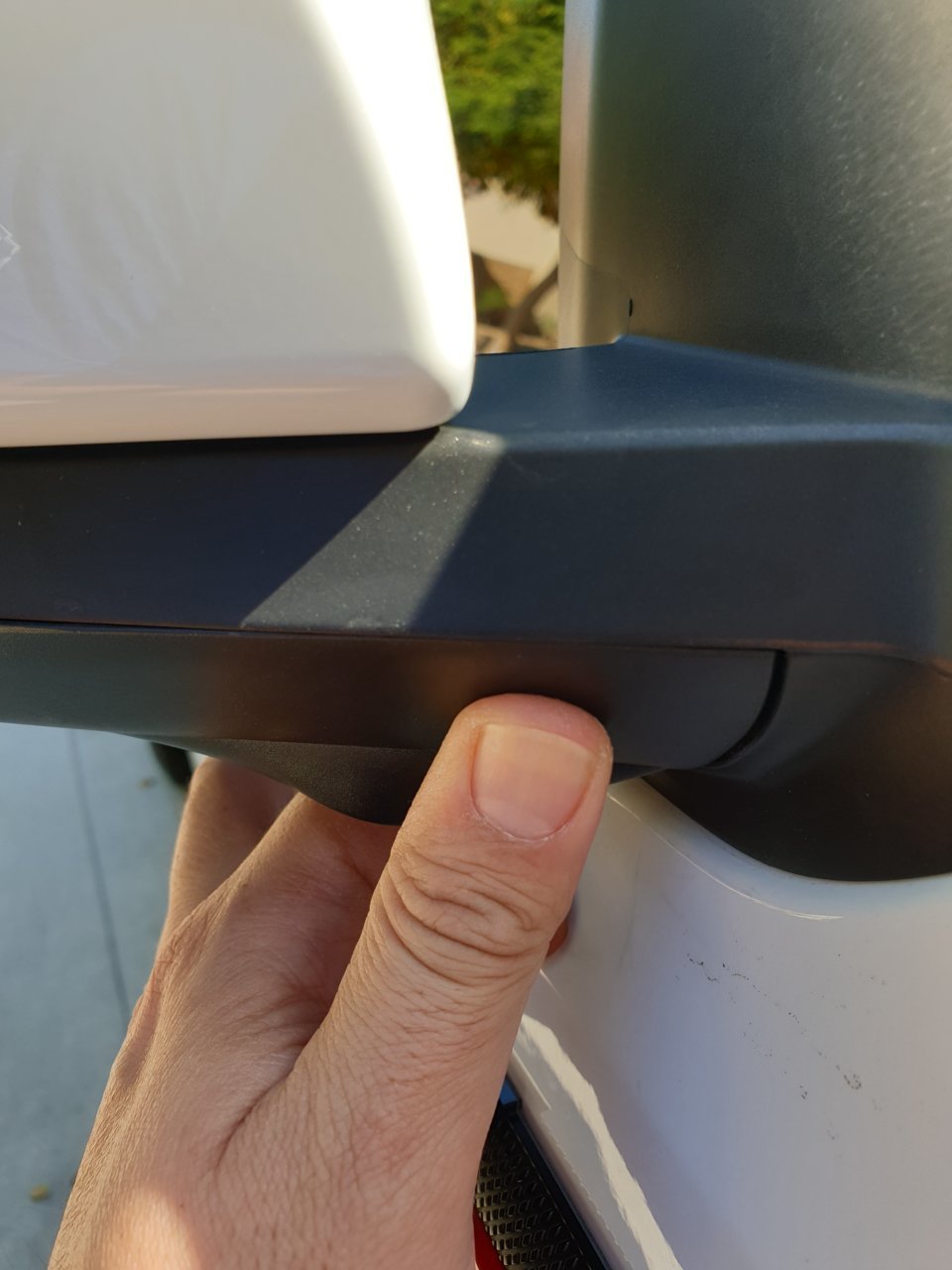

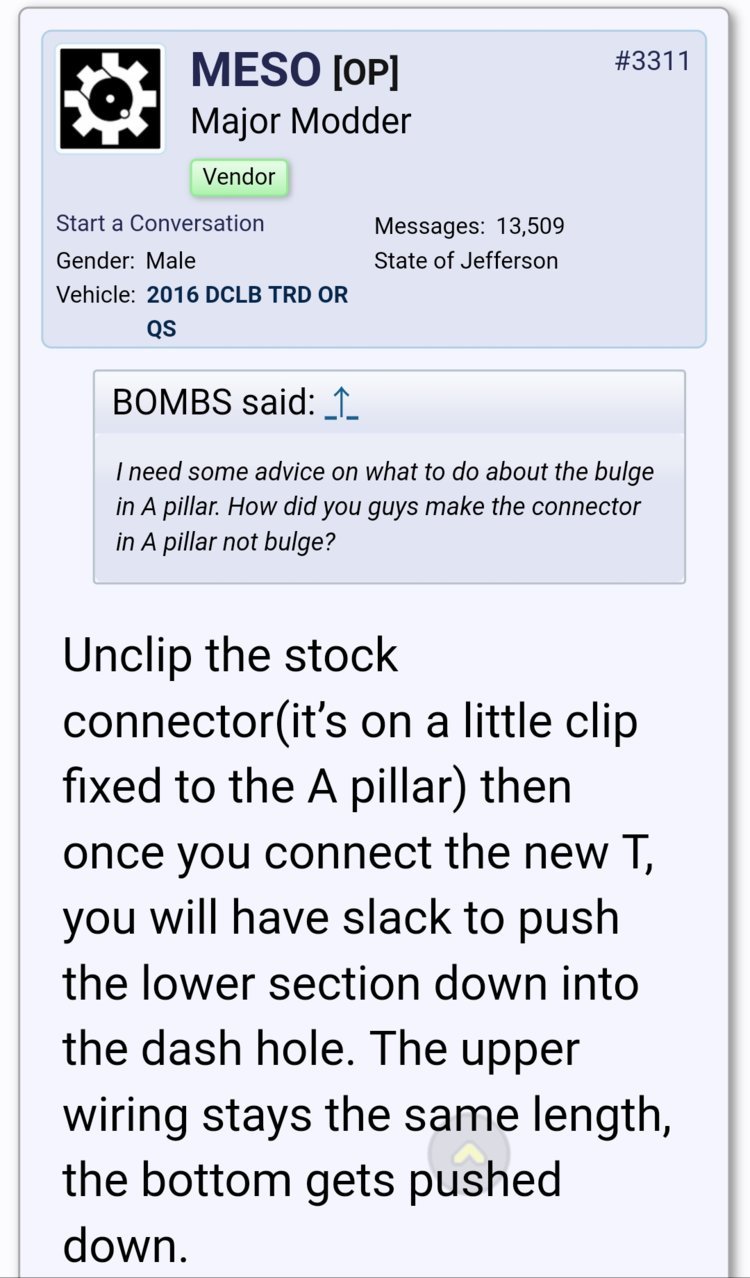

    Thanks. Got that done yesterday. That was glued on too.
    WTF is up with all of these glued parts????

    Helps Keep stuff from rattling I think? Any luck on windows

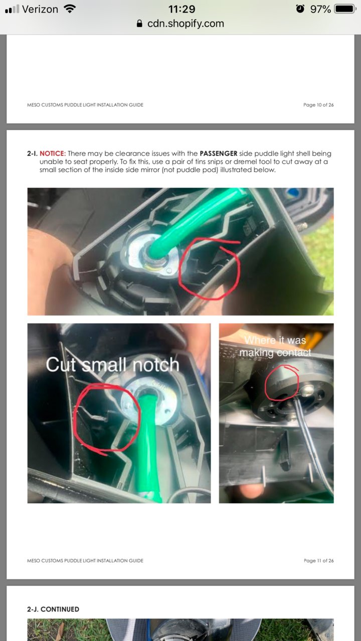

    Can i buy just a new housing light.?. passenger side does not stay on.. it comes off.. probably i messed up the clips..

    Did you cut a small piece off of the base?? It won’t seat flush if not cut. Also, make sure your wires are not in the way.
    Octaviolg[QUOTED] and Tacospike like this.

    I did brother.. just the clips broke from housing..

    Here..

    Yeah, that’s not good.

    I did.. probably i messed up the clips that hold the housing...
