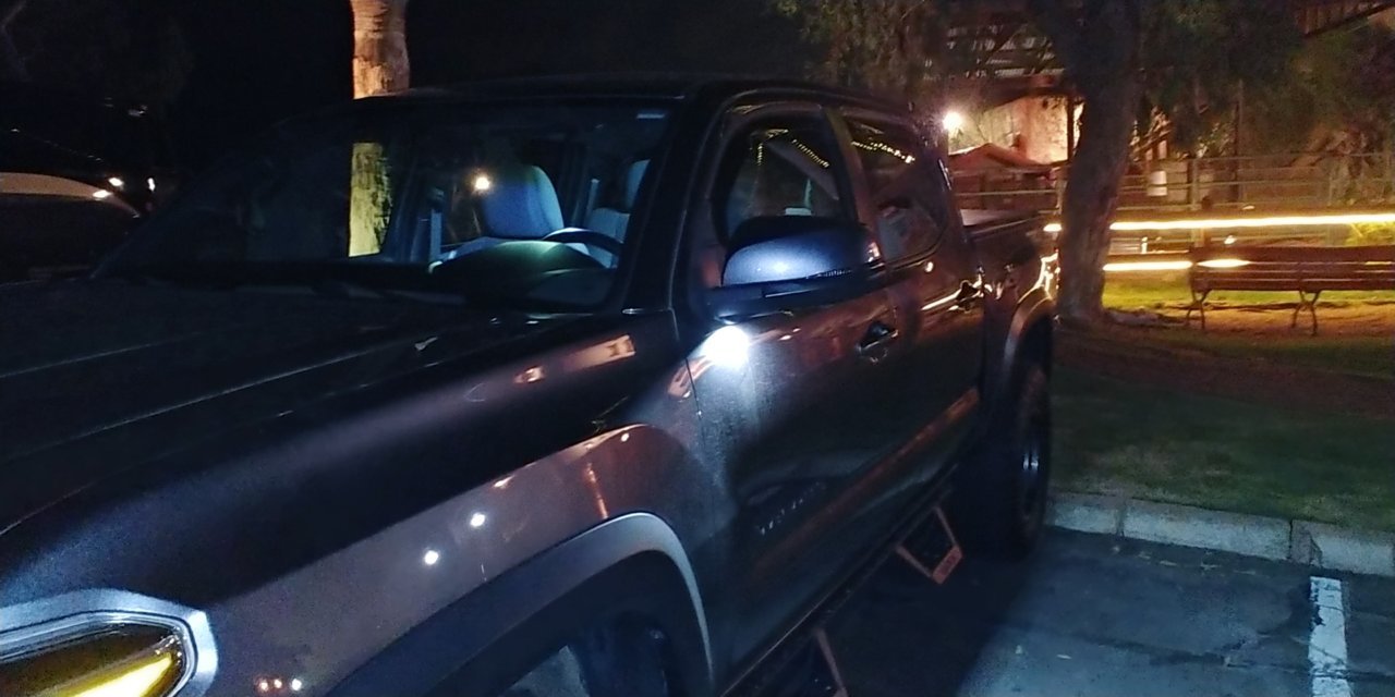

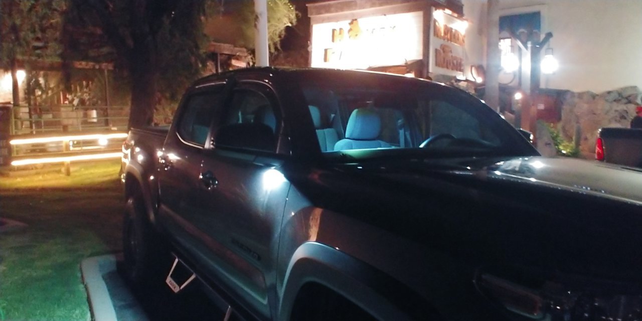

    Finished my install this past Sunday. Took me about 4 hours but at the same time I had the door panels off I was installing sound deadener and foam in speaker holes. Little blood, a lot of sweat, maybe a few tears but I finally got this install done. Thanks Meso, another fine product.

    Little blood sweat and tears definitely makes if worth it
