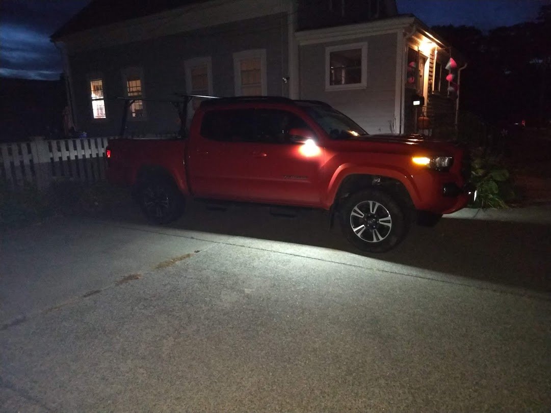

    Installed mine today in the sun along with meso's turn signals.
    ZwVC15RrEb1fbRxHchsDNyGGSQJUOL2mHbIlOmXE_d43457c9c3897d62c943438b8d01993c79f1a618.jpg
    Took about 2 hours total. Snapped off a couple of the tabs on the driver pod mount so it has a gap (message in to meso to buy a new one) but it was at out of 10 install. Time consuming but not too hard. Honestly the tough part is getting the wire through the rubber tunnel and up the door. Everything thing else was okay.
    Followed the PDF and the YouTube vid I found on how to install.
    Definitely a fan of meso products!!!
