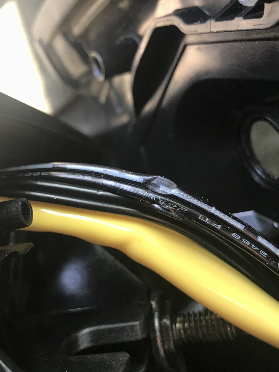

    Looking for some help here, I PM'd @MESO but wanted to see if you guys have any advice as well. I installed my puddle pods and now both of them will not turn off unless the battery is disconnected. The dome light circuit is also screwed up, wont turn off (even with doors locked and truck running) unless the switch is in the off position. At first I thought that I fried the body control ECU (saw on other forms that LEDs can do this on 3rd gens) but this wasn't the case. I narrowed down the problem to the driver side pod, when I unplug it from the plug in the door panel, everything works fine (passenger side pod and dome circuit since driver side pod is unplugged). Is this a bad plug or bad LED on the driver side? Or a short somewhere between that plug and the LED? Thanks!

    I am having the exact same issue currently, my driver side one is the problem. Did some diagnosing and when I unplug the driver side at the harness in the a pillar, my passenger and map lights function as normal. Tried switching my driver side pod plugs around and it didn't resolve the problem at all. @MESO is sending me a new T harness and driver split harness which should hopefully fix the problem. For future reference, pulling the a pillar plastic is much quicker than the door panels lol.

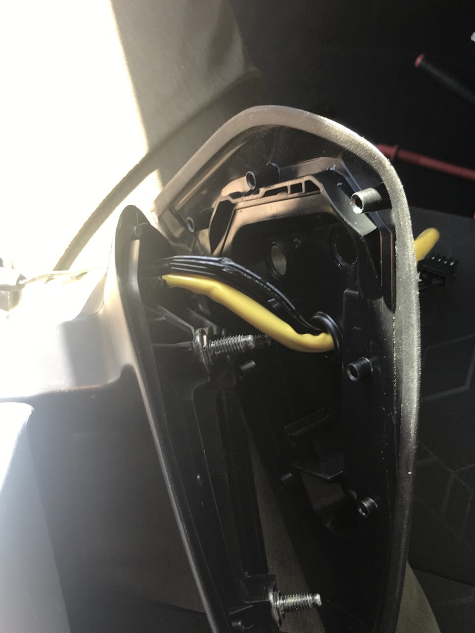

    Huge shoutout to @Sleevez and @Dakota3645 for the help. If anyone is having this problem, check the wire inside of the gasket area of the mirror (it can get crushed while tighten down the 3 nuts to re-install the mirror). I cut that section out and soldered it back together and now everything works as it should! Thanks for the killer products @MESO, just messed up on my end!
