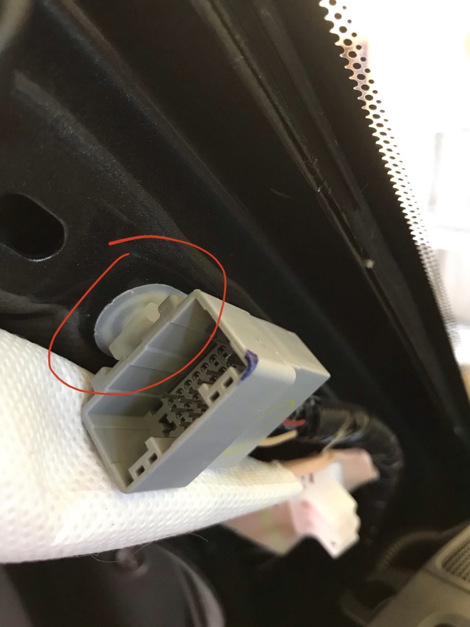

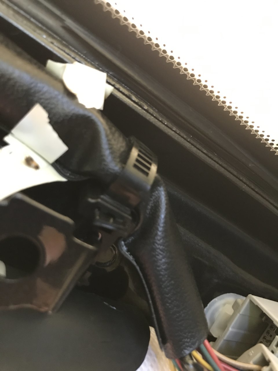

    Apologies if I missed it in this thread but I don’t remember seeing or reading anything about a clip holding the female piece of the harness in the A pillar attached to the A pillar.
    I know I’m supposed to snip the black retainer clip to slide it down.

    Remove it from the A pillar so you can slide it and the wire down to give you room for the new plug adapter. Otherwise it will bunch up and getting the trim back on is very difficult.

    Pull the plug off the A pillar. Move the clip to the Meso plug. Attach (EDIT: the Meso plug with the clip) to the A pillar. Slide excess cord down through the dash.

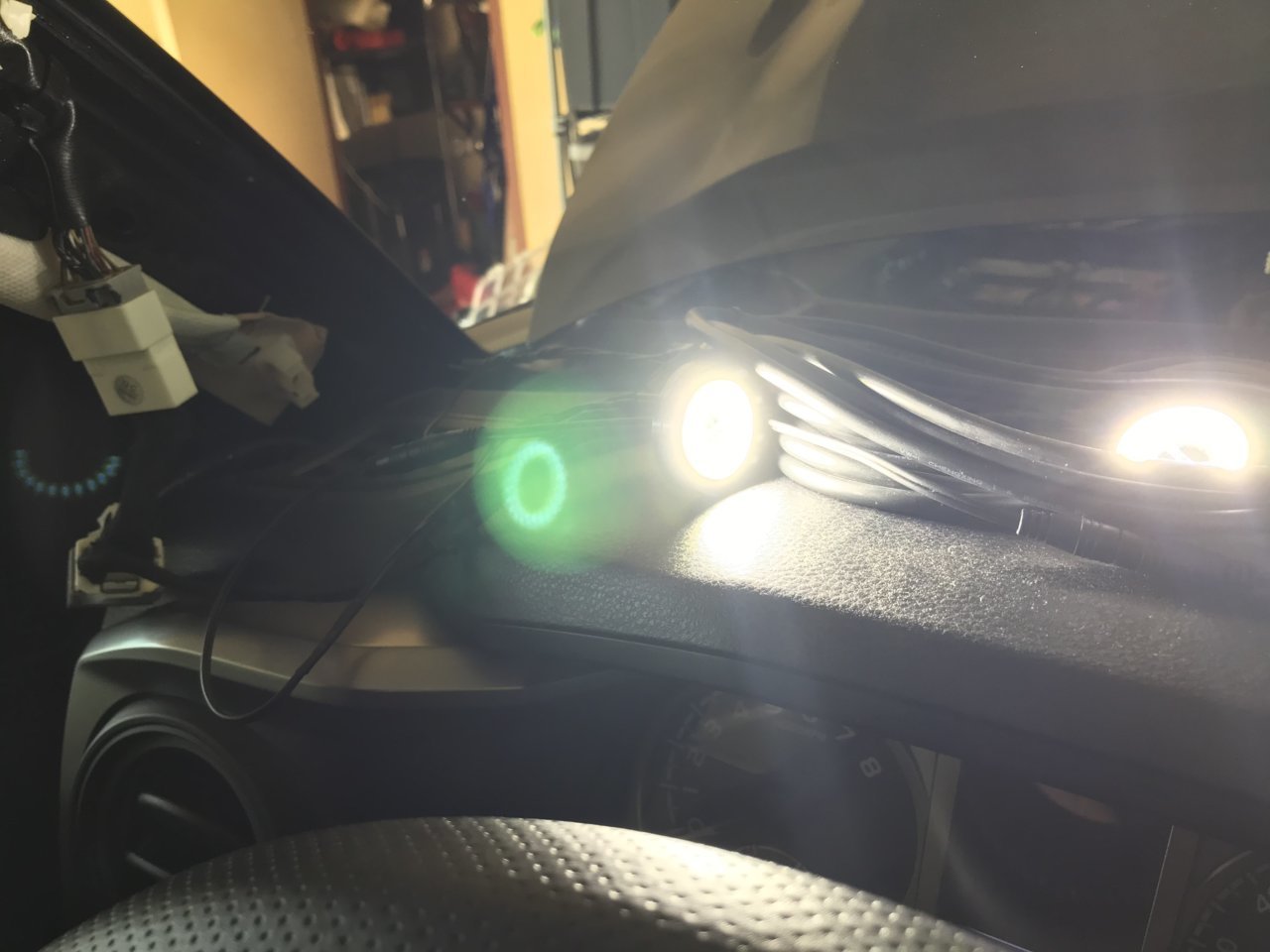

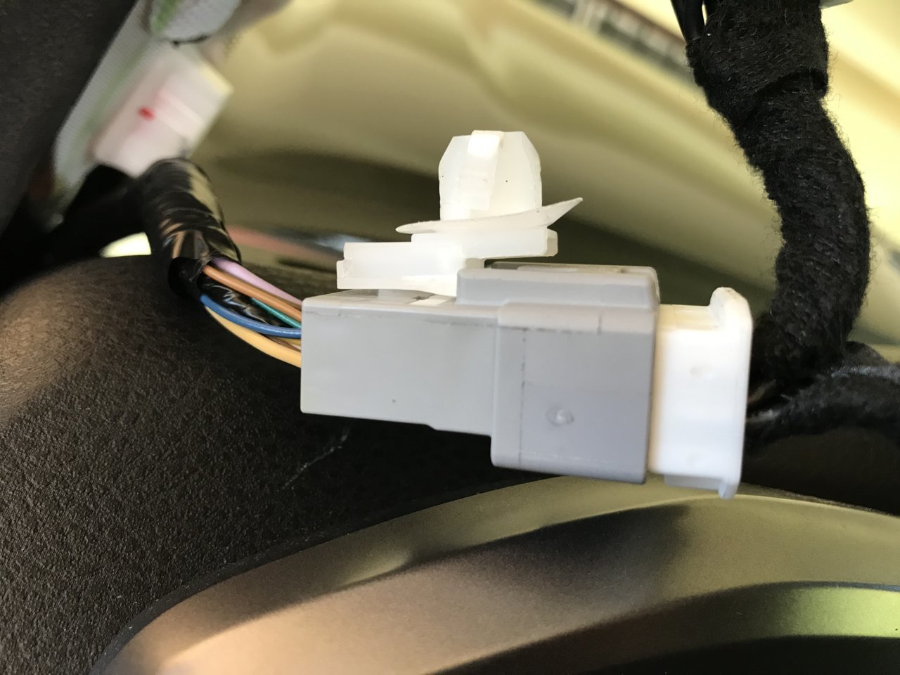

    Got it. Thanks, guys. That white clip was just a pain to get off... from both the pillar and the original harness. I half mauled it but finally got it to come off.
    Just wanted to test it before the actual install as @MESO suggested.
    So far so good...
    Planning on doing the actual install on Saturday together either the speaker upgrade so I don’t have to worry about time and getting to work. Hopefully someone's on in case there's any hiccups. :fingerscrossed:

    FYI.. stubborn plug clips can be persuaded with a small screw driver or pick inserted between the locking clip and the retainer. :thumbsup:

    My clip was so stubborn that I ended up just cutting it off out of frustration and using felt tape to secure the harness to the Apillar so it wouldn't move around. :rofl:
