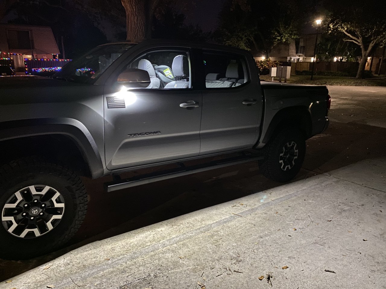

    A93DEF08-5566-4E9E-A13D-F78D83C87C30.jpg Got it done! Took about 3 hours, had to fight the driver side boot and driver side door control plugs for a while. I was watching step by step the video that Project Onix did of his install. Once the driver side was done, the passenger side was a breeze! If I could get it done myself, anyone can. Pretty impressive light coverage on the ground surrounding truck, so I can definitely see myself using these as makeshift rock / trail lights. Can’t wait for the release of the switch. I’m curious to see how it gets installed, and options for where the switch can be placed. Give us a heads up @MESO once ya release it! All in all, love the Puddle Pods!

    Had no clue! Good to know for future reference, I’ve got a couple people I know that are awaiting Puddle Pods to be back in stock.. I’ve totally turned them on to them, gonna help on their install and will scan that QR to see Stews instructions.
