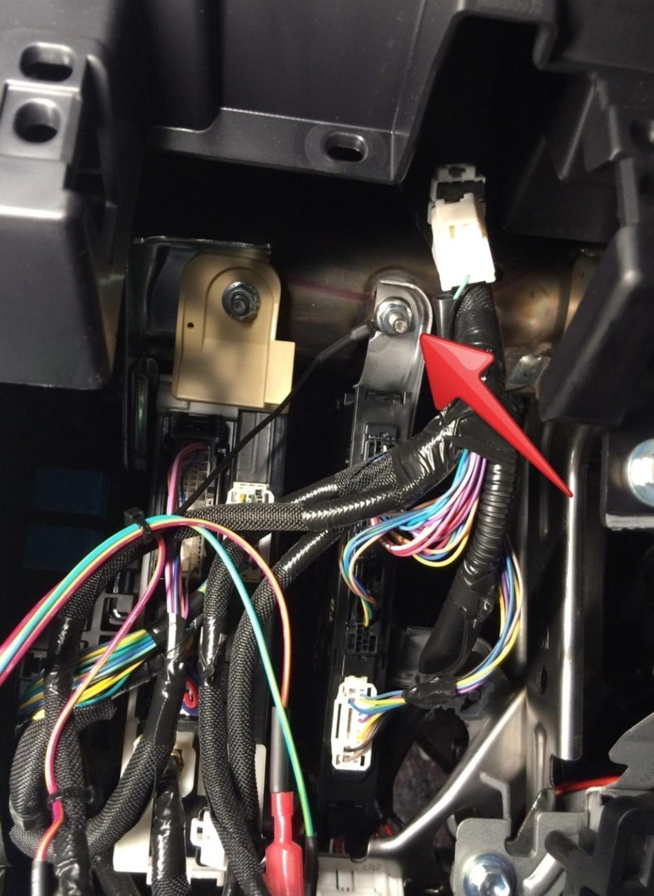

    there might be away around that. Maybe just take off the mirror and door panel where that first wire connect is, that leads to the main harnesses. I don’t know for sure how it will be done but that might be possible

    At this location

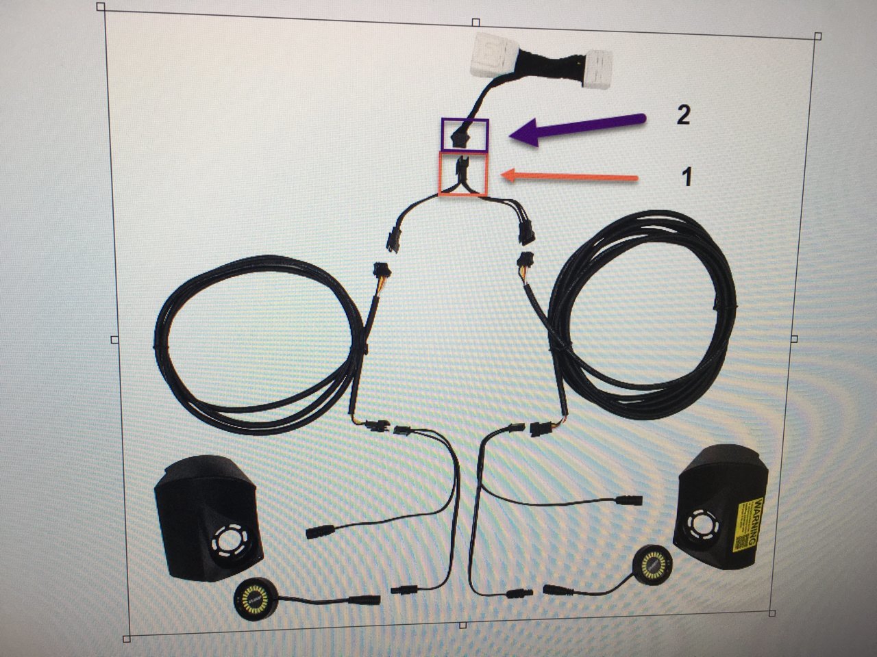

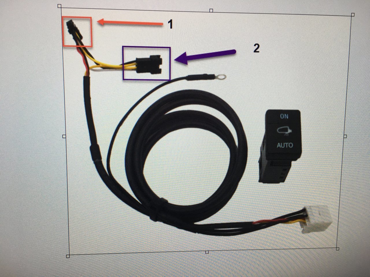

    In your picture, does the new puddle switch wire harness just connect to the Y splitter wire and the 2 white block connector piece?

    For the switch it looks like it connects to the 2 white block connectors

    So just take off the driver a pillar, plug in and drop down the switch harness to desired location, ground and plug it in. Best estimate 10-20 minutes depending where you run your switch.

    Correct. Plugs right AFTER the main big T harness in the A pillar(and before the rest of the wiring down stream)
    Run it over to the location of your choice, ground the black wire and pop it into place:D
    P.S- the LENGTH of the switch harness is 5ft. Which should be more than enough to make it over to the lower center console, up overhead, or the left side panel.

    Radio mounting bracket? Just share the same mounting hole with the ground.
    looks like the ground doesn’t need to be close to the switch so you can still ground behind the left side dash.
