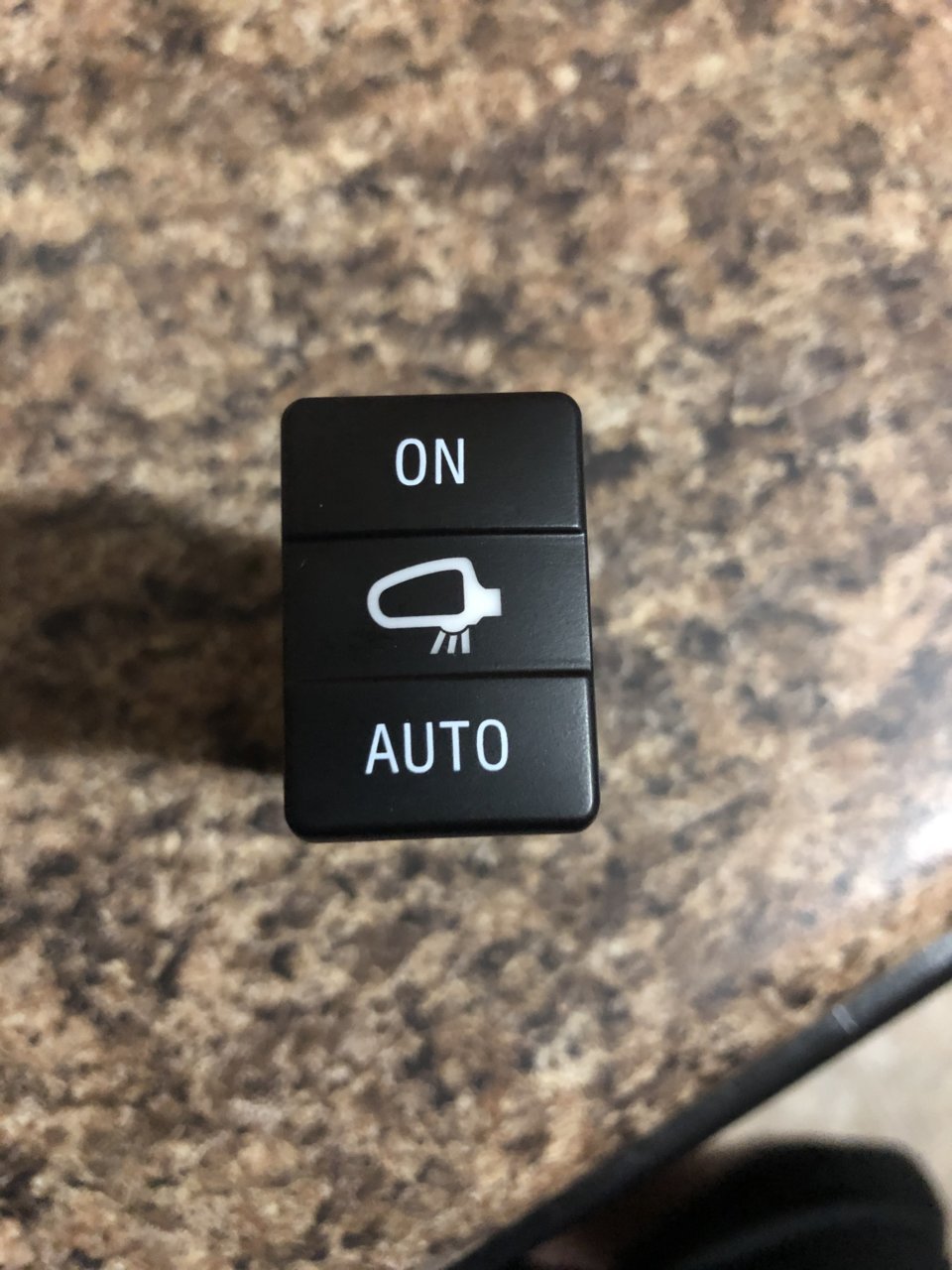

    I made a super quick and dirty diagram. Maybe @caribe makaira can clean it up for me:rofl:
    Anyway hopefully this helps anyone that may want to adapt the switch to something else...
    There are 4 pins. Pin 1, and 3 and 4 are straight pass through(with taping off), while pin 2 Gets intercepted.
    AUTO- Lets pin 2 pass through like normal(as if there wasn't even a switch)
    OFF-Breaks pin 2 so there is no circuit
    ON-Connects the YELLOW WIRE(puddle side) to the BLACK WIRE on my harness(ground)
    Pin #4(black in picture) is just the back light POSITIVE +12v that illuminates the puddle icon. (tapped off of parking lights)

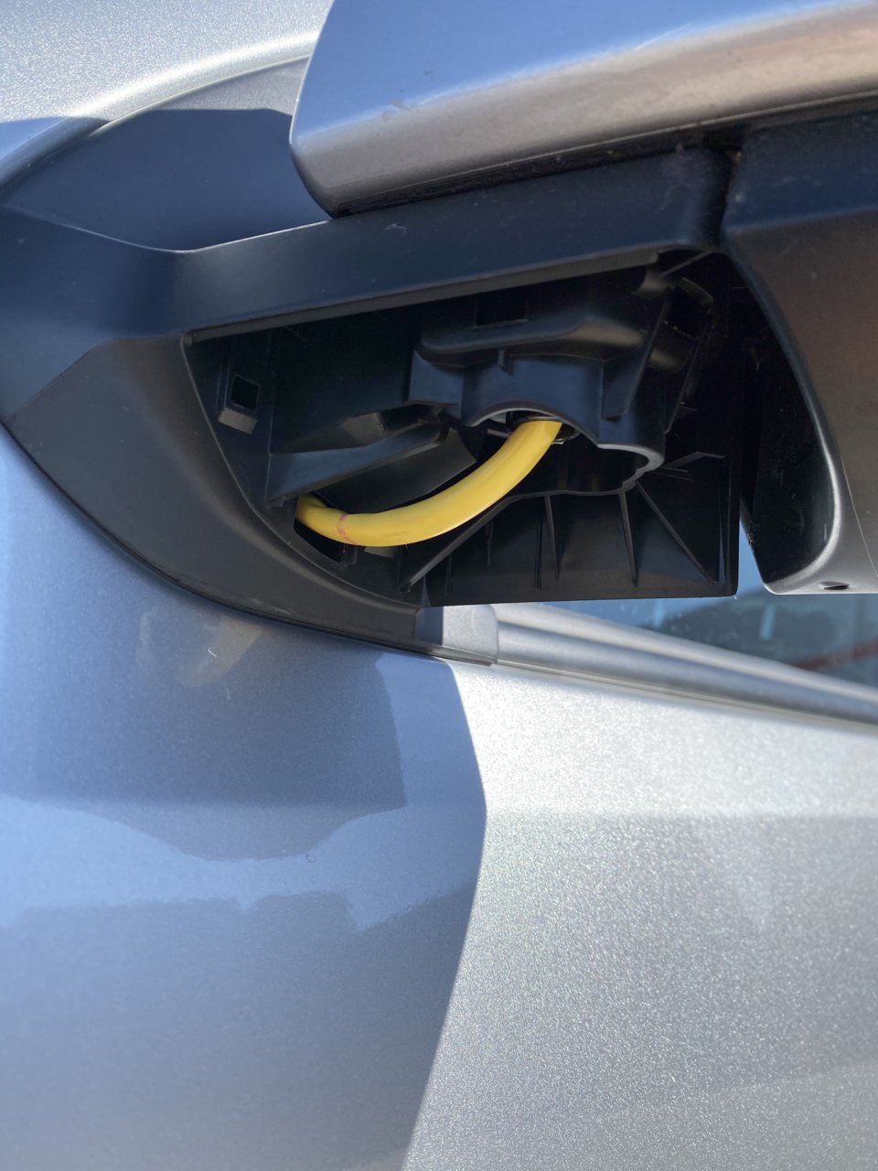

    B15369A5-F539-470D-BABB-09C6C33CA954.jpg Yes something I need and want I lost one of my caps to my driver side mirror. Does anyone have a cap that they would be willing to part with until MESO restocks the puddle lights?

    Just curious... how'd you lose your cap?

    Don’t know came home and noticed it was missing.

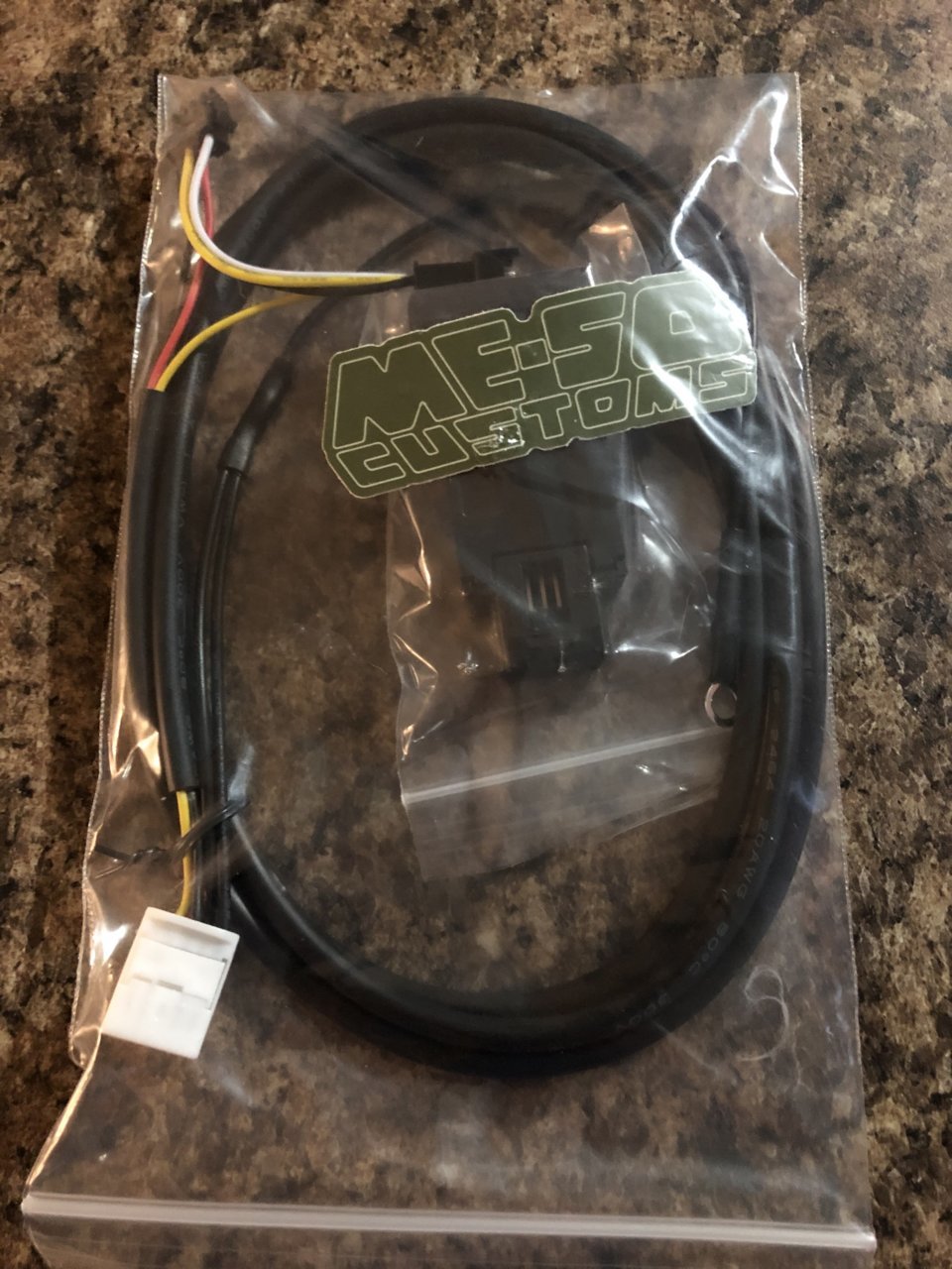

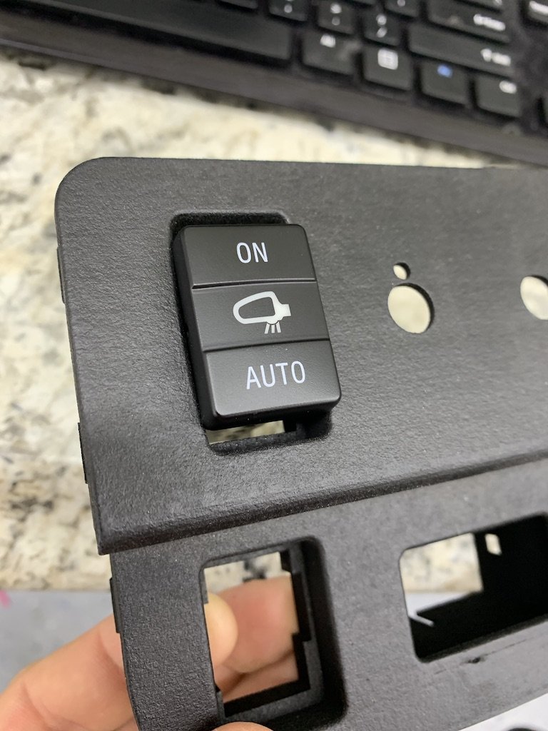

    Just received my puddle switch ready for the install this weekend in my Meso Switch-Pros panel. :yay:
    Thanks again Stew @MESO , you rock. :headbang:
    88508B69-6CED-4363-919C-24258FE808E6.jpg 53D25613-4D65-4590-81FC-912E7F8B0402.jpg

    What! That was quick, mine just shipped.
