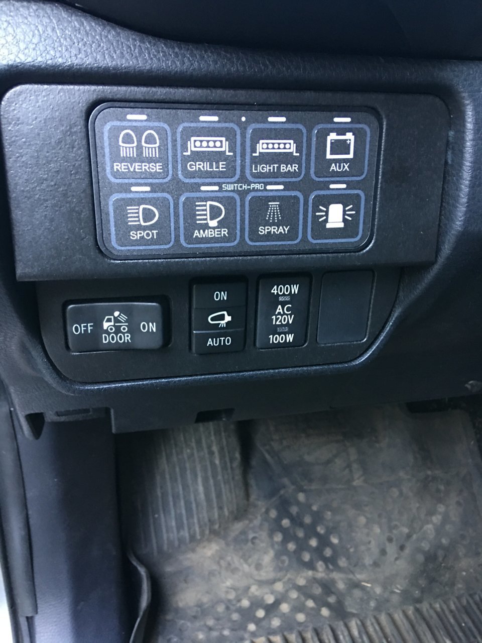

    What does the spray button do?
  17. Feb 14, 2020 at 5:34 PM
    #5037
    brentano
    brentano Well-Known Member
    Oct 4, 2016
    #198952
    68
    Pressure marine sprayer located in the rear cubby and sourced from a water tank in my camper.

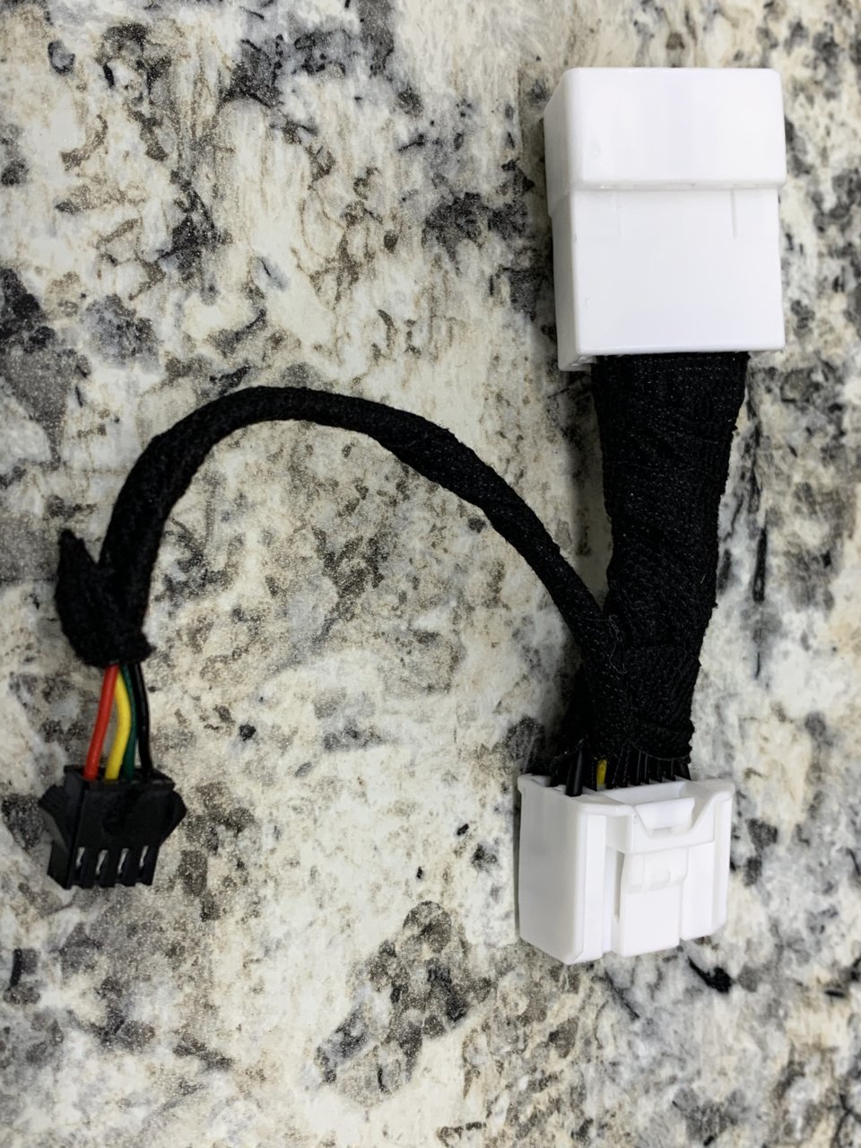

    Is the new switch supposed to light up at all or have any back lighting? I just installed mine and everything seems to be working but I thought the switch was supposed to have some blue back lighting.
  20. Feb 14, 2020 at 6:37 PM
    #5040
    MESO
    MESO [OP] Major Modder Vendor
    Feb 16, 2015
    #148809
    14,386
    State of Jefferson
    2016 DCLB TRD OR QS
    If you have the FIRST ORIGINAL puddle kits, the T harness in the A pillar did not have the illumination tap. I revised it right after for all kits going forward to include it. Easy way to tell; if the 4 wires coming off the main T are All BLACK(first version), if they are colored(red, green, yellow, black) it has the illumination. Not a big deal, the black wire coming off the back of the new puddle switch just has to tap to any illumination wire. PM me and I can help you. Here’s a pic showing the current harness with te colors
