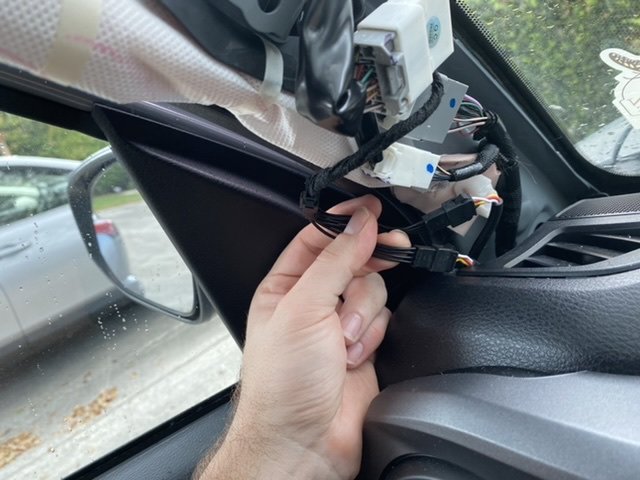

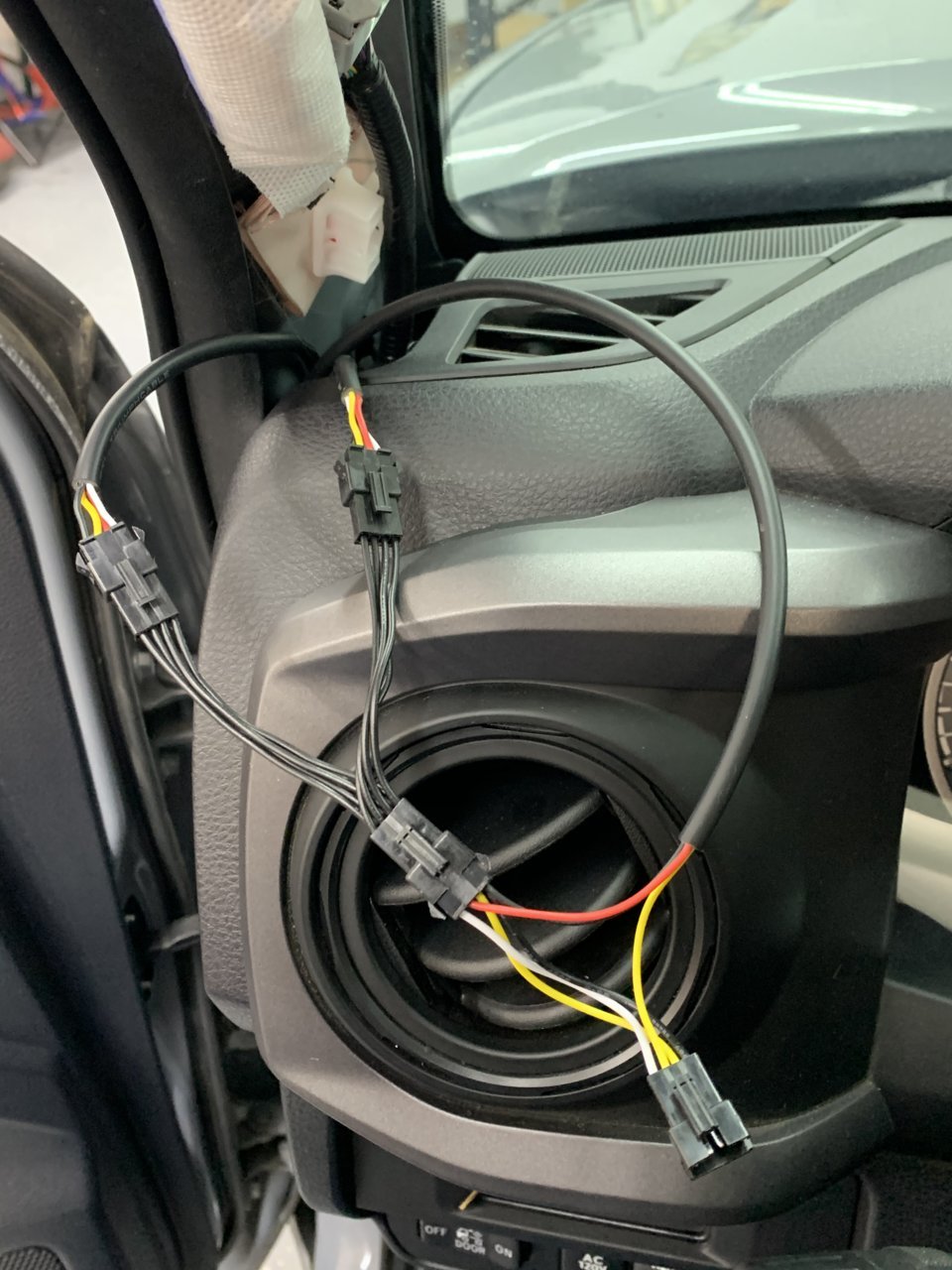

    @MESO I’m confused on how to plug the end of this switch into the existing harness? Am I just abandoning the existing 2 wires that are coming up into the A pillar and plugging in the switch instead? See photo...3BE6110A-496B-4DDB-AA2F-5AE34B2F2A39.jpg

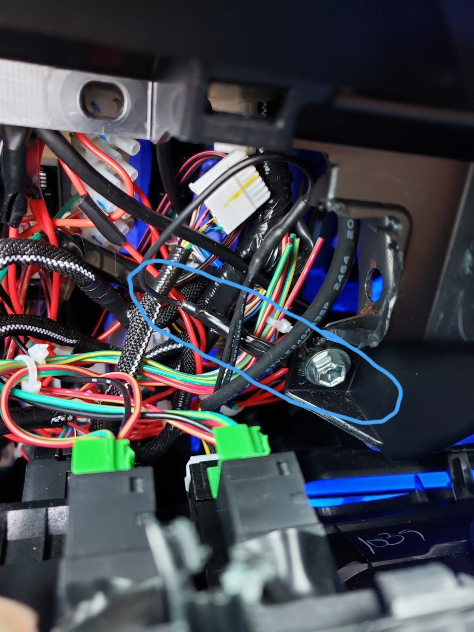

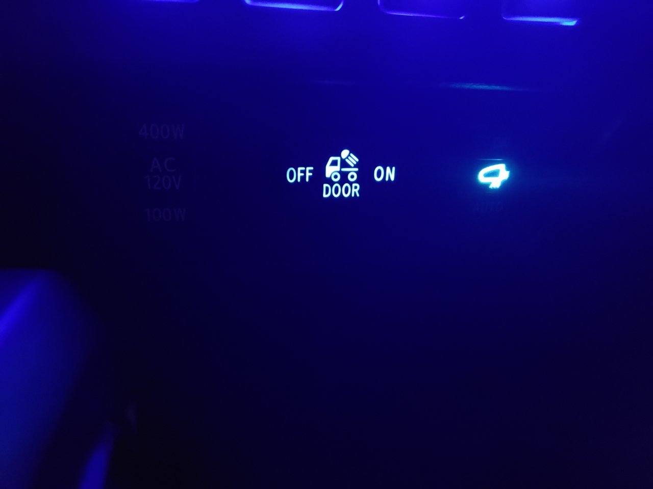

    20200215_152347.jpgNote the blue circle

    So, behind the left piece of trim on the QI charger area, there's a bolt there that goes to a piece of metal, through a plastic bit. The bolt is just a TEENY bit too big, bit can be threaded on. If you need me to take a picture of the location I can.

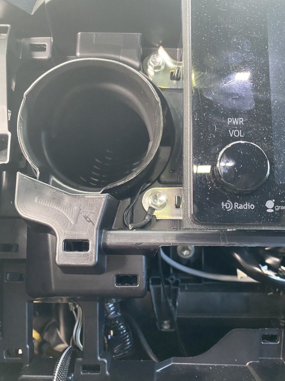

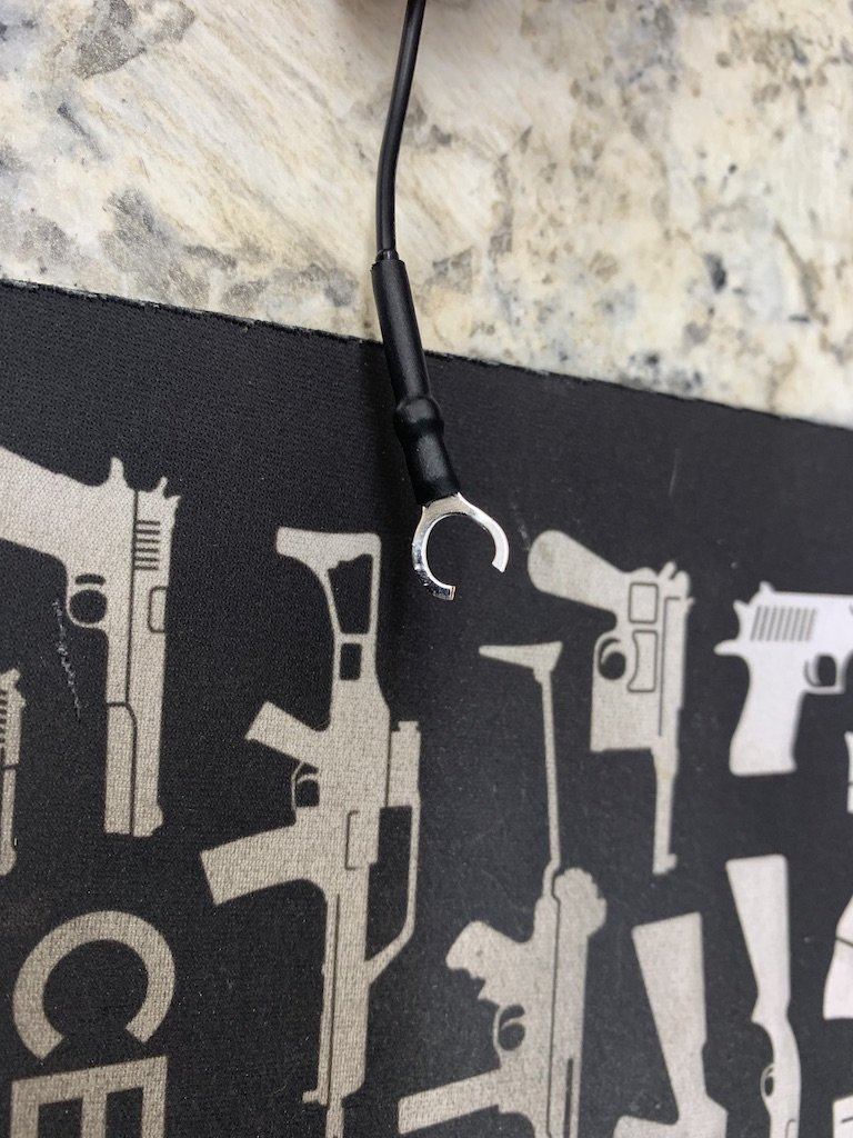

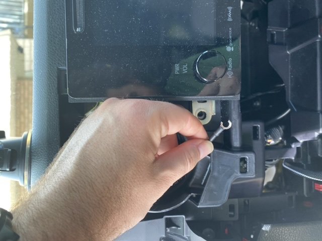

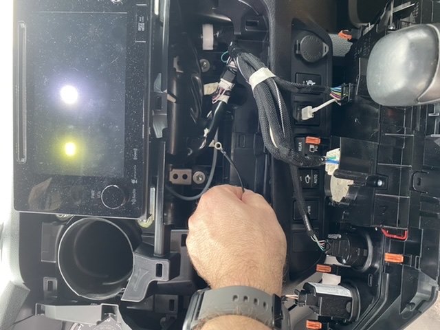

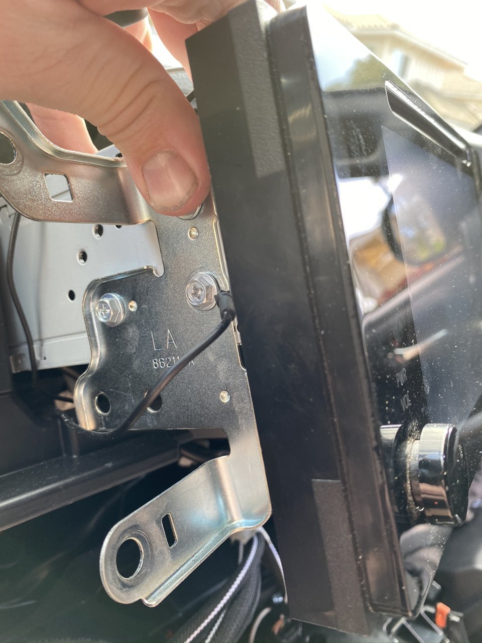

    Thanks @MESO i went back and saw @Tacospike post and got it all wrapped up. Thanks for the advice on modding the ground loop by cutting it. Was scratching my head looking for a spot. Grounded to the radio bracket, has to fish the ground wire up next to AC tube.
    BBE3EC66-BF72-4C95-B2C5-BA60A077E7DE.jpg 382CF493-456F-421F-A418-D823BC367C4C.jpg

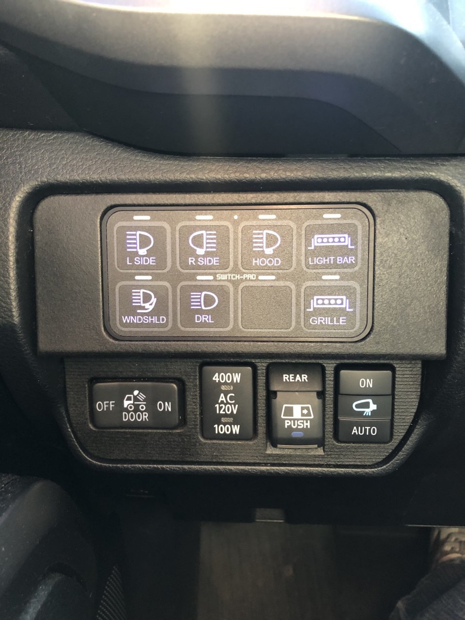

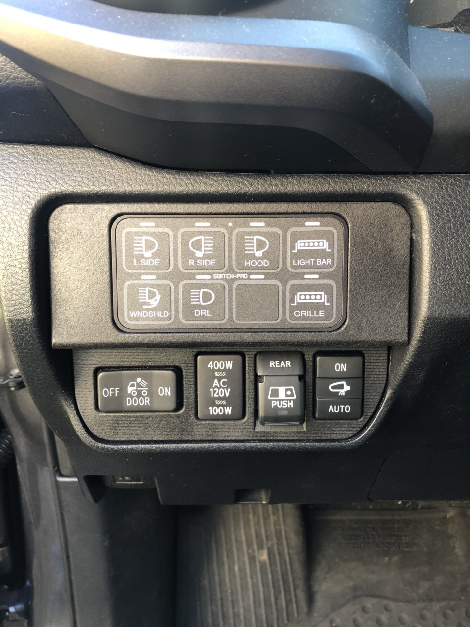

    Shout out to @MESO for such an amazing product. Finally mounted his custom panel and the puddle light switch.
    I love how flush the Switch-Pro sits now.
    Thanks again Stew for answering all the questions I had. You are the man !! :bowdown:

    Installed mine I decided to attach the ground to the side of the radio there was already an 8 mm bolt and didn’t have to cut the ground wire loop20C5E85A-1363-42BA-BA47-862B60B44F9C.jpg

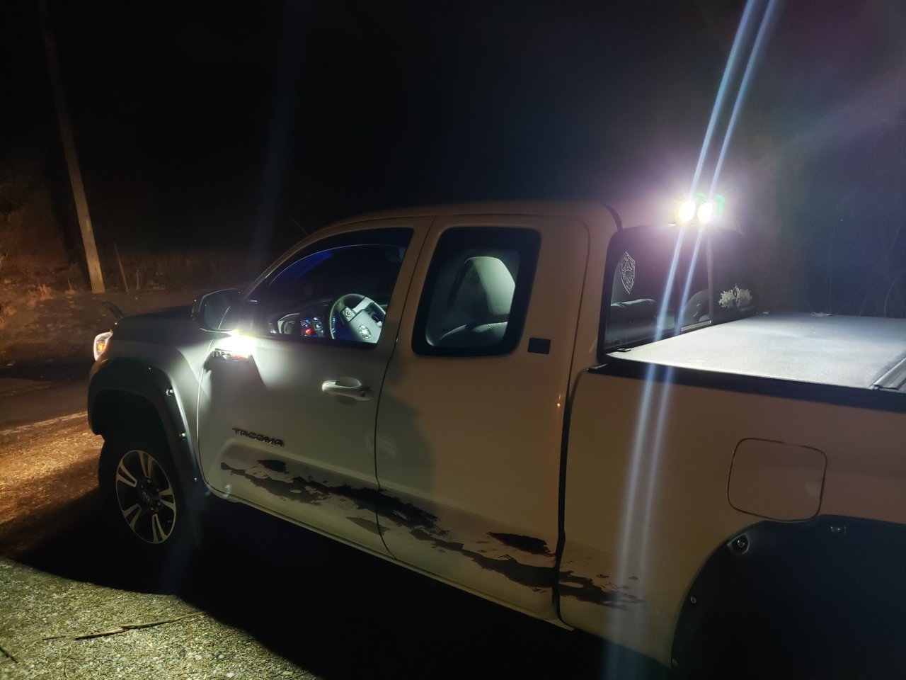

    Night pics!
    20200215_183646.jpg 20200215_201600.jpg workin' the night shift, I got light for days!
