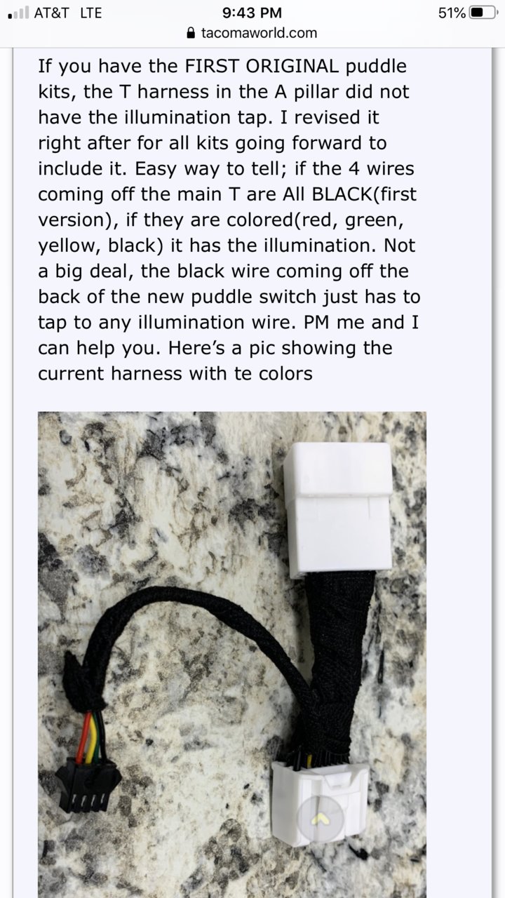

    I tapped my under the dash on the fuse labeled IG1-2 , with an add a fuse . No problems to report
    Light comes on when I start the truck and goes out when I turn off the truck.
    Hope this helps
    Edit , only if you have the original released puddle lights. He has since revised the t-harness and is now plug and play

    The meso switch gets its illumination from the parking lights through the t-tap harness. The ground wire coming off must go to ground, not to a 12v+ like the wire you are tapping off of. There should be no cut/spliced/taped wires. Just the plug in splitter and the single 12v- coming off the switch.

    Unless you have the original released puddles like I do. I had to modify the puddle switch and tap it for illumination.

    Can you show me what you modified please?

    It depends on which T-harness you have , Meso poses this a day or so ago...
    corgimas and Tacospike like this.

    Yes . I will pm you

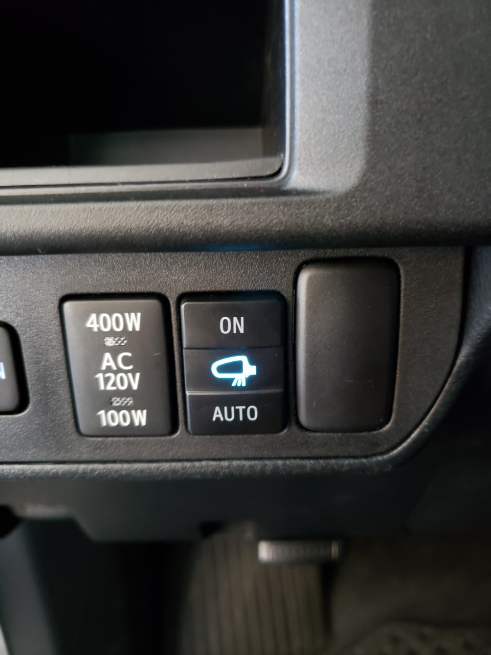

    20200216_131729.jpg Thanks to @Frsh2df for showing me how to get it illuminated with popping anymore fuse
