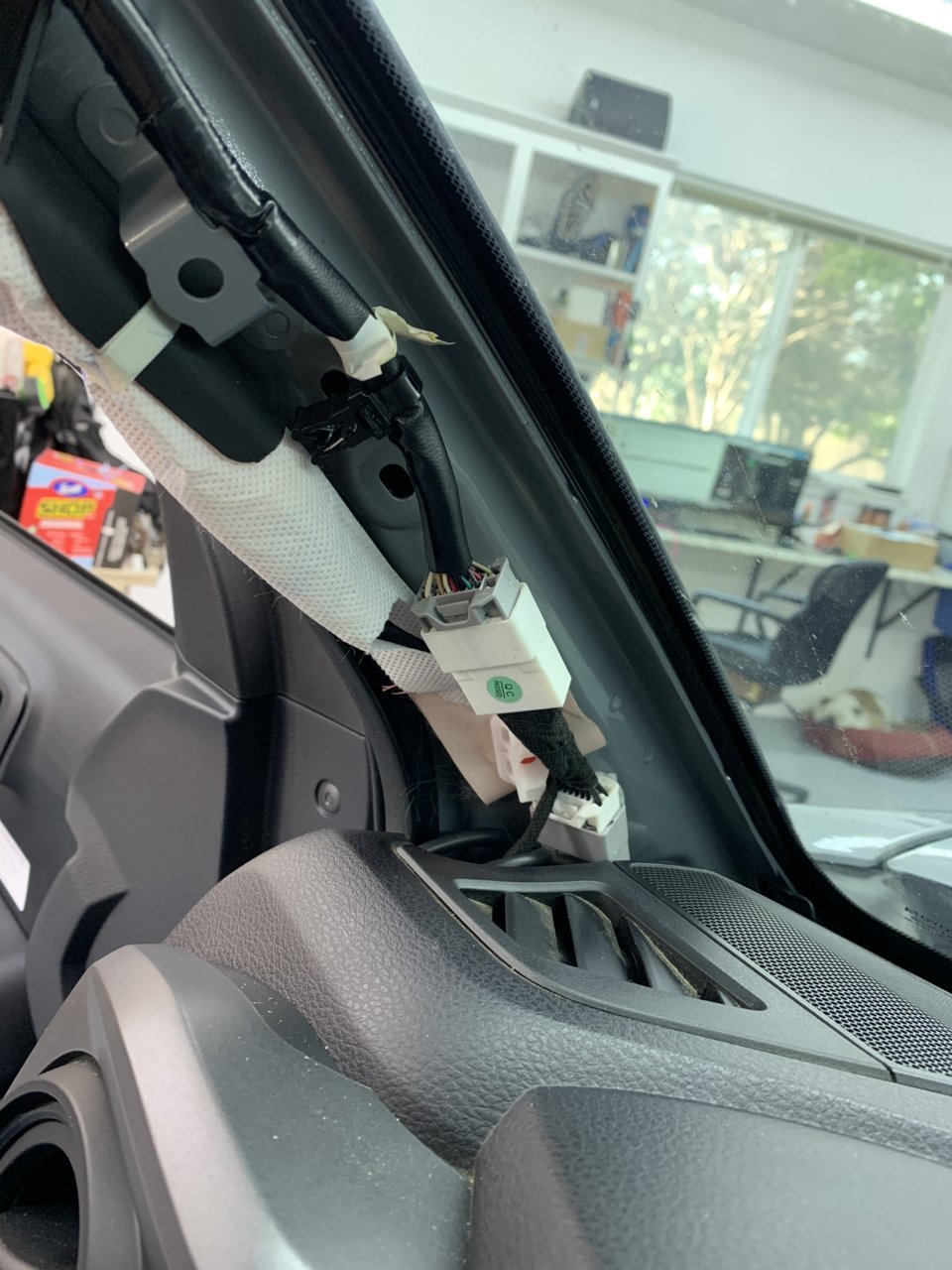

    Route wire away from the airbag?
  13. Feb 20, 2020 at 12:04 PM
    #5173
    11,726
    Yes indeed!...:burp:
    Skydvrr[QUOTED] likes this.

    Super 'Thank you' for the pics. Don't know how much this helps being I'm working with a 3rd Gen. I encourage more to post pics of their set up. As of now I have a slight bulge in my "A" pillar.

    When the original dude said gen 2, he meant 2nd iteration of the puddles, not tacomas. There should be no bulge. Reuse the stock plug retention clip and move it to the Meso plug, push all extra wiring down.

    This. Tuck the Orignal down in the hole. My new connector will sir where OEM was

    I think the OEM Christmas tree only fits on the female side of that plug. So pull it off the OEM female and attach to Meso female. Zip tie doesn't move and reattaches to stock location.

    I should add that I'm working with a sunroof- drain tube in the "A" pillar.

    Now that's a clean setup- I will have to work on mine some more-

    I have the exact same setup as you with no bulge. I should note that my oem female was never zip tied to my Christmas tree, hence why I didn’t know to do it to the Meso plug. I’ll definitely route the wire away from the airbag. But do as the man says and pull the oem connector down to make room for the Meso connector and you shouldn’t get a bulge. Also make sure the bottom of the a pilar cover properly seats into the dash.
