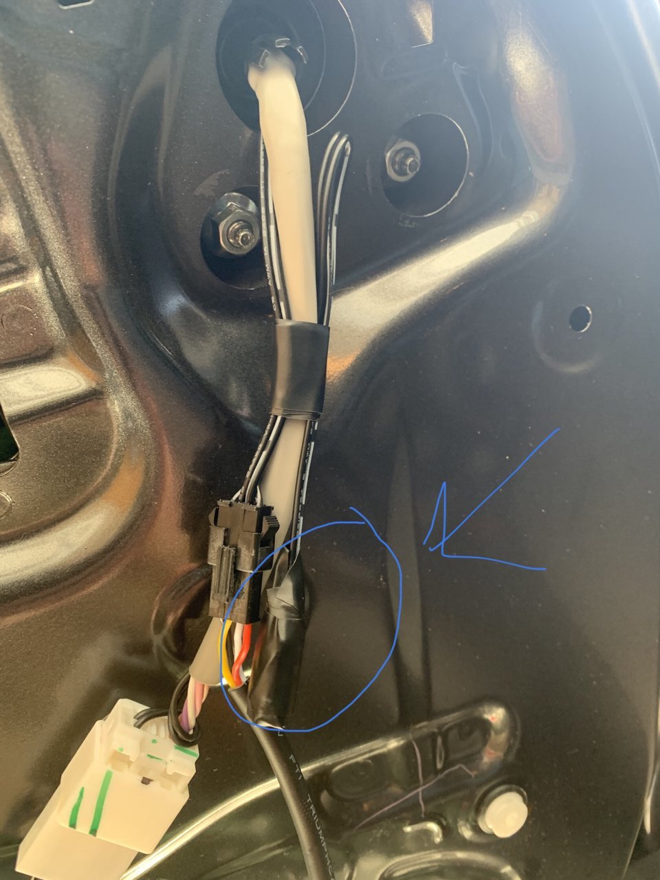

    4
    Rafael
    2019 TRD Sport Barcelona Red
    Mine has sunroof and I removed the plastic bracket in order to fit the splice harness, there's no way to fit with it.
  2. Feb 23, 2020 at 7:10 AM
    #5222
    SuperBad
    SuperBad Well-Known Member
    Aug 13, 2016
    #194456
    8,817
    Jason
    Dallas, TX
    2017 MGM Tacoma OR DCSB
    Truck stuff
    That can def happen. It can be a major PITA to get the pins to release. I would have given up and done the same in like 10 minutes. :rofl:

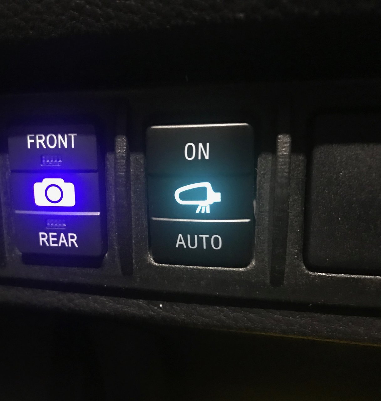

    Thanks for this. I got my switch wired up and illuminated using Option #2.

  12. Feb 23, 2020 at 4:16 PM
    #5232
    Frsh2df
    Frsh2df Well-Known Member
    Jun 7, 2018
    #255772
    1,441
    2017 MGM TRD Off Road 4x4
    No problem man :thumbsup:
    Which fuse did you end up tapping into for 12v?

  14. Feb 23, 2020 at 4:23 PM
    #5234
    bcgill
    bcgill Well-Known Member
    Jan 1, 2019
    #277739
    283
    Ben
    Blacksburg, Virginia
    2019 SR 3.5L V6 4x4 Magnetic Grey
    The 5A Panel. I already had an add a fuse on that slot for the illuminating the camera switch that is next to it. I just replaced the add a fuse and crimped in the wire from the camera and puddle light switches into the connector.
    Frsh2df[QUOTED] likes this.
  15. Feb 23, 2020 at 4:28 PM
    #5235
    Frsh2df
    Jun 7, 2018
    #255772
    1,441
    I was going to recommend that one. I had my old switch on another one, and it was constantly on. I moved it to the 5A Panel and now illuminates when the lights are on.
