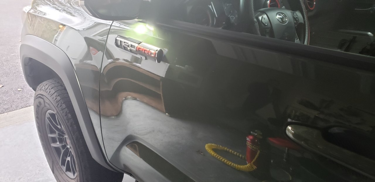

    Installed this weekend, both lights and switch work flawlessly. Love that I’m set up for the v5 side markers. Having large hands made running wires inside the door less than ideal, but worth it in the end

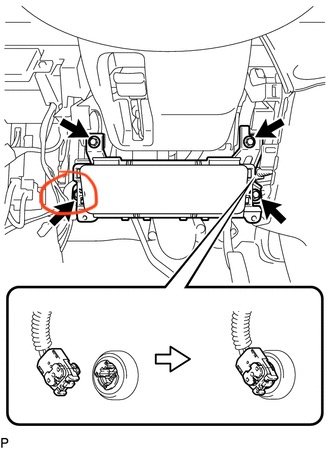

    If someone who installed their switch by the left side cubby has a picture of what they used to ground it... that would be much appreciated.

    right behind the cubby location

    exactly where I grounded mine to, just snipped the supplied grounding ring and bent it slightly to get it to fit.

    I grounded mine here , don’t have an actual pic. But it’s the left bolt to the lower airbag circled in red.

    Thanks. That looks pretty straight forward. :hattip:
