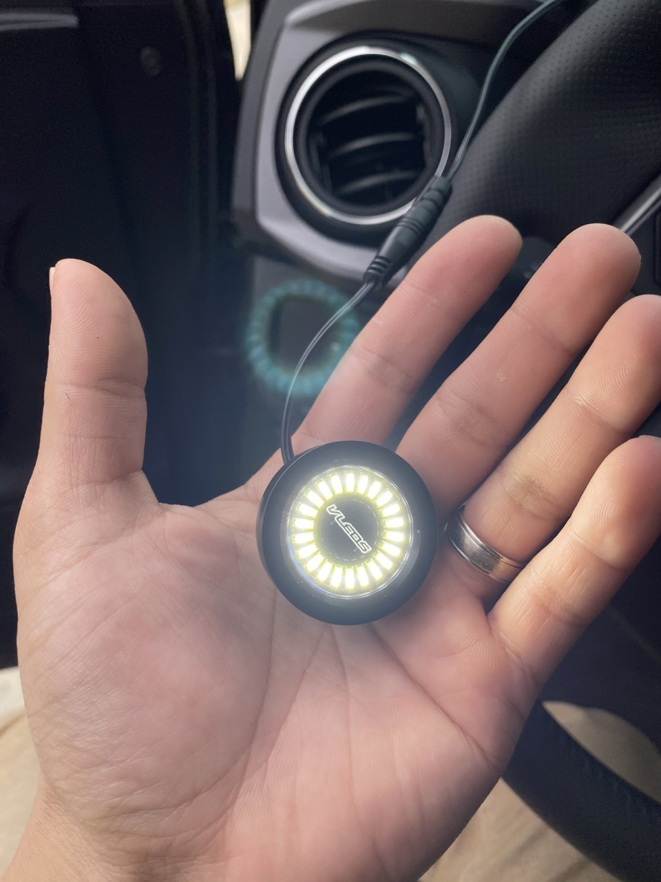

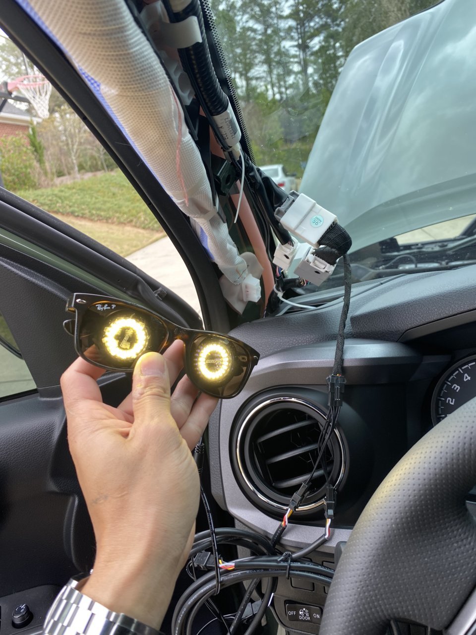

    Never mind, it’s pretty straight forward. And PNP. I didn’t get the puddle light switch, for some reason I thought my interior light switch would control on/off. But when you unlock the doors, the interior/puddle lights switch on. I like it, just one concern that the lights get really hot, not sure if that’s ok & normal? overall I’m happy with it and installing it anyways! The hardest part is just fitting all the wiring in and routing it.
    Btw I used my ray bans to look at the lights cause shit is bright as the sun.
    3468E372-FEBF-4E50-8D78-D8EDD1A8A4A7.jpg C82E91C3-EDD7-49C3-91D4-D7E232B959D2.jpg
