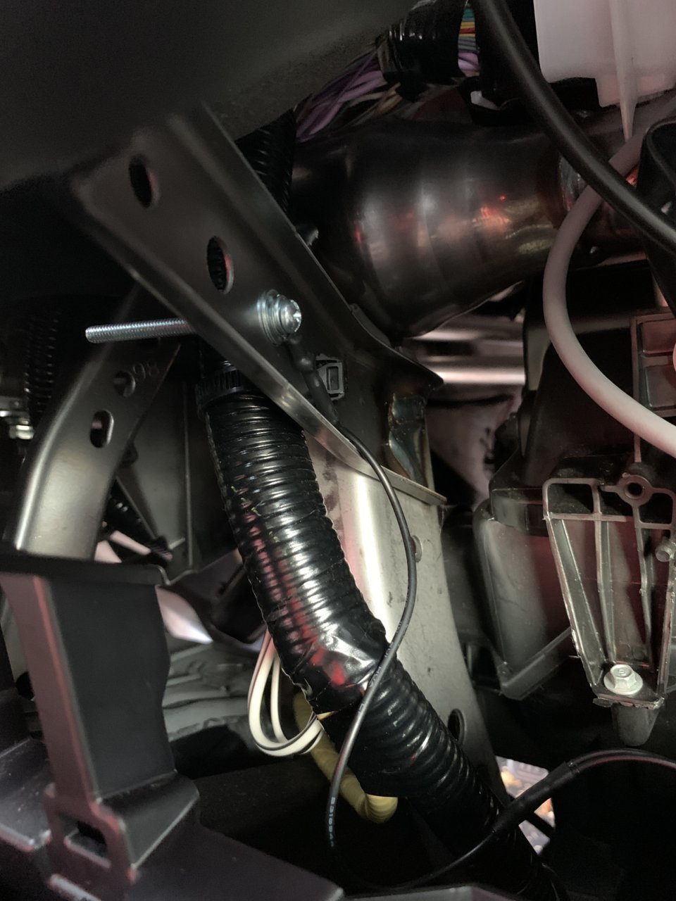

    A note on this install... and this may only apply to the 2020 Pro’s. I could not figure out a way to route the cabling behind the A-pillar so that it:
    number 1 - didn’t interfere with the airbag.
    number B - didn’t kink wires.
    letter 3 - would allow the A-pillar cover to be snapped back on properly.
    Honestly no problem because I took apart the harness provided in the kit and will (soon) T-splice to the cargo lights wiring behind the driver side kick panel. Bonus here is that the puddle-pods end up on the OEM cargo light switch. Expect some pictures when I do it. For now I’m still trying to confirm the exact wires I have to tap on the truck. As for the wires on the MESO harness, it’s the two inboard wires (black and yellow). And based on a bench test, you can run either one as the hot and the other as ground.

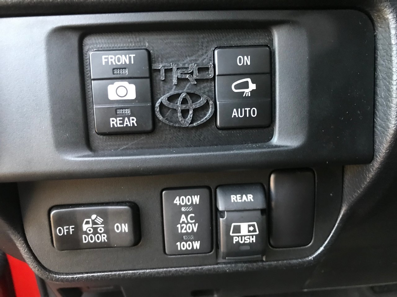

  6. Mar 20, 2020 at 5:09 PM
    #5446
    Taco de Naranja
    Taco de Naranja Well-Known Member
    Jan 18, 2019
    #279730
    1,687
    Benny
    NW WI
    2017 TRD Sport DCSBAT-Inferno
    Puddle switch installed

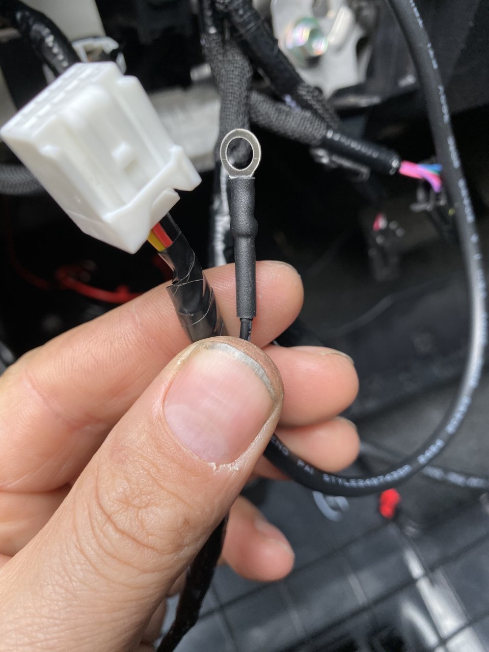

    Where is everybody grounding to with the puddles switches ground? The terminal ring is small. Not seeing anywhere nearby to connect to 69451519-2C55-4079-993B-475E4AC8636F.jpg

    Ahhh ok so just replace w/ larger terminal ring. That bolt is too large for what meso provides.

    Or you could snip a tiny bit out of the middle, to make it a U shape, and then open it slightly with pliers. It'll then fit the 10mm bolt. Well at least that's what I did lol

    just snip it with wire cutters and stretch it to fit a larger bolt.

    I put a new ring on :D
