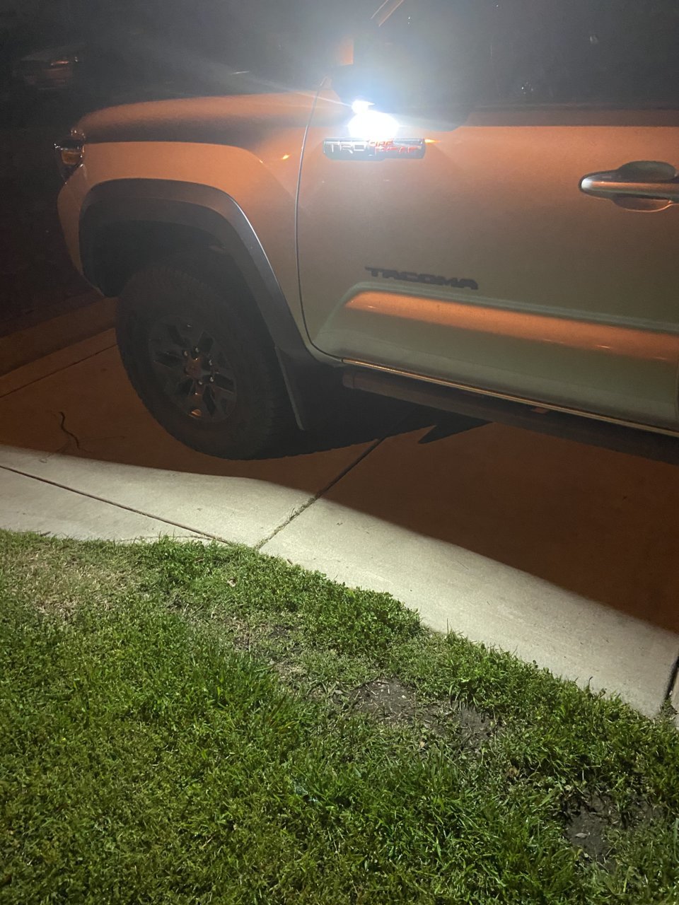

  2. Mar 23, 2020 at 8:21 PM
    #5462
    Angel Rivera
    Angel Rivera Well-Known Member
    May 18, 2015
    #155514
    89
    Angel
    Southern California
    2017 Toyota Tacoma TRD Off-Road Double Cab
    Ditch lights, front LED light bar, leather seat covers, bed tonneau cover.
    Just installed, was a bitch cause like some I tried to remove the stop latch on the door which took me 2 hrs to retighten. The other hassle was putting the wiring harness through the rubber boots, other than that everything else was straight forward, but love the output so far, hope they last.

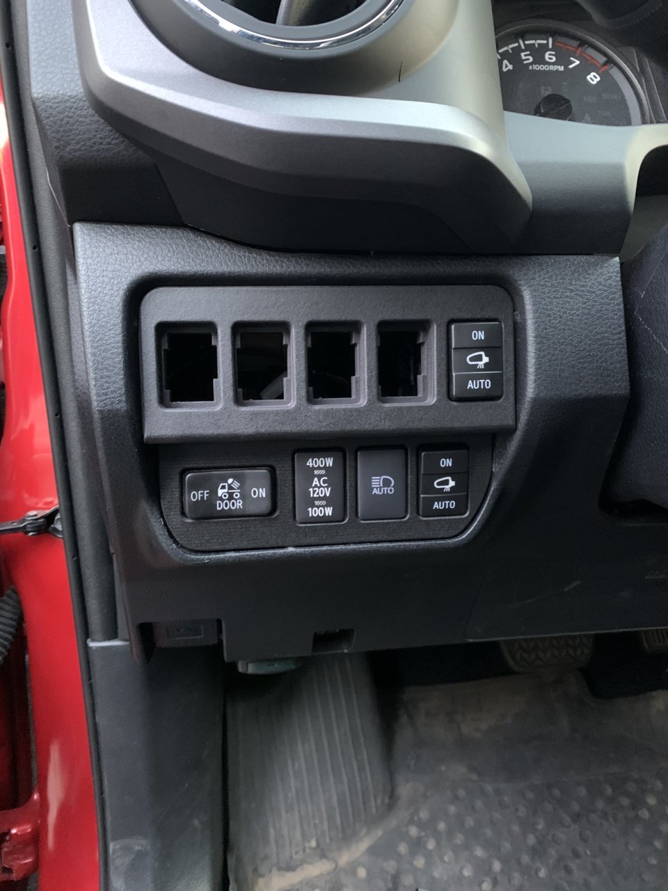

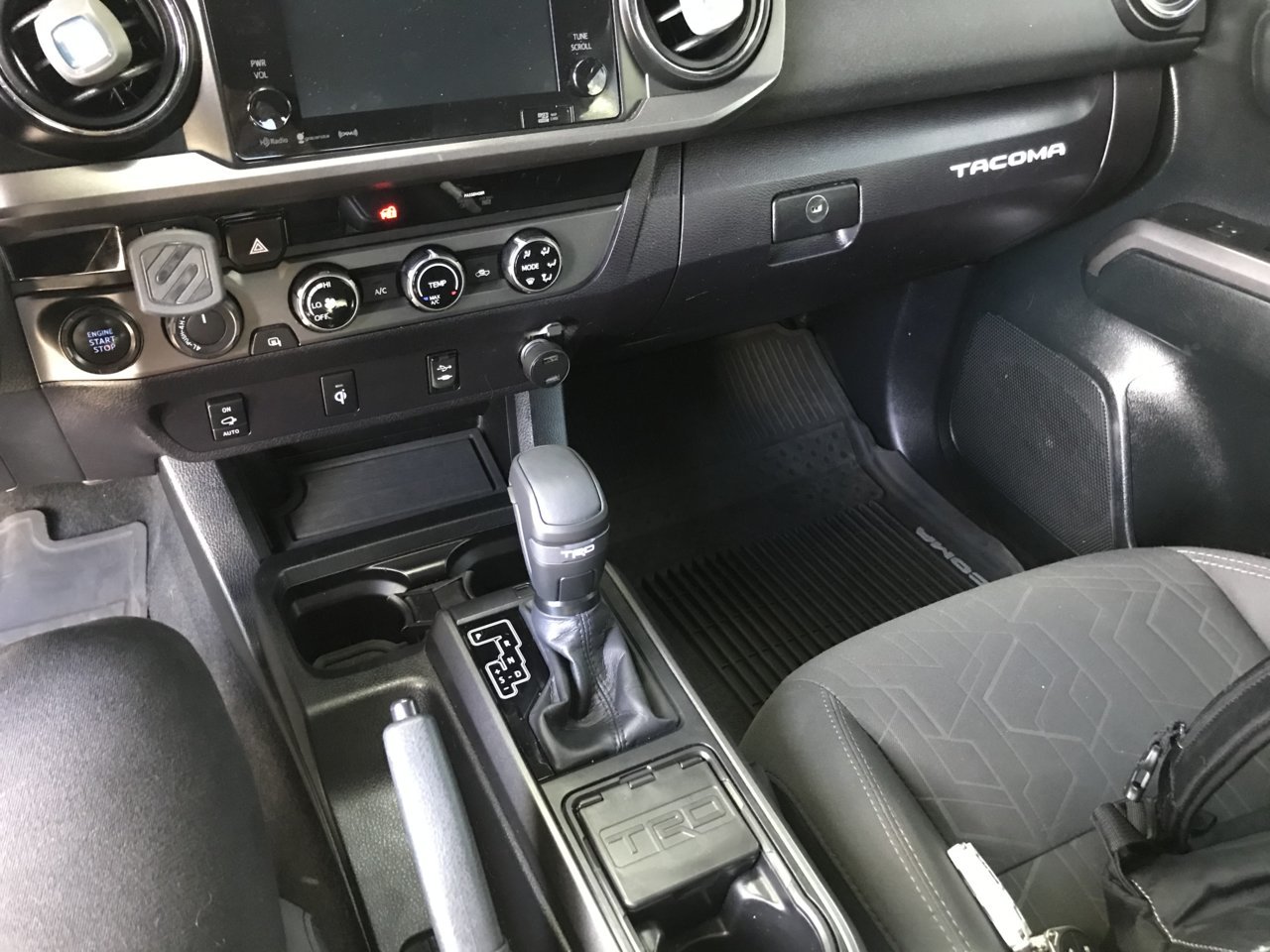

    Finally installed my switches. One for each side. Wut??
    BOMBS and Taco de Naranja like this.

    waltuo
    waltuo Well-Known Member
    Nov 19, 2012
    #91443
    1,511
    Toyotas
    My ocd senses are tingling. Cool idea though

  6. Mar 23, 2020 at 11:48 PM
    #5466
    Red18Taco707
    Red18Taco707 Well-Known Member
    May 29, 2018
    #254905
    1,123
    Richi
    Nor Cal
    Red 18 TRD POOR
    I know I need to order some switch covers :anonymous:
    Actually I have the DSIM rock light module. I like the on/off/auto switch so will be hooking it up some rock lights to that.
  7. Mar 24, 2020 at 11:49 AM
    #5467
    6MTPro
    6MTPro Well-Known Member
    Apr 22, 2019
    #290940
    1,496
    HI -> CA
    2018 TRD Pro 6MT | 2004 4Runner 4.7 V8
    Tune, 285/75/16, Diode Dynamics, PPF, Bakflip Mx4, Meso, Cali Raised, TJM
    Same I would have done one top far left and one top far right to get the balance going. Stacked like that just feels weird to me.

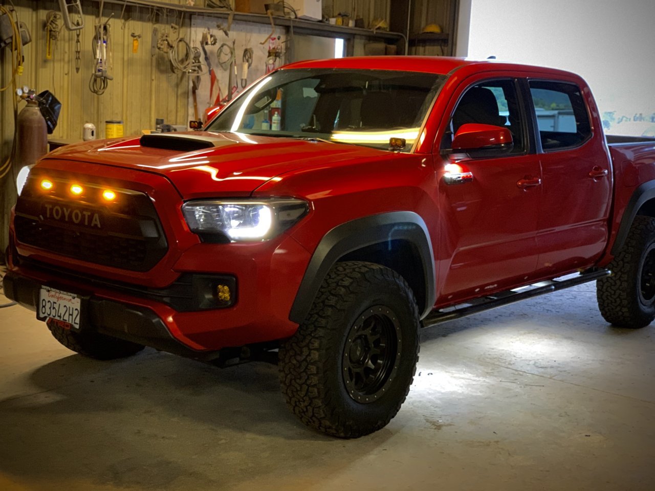

  12. Mar 29, 2020 at 12:12 AM
    #5472
    Red18Taco707
    May 29, 2018
    #254905
    1,123
    Richi
    Nor Cal
    Red 18 TRD POOR

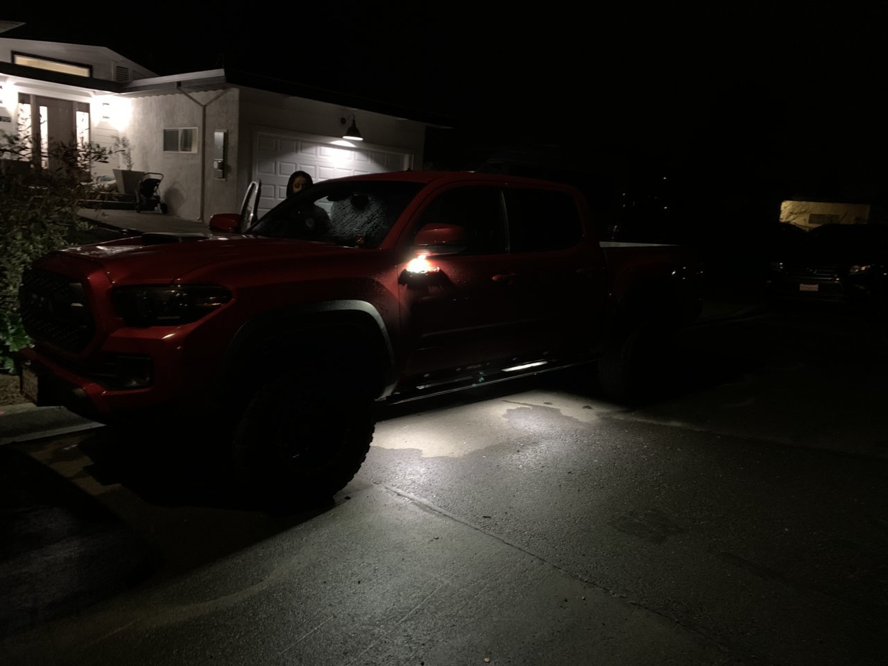

    Rock and puddle combo

  13. Mar 29, 2020 at 9:26 AM
    #5473
    skynyrd87
    skynyrd87 Well-Known Member
    Feb 3, 2019
    #281709
    565

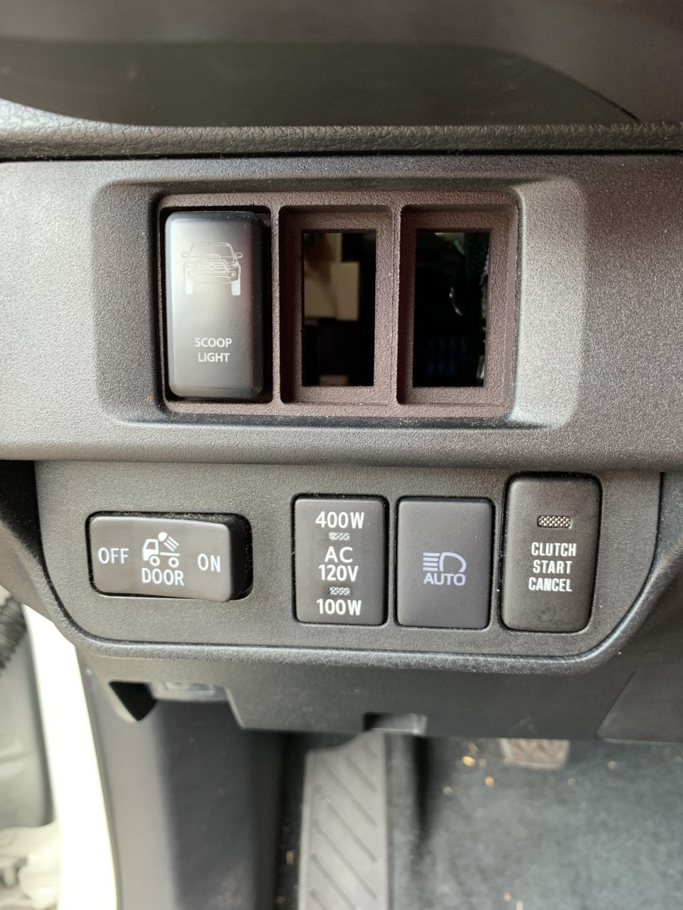

    2023 TRD Pro Solar Octane AT 2001 TRD OR White MT
    Which kind of scoop light do you have?
  14. Mar 29, 2020 at 10:03 AM
    #5474
    Tacospike
    Nov 19, 2018
    #273198
    14,418
    512
    Two Trucks
    might be the spartanxcustoms
    corgimas likes this.

    this is correct @skynyrd87

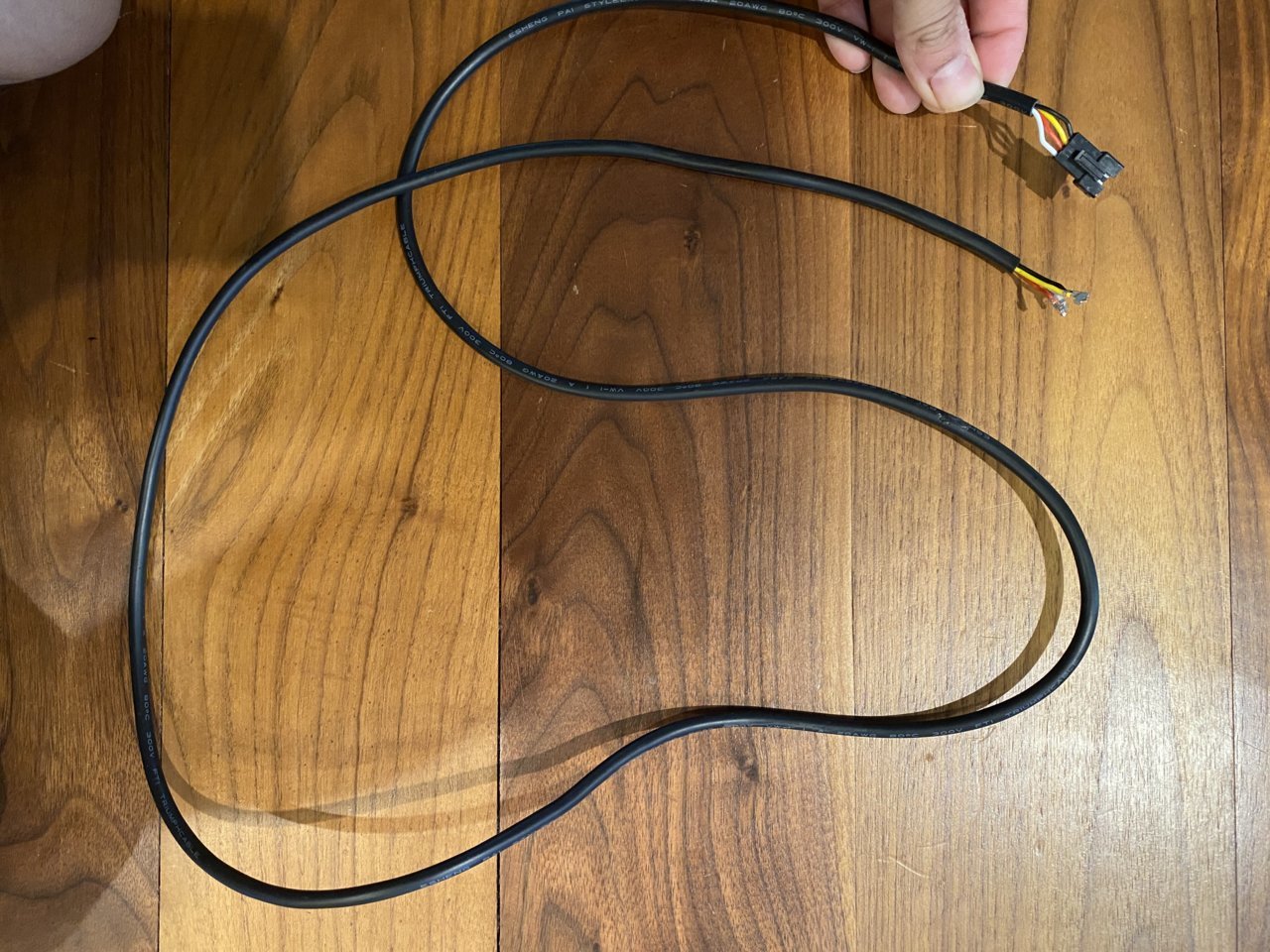

  17. Mar 29, 2020 at 4:03 PM
    #5477
    Guccitaco
    Guccitaco TRDPro 2020 Army Green
    Dec 17, 2019
    #313585
    195
    2020 AG trd pro
    little bit of here and a little bit of that...

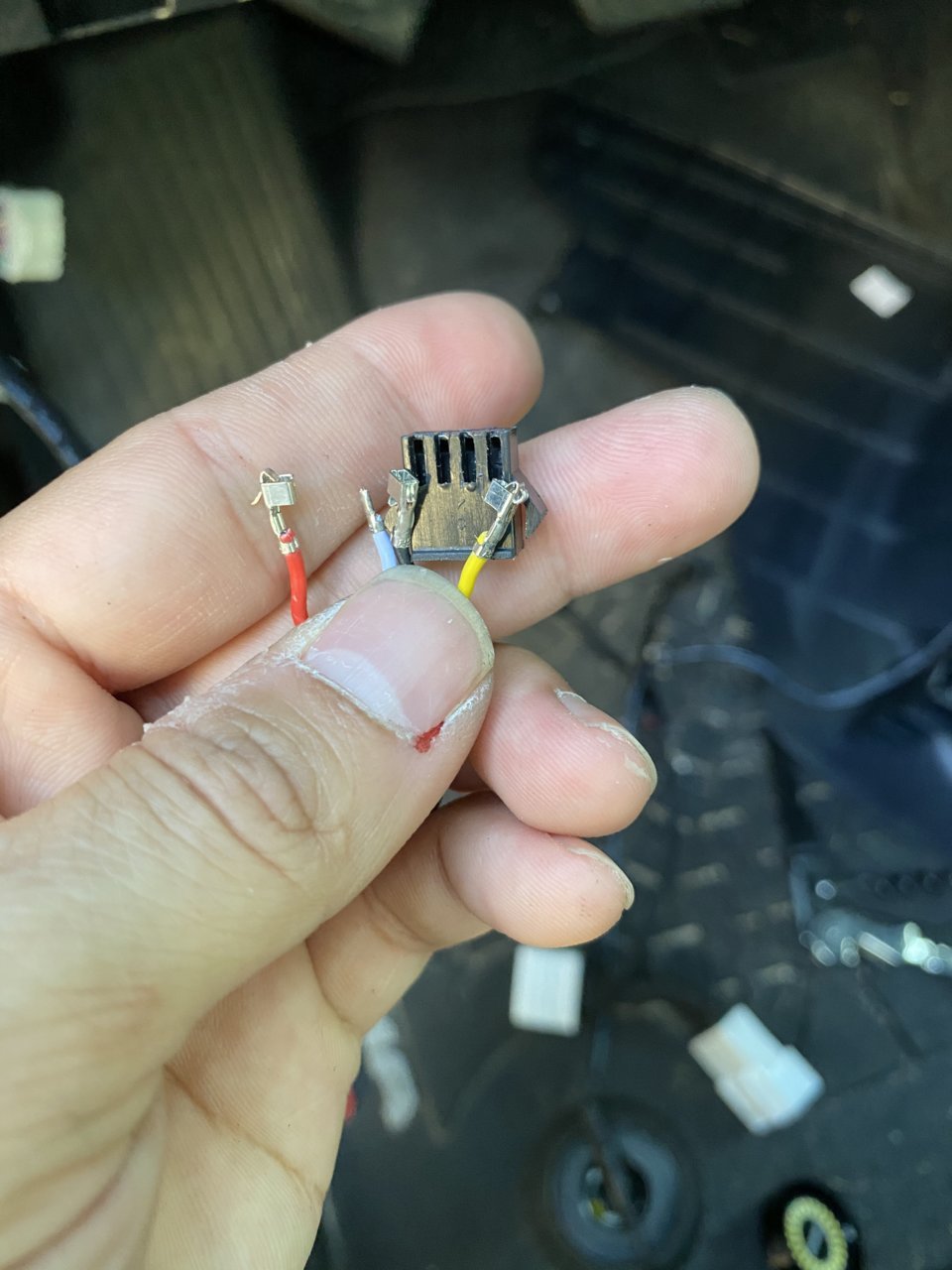

    so Due to the covid-19 I am off of work and had time to install these MESO puddles on my vehicle. And want to give people a heads up when installing these,
    so when I was trying to fish the wire harness from my door to cabin, I pulled the wire so hard trying to fit it in the rubber tubes that the connectors came off, took a while for me to fish it through, but the connector came off and broke. I felt like I had no choice but to forcefully pull it cause it’s such a tight fit. My recommendation it to somehow try to pull it grabbing the actual wire somehow, to fish it through. I’m bummed. I emailed MESO. Hopefully they will help me. So I can complete my installation.

  18. Mar 29, 2020 at 4:21 PM
    #5478
    waltuo
    Nov 19, 2012
    #91443
    1,511
    Toyotas
    You should read this thread. Maybe the last couple pages would be enough. My suggestion is to remove the boot completely. This allows you to keep the wires as straight as possible. There is also a video detailing the install. Patience is key as you found out the hard way. Good luck
