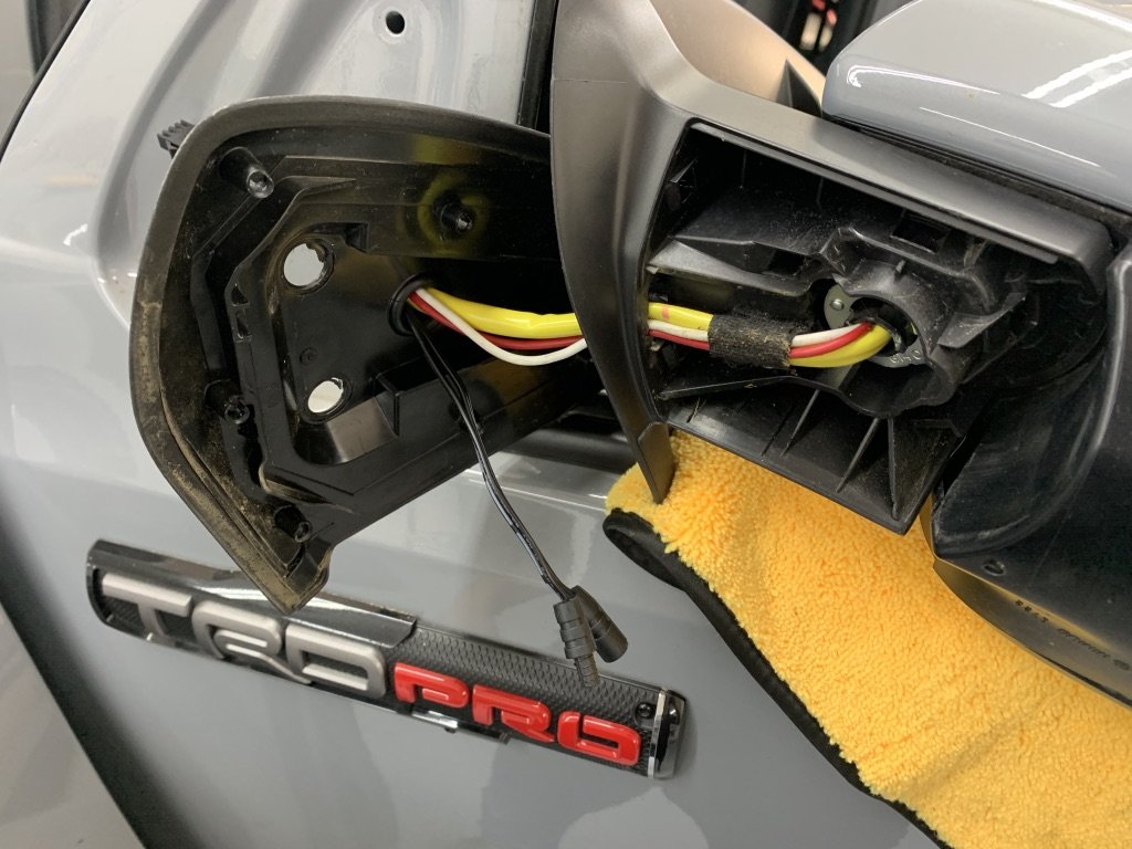

  13. Apr 8, 2020 at 1:25 PM

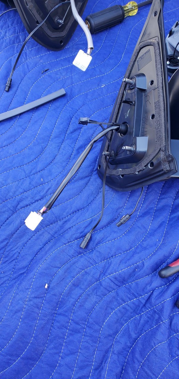

    Hey guys, quick question. This seems a little short. All the install guides are showing this being much longer. Did I miss something?

  15. Apr 8, 2020 at 1:28 PM

    pull more. There should be just enough left in the cavity plug the puddle light into.

    Gotcha. So both ends go in the mirror? What is the other for?

    Future products. Switchback mirror turn signal. Totally optional.
