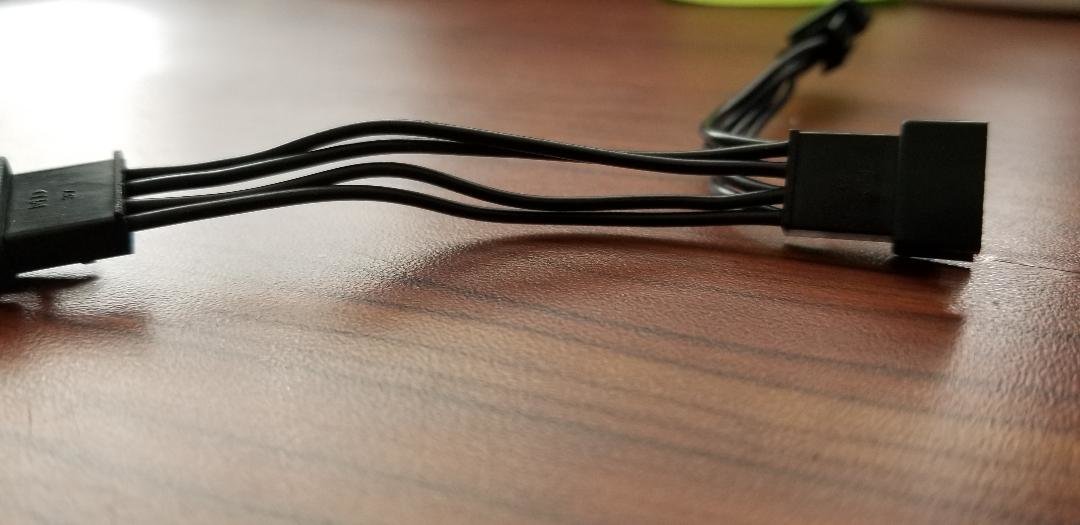

    So i plugged it back to stock all is works fine. Meso harness is bad some where and i am no electrician .

    Couple wires are crossed in the splitter. Waiting for meso to confirm. I dont know how to unpin themmesoT.jpg

    Think we narrowed it down to the splitter

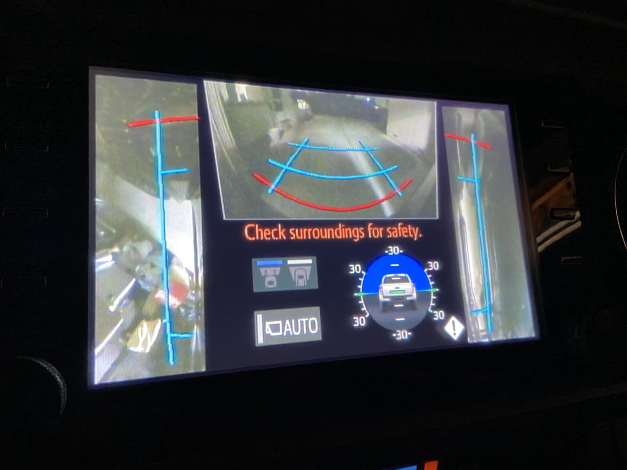

    Installed my puddle pods over the weekend. Install went well except I noticed all predictive guidelines disappeared from my camera views, and a small error icon on each different camera screen. Could not find anything in TW about this. Like a good citizen soldier, I checked the manual before posting, and I found that disconnecting the battery may disable this feature. Suggested fix is to Turn the wheel Full left, then Full right. Have not tried it yet but Im assuming this will restore the function, if that is not the case I will post back. Wanted to put this here since I did not see any mention of this anywhere else (except the manual).

    Update on error: So I had to go in to work today, parking garage there has super smooth concrete floor so I did the full dry turn of the wheel (several times) with no results, error still persists. Super bummed, driving home thinking about the apology letter I would have to post here and the groveling I would have to do to ask for help without getting flamed.
    Pulled up to my house this evening, backing into the garage, and what do you know, guidelines restored.
    So to the person searching this issue 10 years from now, just drive it for a while before freaking out, and you're welcome.

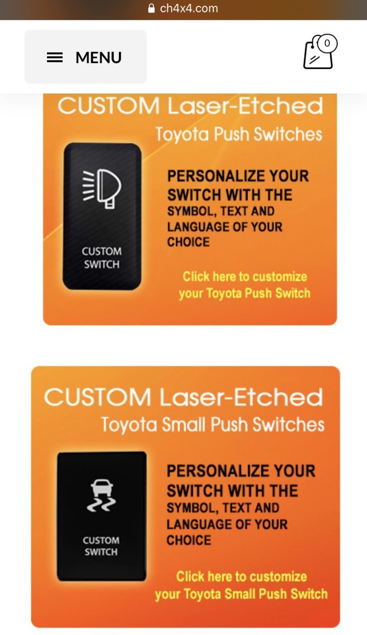

    Out of curiosity, does anyone know where to get other rocker switches that fit in the small size switch cutout like the one MESO sells for the puddle pods? I have only been able to find rockers that fit in the large toyota slots.

    maybe mictuning?

    As far as I can tell ch4x4 only has large size rockers. I'll check the other places out.

    They have them for sure:
