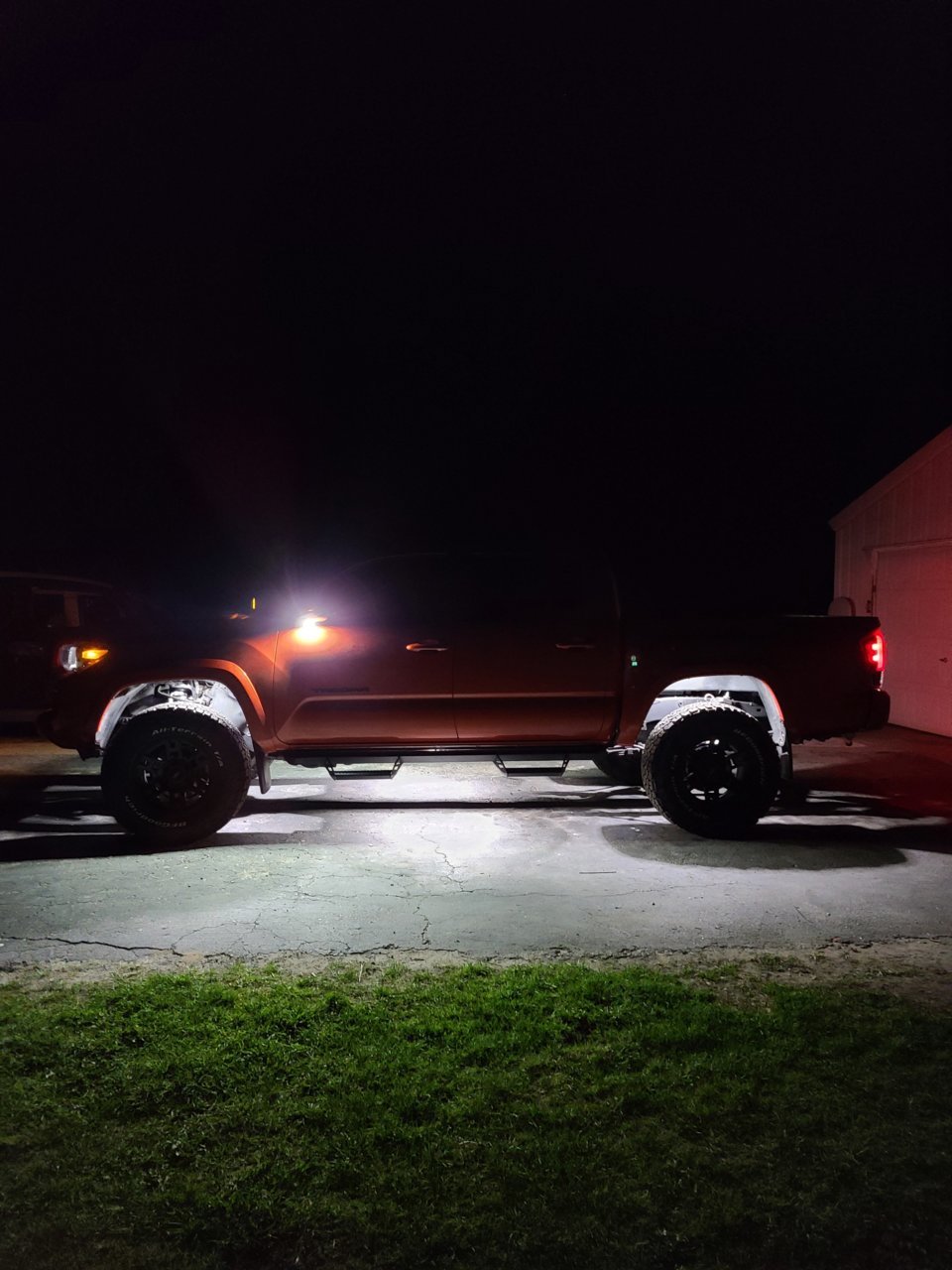

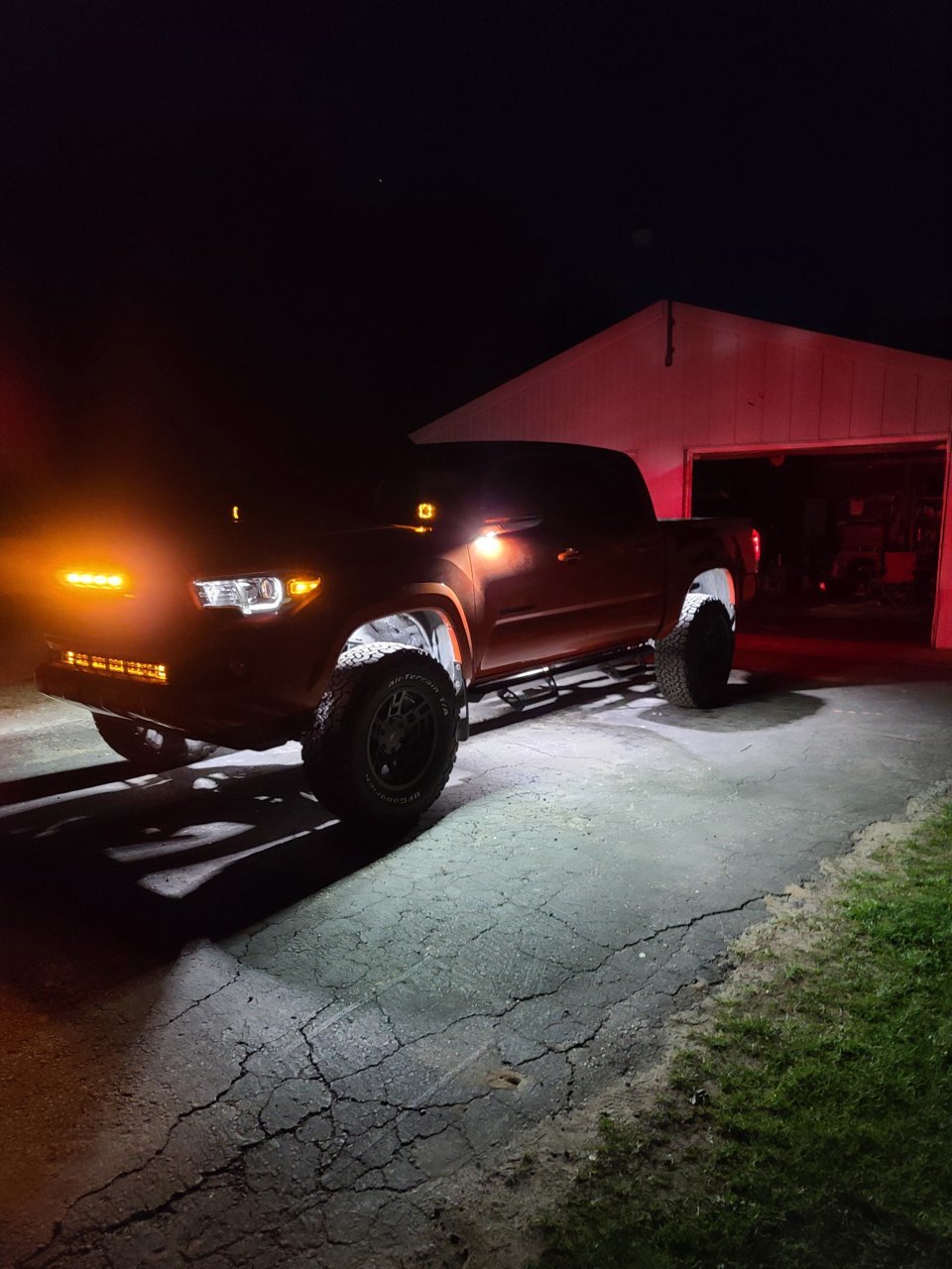

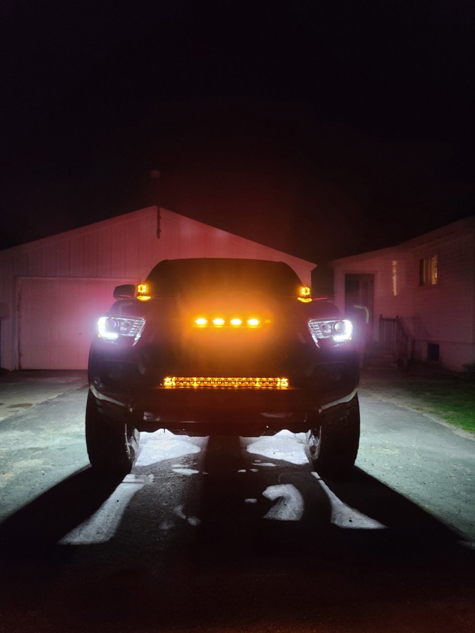

    Added some more lights to compliment mesos great work and figured I would share. I feel these go really well with his great work on the puddle lights:thumbsup:20200521_224440.jpg 20200521_224507.jpg 20200521_224450.jpg

    That's a mean looking TACO!
    Did you wire up your rock lights to the puddle pods... or did you use the DISM?

    Thank you much :fistbump:. They are wired into the cargo light switch so they come on with unlock,when the doors are opened and can be turned on manually by the cargo light switch. I now have all of my extra lights switches located in the left side panel where the cubby was. I will post a couple pics when I get home:thumbsup:

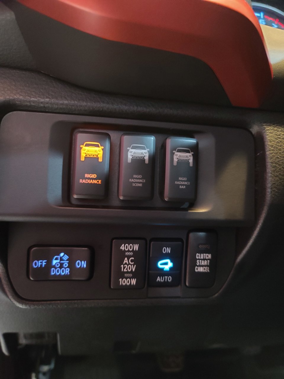

    @DSRamsey13 here is a pic of how all of my lights are controlled. Top switches are ch4x4 custom switches with amber backlight. I have all the switches running to relays to control all everything and keep the switches from burning out from to much Amp draw seeing as they are rated at only 3 amps I wanted to be safe and not sorry:D. First switch is rigid radiance backlighting for my ditch and bumper lights. Second switch is my ditch lights and the third switch closest to the steering wheel is for my bumper light. Below those from left to right is my cargo light switch for the bed lights and rocklights. Then my bed accessories power switch. Then our favorite modder meso puddle light switch:thumbsup:. Then I have my clutch start cancel switch. I moved my rear window switch to the center console using accessorides pre-made extension to avoid cutting or splicing and to keep the lights together all on the left. The raptor grill lights come on whenever the ignition is on so no extra switch needed for them to operate. In the pic I have the radiance switch on to show backlighting as I was waiting to fuse tap for them to be illuminated with my running lights until I got my meso custom extended fuse box cover which actually came in yesterday so I will get that finished and then it should be all set and well lit.20200523_172450.jpg

    That's a SWEET setup you have there. #goals

    I really appreciate that:fistbump:. I was going for the stock but better look and it wouldn't have turned out the way it did without alot of reading and research, the awesome members of this forum and mesos amazing mods.
