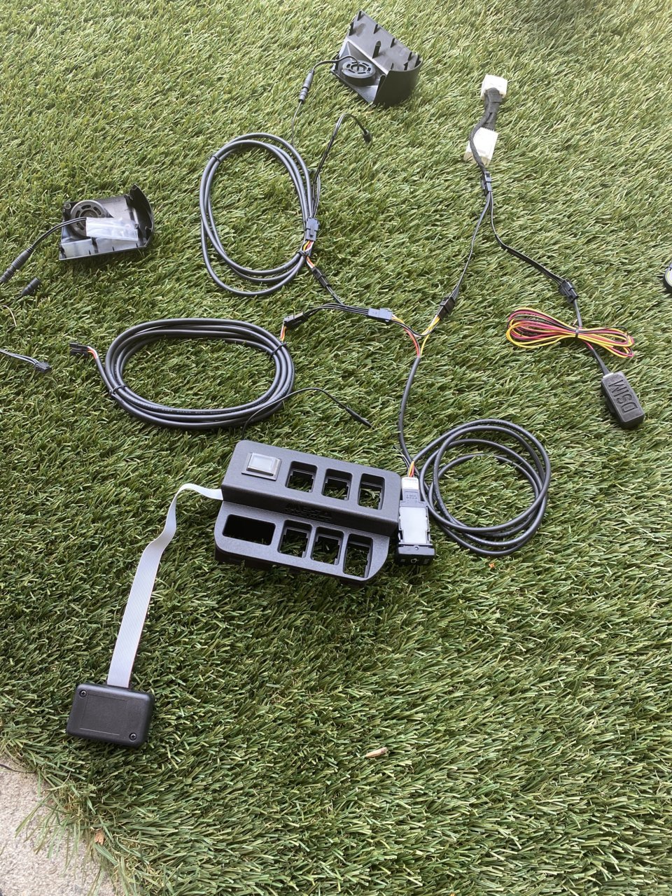

    Doing some home work about to jump in full force to my puddle lights (along with many other dashboard / door removal projects)
    has anyone done the puddles on a switch along side Dsim for rock light?
    does this look right?
    Any help is much appreciated

    Yup... I'm in the same boat. Don't have the rock lights yet, but plan to wire everything up at once (DSIM, Puddle Pods, both switches).

    I am using the @DSIM to power my scenePODs (Also made by @MESO) on my @upTOPoverland roof rack

    Yes, this is exactly how I will have mine set up.

    Do you want the Meso switch to control the rock lights as well? If no, then you are good. If yes, move the switch up to the first connector by the A-pillar harness.

    I was going to have a separate switch for the rock lights, but it's nice to know this is an option... THANKS!!!

    You won’t need the DSIM kit if you don’t exceed the amp draw of the dome circuit. I think that’s 7.5 amps (sorry, don’t know off the top of my head). You should also have 20% cushion for safety, so I wouldn’t go over 6 amps. If you do use the DSIM module, you’ll want to just have it activate an additional relay that can handle the rock light load. Also be aware that the lights controlled by the DSIM module will not have the fade on and off effect of puddle pods. So it’s going to come down to how many amps your rock lights draw. I am in the planning phase on mine still, but plan on using the DSIM module and am just adding lights underneath to come on and off with the puddle pods. I love the Meso puddle lights, but want more light that illuminates the ground outside the door when the door is open. I also plan on using a separate dimmer controller to have the lights dim on and off. Hope this helps

    Awesome info. Trying to figure out where i'm gonna fit another small switch. might have to go overhead. Is the small meso switch a rocker style switch? if i use the Meso switch and the dsim will the single switch still be able to control both the puddle lights and the rock lights? which style dimmer are you gonna go with. also, about what color temp are these puddle lights to try and match them up to a set of rock lights?
    This is basically what I want to achieve. Meso switch controlling puddle and rock lights with dsim. so by moving the switch up in front of the dsim i can still have rock lights comming off the dsim on a relay but controlled with the meso switch?
