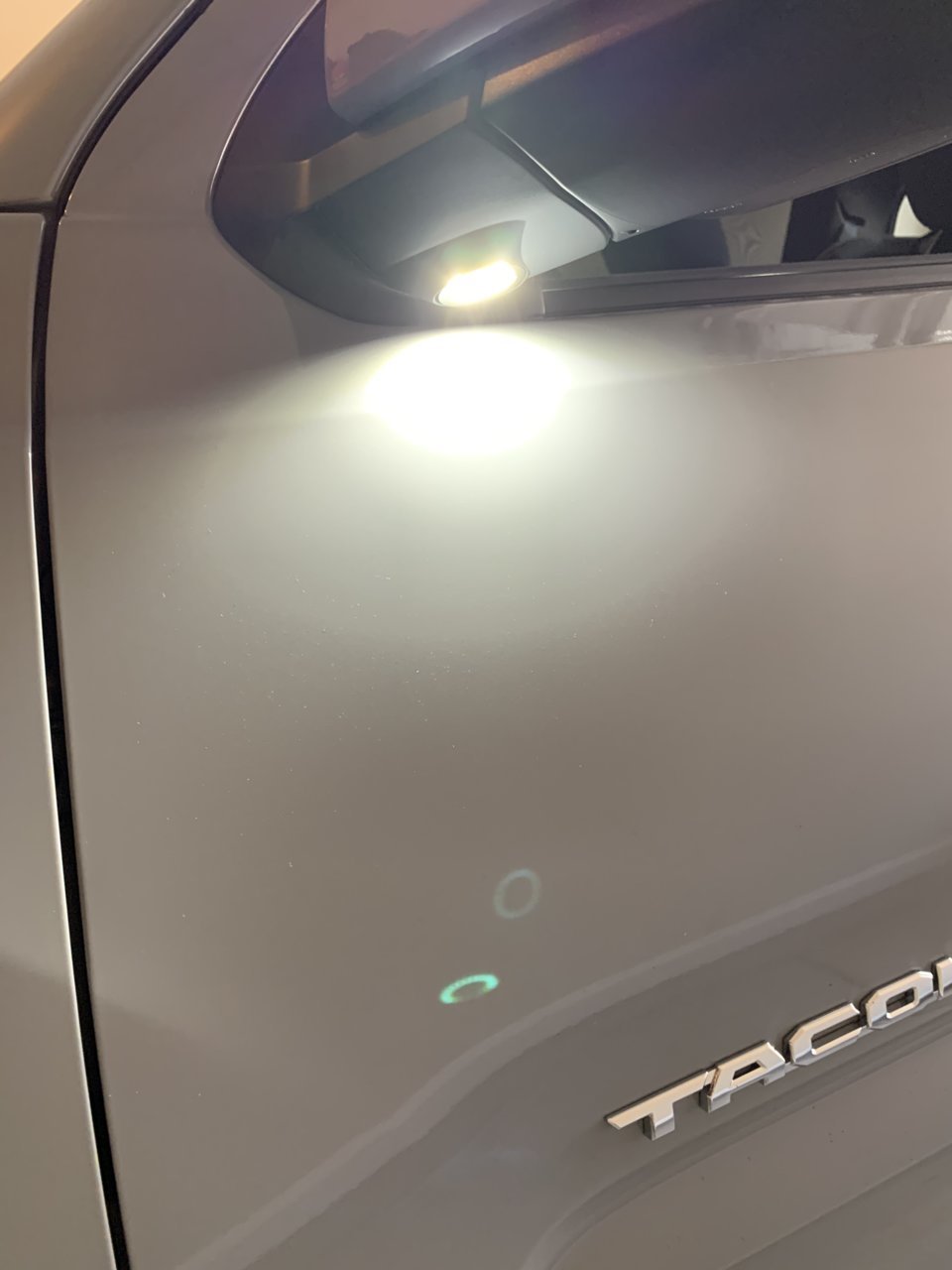

    Installed mine today. 90º weather kinda sucked. Other than that it's an easy install. Took about an hour and a half.
