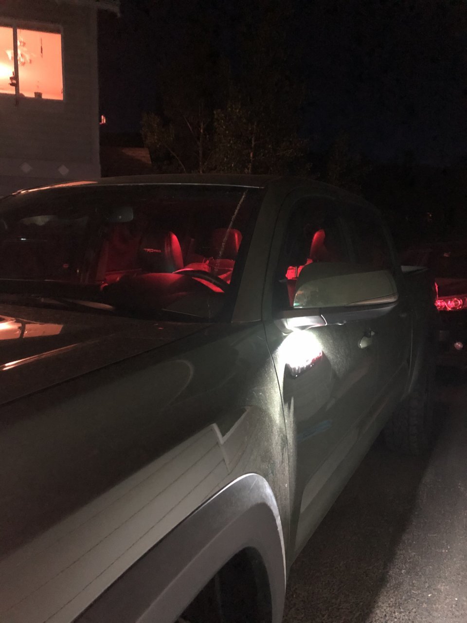

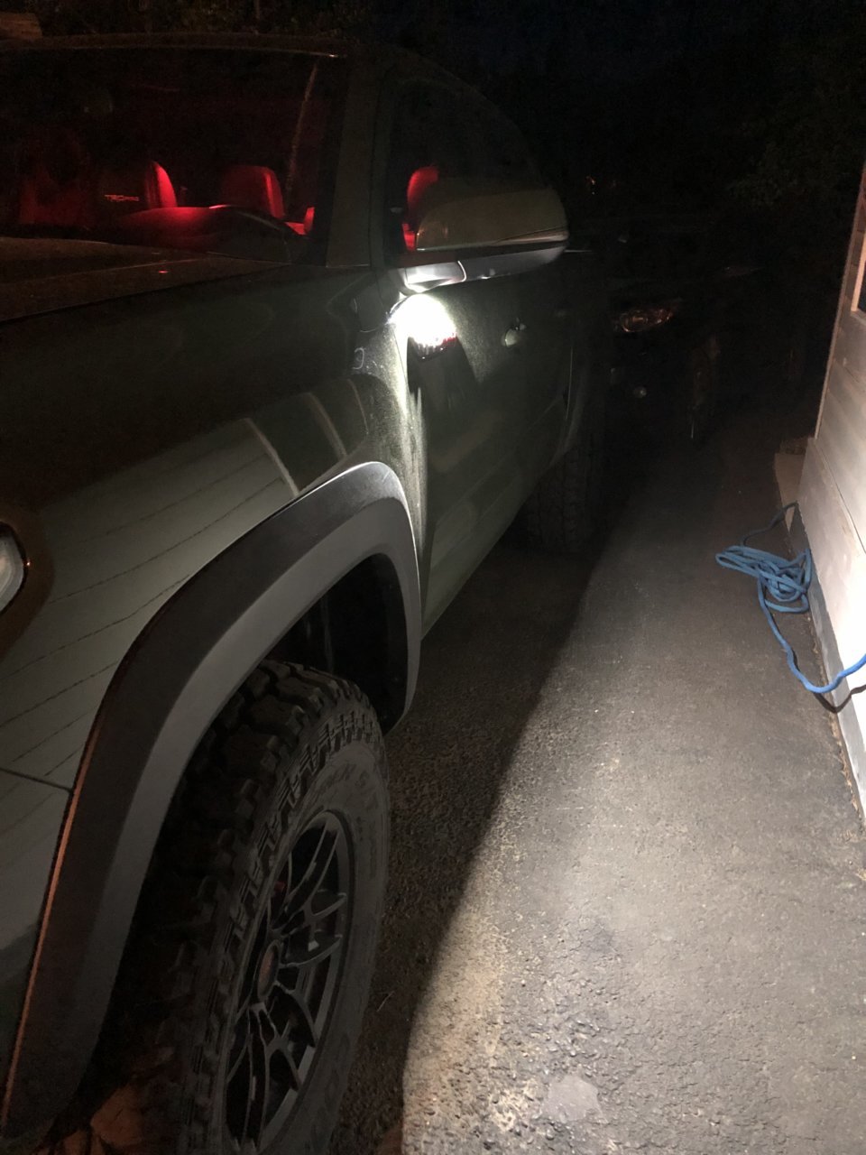

    Puddles pods installed! That was sort of a bitch:p not super difficult but time consuming. I guess I took my time, took almost 4 hours:confused: pulling cable through the boot was a PIA! They work great. Super bright:D now I need one of MESO’s custom left side panels to install the switch. The PRO only has one empty switch and it’s not the same size as the puddle switch:( all together an awesome product! Keep em coming! @MESO

    Have you tried disconnecting at the A-Pillar and putting the wiring back to factory? See if that fixes the issue.
    And I know it's a little too late for your situation, but... for all the people about to install this. I recommend hooking everything up before installing... makes it easy to troubleshoot to make sure all your wiring is correct. (i.e. Connect at the A-Pillar and hook up all the wires and test it out.) If it works that way, then you'll have high confidence it should work once you get everything buttoned up.
  17. Jun 26, 2020 at 3:04 PM
    #5797
    TacomaGuy7878
    TacomaGuy7878 Mmmm....Tacos
    Nov 21, 2019
    #311371
    848
    CO Mountains
    2020 AG Pro
    I actually did do this and everything seemed fine. But I didn’t go for a drive afterwards, they worked so I installed.:confused:
    I’ll try and reconnect to stock at a-pillar and see it fixes anything

    Sorry for the scare. Didn’t work when I reconnected at A pillar because I’m a dumbass I supposeo_O I opened the fuse box back up and I guess I forgot to put a fuse back when I was checking them which pisses me off cuz I typically don’t misplace things and am anal with shit like that. Guess I’m slipping:p everything works fine and dandy now:D thanks for the troubleshooting ideas:cool: and I swear I put it together first! Lol. My lighting game is on point now!
    -Stage 2 taillights
    -Puddle pods
    -Sequential mirror signals
    -MESO red map & dome lights
    -Fire flyes vanity lights & license plate lights
    And the 2020 led headlights/sequential turn signals and cargo light:thumbsup:
