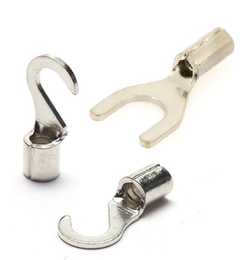

    I cut mine in half. They sell connections that are “u” shaped so I don’t see a problem with it.

    these are typically called "spade" or "fork" connectors if you're googling

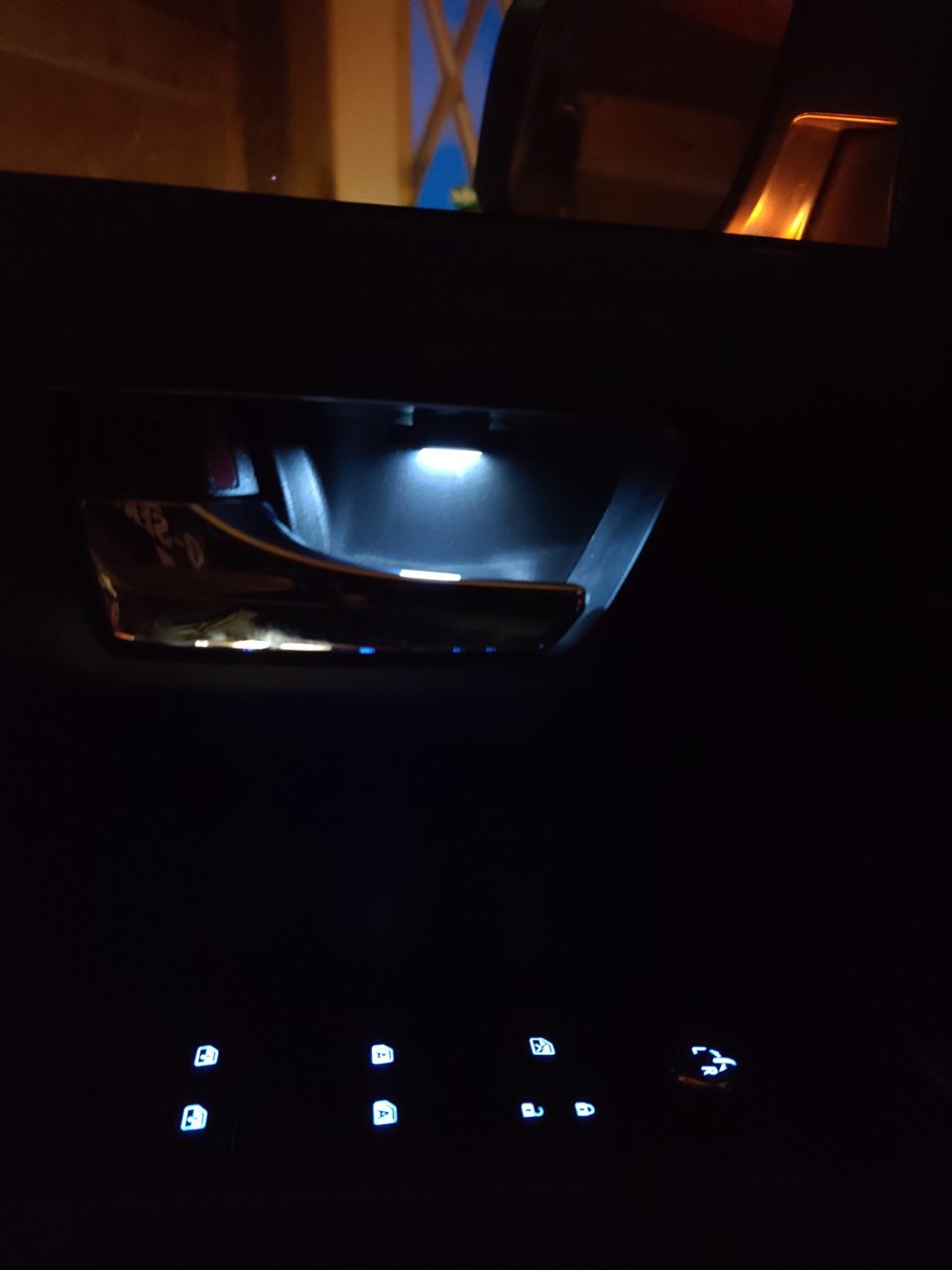

    If you mean the door bowl lighting with puddle pods then yes, they work great together:D. I have them both installed and love it. Nice bright entry lights and a nice accent for the handle on the inside. 20200517_215913.jpg 20200713_221155.jpg

    Hey, those door bow lights looks pretty sweet, have a link or any threads on this? I’ve been away for a while. I have a lot of catching up to do in the mod world lol. I finally just got to knocking out like 4 things I had sitting around the garage this past weekend. Thanks
