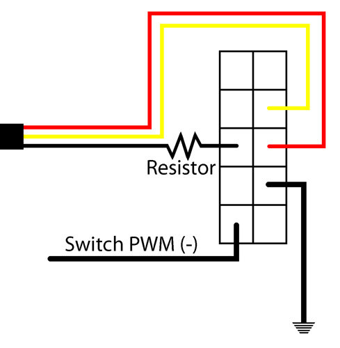

    I was just thinking, an ambient light sensor could be slick here for auto mode.
    Any chance someone has the pins for the switch? I’m thinking of using dimmed ground since I already have that tapped in the DSIM T harness thanks to @Puppypunter and his crimping skills. I’ll do some reading in case it’s already been posted in this thread.
  15. Dec 7, 2020 at 8:50 PM
    #5995
    daveeasa
    daveeasa FBC Harness Solutions
    May 14, 2020
    #328079
    7,483
    David
    PNW
    2016 Tacoma OR DCSB 6MT, 2005 RC 5MT PreRunner, 2002 Tundra SR5 RCLB 4x4
    As a follow-up to this excellent plan, I'm mid-flight on a minor variant of this mod thanks to @Puppypunter and his guidance.
    I'm leaving the main harness as-is, no need to mess with it.
    I'm swapping the illumination PWM - ground to a new lead which is much longer, soldered to a resistor, which is then soldered to a jst feeding into my 2 pin system of switch illumination fed from a modification to the DSIM T tap.
    The second ground simply gets extended longer so that I can bundle it with the main harness and use braided sheathing so it's one coherent whole. I'm waiting on 20 gauge ring terminals as I never expected I'd need any that small.
