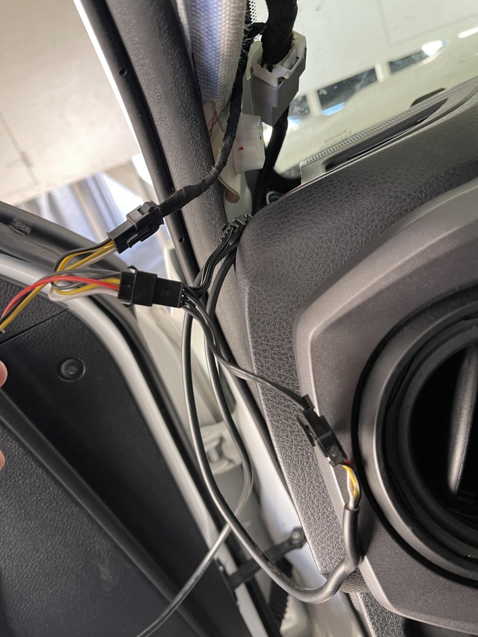

    was this covered already? the lights turn back on after a while. not 100% brightness but 25%?ish. i locked my truck and passed by the truck (without my keys) and noticed they were on but dim. got my keys, they lit up 100%, locked my truck and they were off. went back 10 minutes later and they were dimly on again, both sides.
    i have the gen 2 plus switch kit. i got some dsims (originals) also tapping into the same wires in a-pillar. anyone have an idea what I'm doing/did wrong?

    Somehow there's juice getting to the LED from somewhere. Switch or connector. And/or a bad door courtesy switch or an unlock detection switch in one of the 5 locations.
  7. Jan 12, 2021 at 10:52 PM
    #6067
    hirod
    hirod Well-Known Member
    Jun 3, 2013
    #105540
    1,245
    hawaii
    16 double cab short bed OR
    damn.
  8. Jan 12, 2021 at 10:59 PM
    #6068
    caribe makaira
    caribe makaira Well-Known Member
    Feb 13, 2011
    #51121
    11,816
    Caribbean, Puerto Rico
    05 PreRunner TRD Offroad AutoTrans
    Hood Struts, My version Fogs always ON, Map & Overhead Light Mod,
    Well if the Alarm hasn't given you trouble, then the courtesy switches and unlock switches should be fine, that leaves the added MESO switch and its connector. Are the DSIM modules for the Puddles?
  9. Jan 12, 2021 at 11:02 PM
    #6069
    hirod
    Jun 3, 2013
    #105540
    1,245
    hawaii
    no. for rock light project that's not installed yet. I'll disconnect that and see if condition is still present.
  10. Jan 12, 2021 at 11:09 PM
    #6070
    caribe makaira
    Feb 13, 2011
    #51121
    11,816
    Since the puddles are such low amps my guesstimate is the switch. What's the longest time you've allowed the puddles to stay "on"(25%)? Or have you just cycled the lock/unlock only?
  11. Jan 12, 2021 at 11:23 PM
    #6071
    hirod
    Jun 3, 2013
    #105540
    1,245
    hawaii
    no idea what the longest I've left them like that. ive never noticed them on like that until tonight. disconnected the ground from the switch and so far they're staying off. I'll check the switch and ground tomorrow.

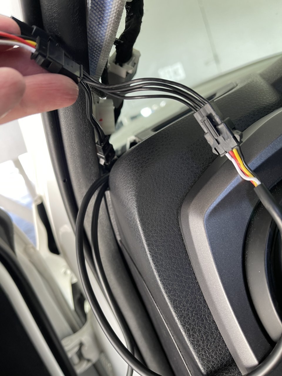

    I've had some sitting around for a while and not sure if they're V1 or V2 - what's the easiest way to tell, and what's the difference between the two models?
  13. Jan 21, 2021 at 12:14 PM
    #6073
    Tacospike
    Nov 19, 2018
    #273198
    14,419
    512
    Two Trucks
    Does it have these connectors?

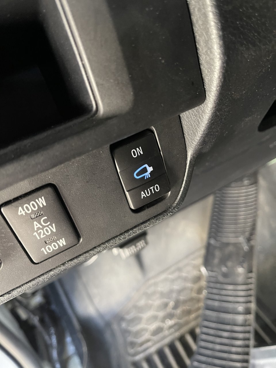

    Im having issues with the Puddle light switch. The instructions included suck. The switch lights up but only works on Auto. They do not turn on manually with the On switch.
  15. Jan 25, 2021 at 3:16 PM
    #6075
    daveeasa
    daveeasa FBC Harness Solutions
    May 14, 2020
    #328079
    7,483
    David
    PNW
    2016 Tacoma OR DCSB 6MT, 2005 RC 5MT PreRunner, 2002 Tundra SR5 RCLB 4x4
    ^^ Did you ground the loop terminal from the switch harness to a good chassis ground?
    Tacospike likes this.
  16. Jan 25, 2021 at 3:17 PM
    #6076
    Stretch2323
    Stretch2323 Well-Known Member
    Jan 13, 2018
    #241091
    453
    2016 OR
    Yes the puddle lights only come on auto
  17. Jan 25, 2021 at 3:22 PM
    #6077
    poroto
    poroto Well-Known Member
    Jan 14, 2020
    #316092
    158
    Puerto Rico
    that switch look strange " they are correctly seated in the panel ? "
  18. Jan 25, 2021 at 3:23 PM
    #6078
    Stretch2323
    Jan 13, 2018
    #241091
    453
    2016 OR
    Eh it doesn’t go there. It goes on the overhead.
  19. Jan 25, 2021 at 3:32 PM
    #6079
    Stretch2323
    Jan 13, 2018
    #241091
    453
    2016 OR
    Nvm i figured it out. Wish the instructions were better
