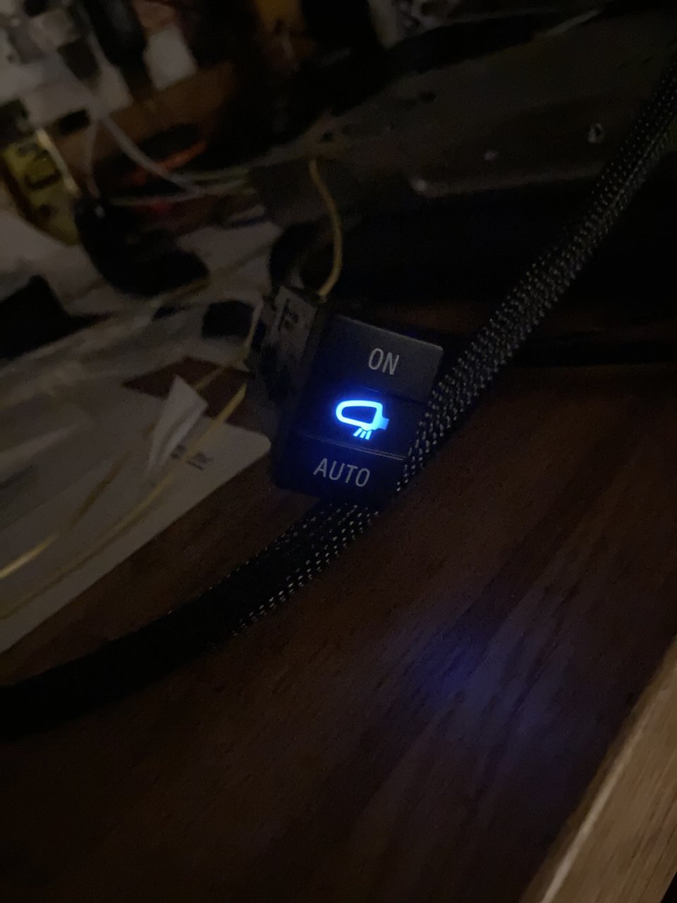

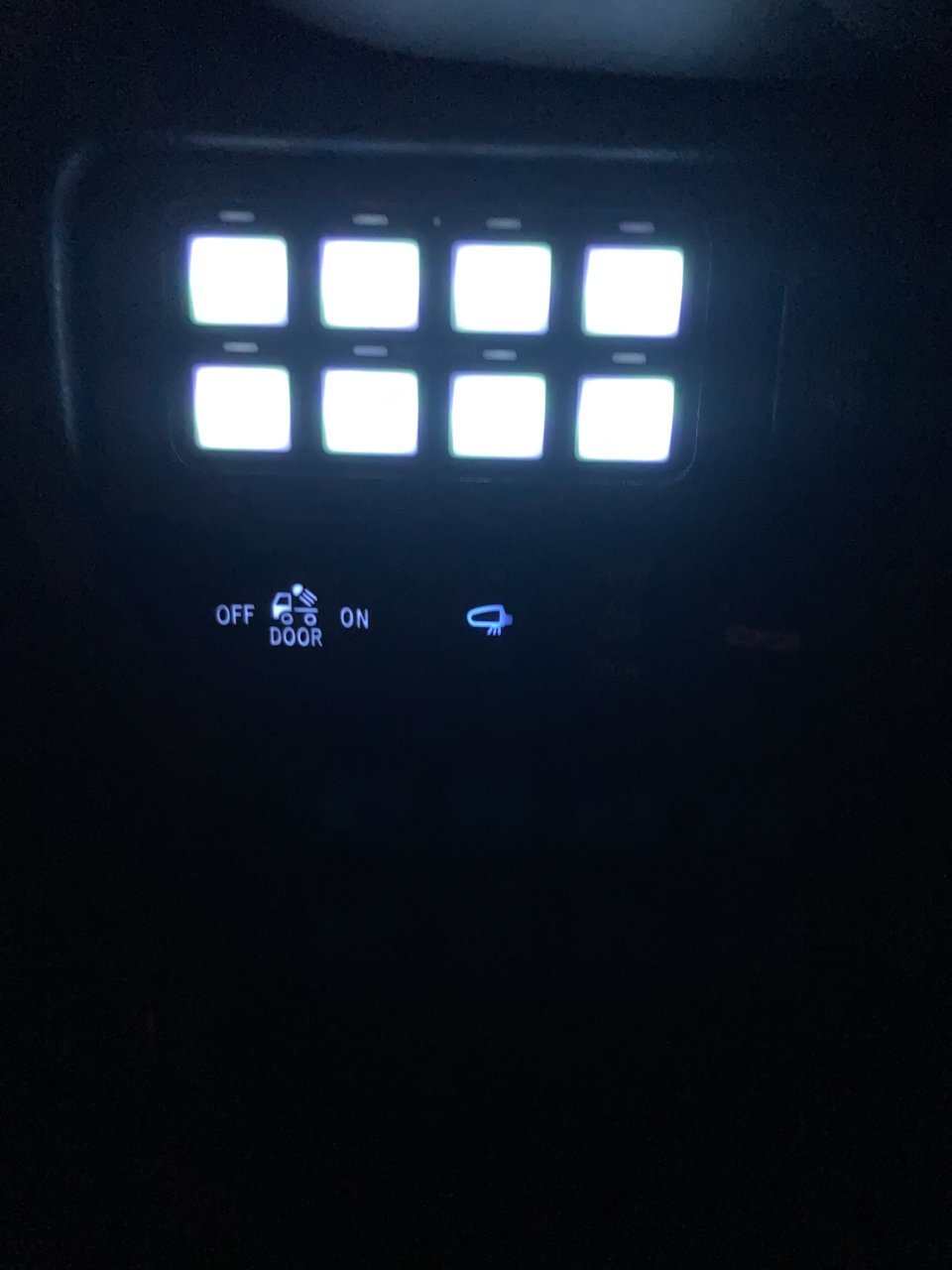

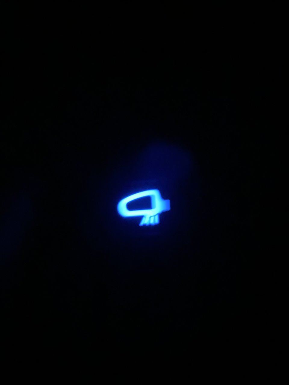

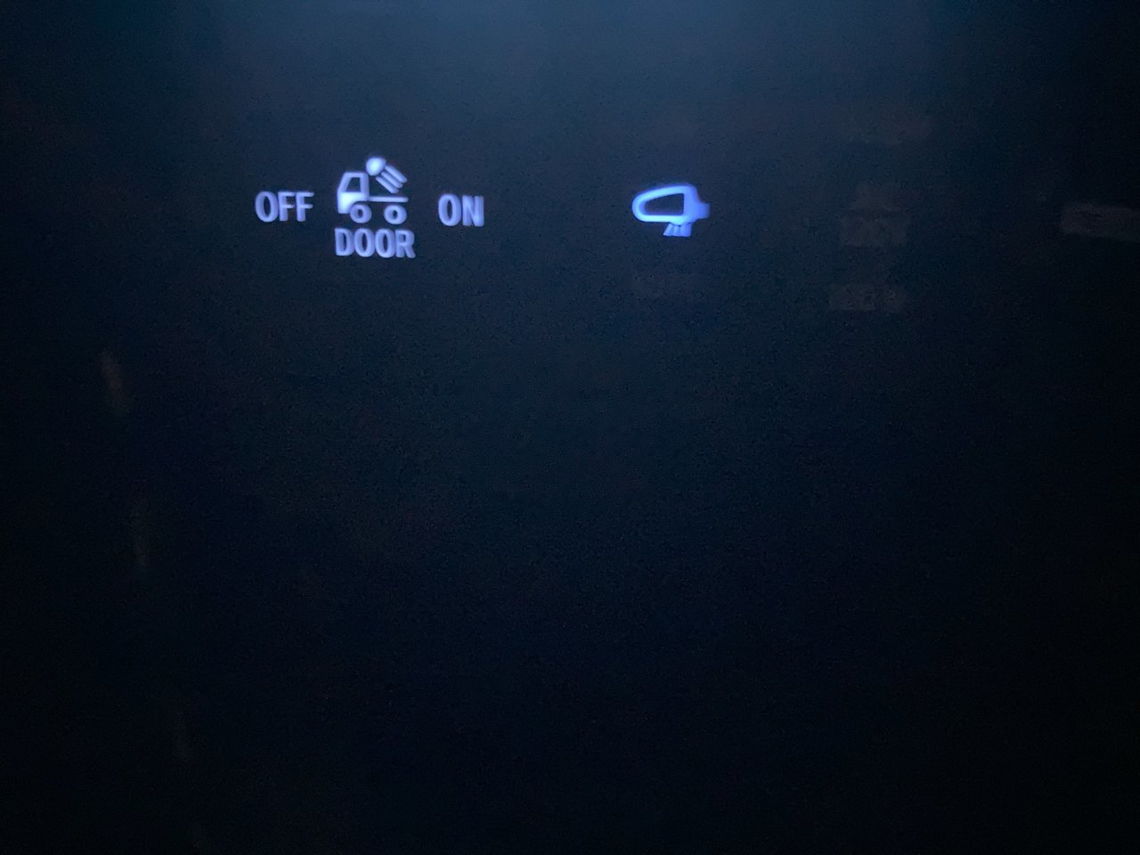

    Both I suppose. Reducing the intensity is number 1, would be even better to match the colour if possible. I might try what you linked cause dimming with factory switches would be nice. Quick question, what size resistor are you using and what is "PWM"?
  17. Feb 7, 2021 at 8:53 PM
    #6097
    daveeasa
    daveeasa FBC Harness Solutions
    May 14, 2020
    #328079
    7,482
    David
    PNW
    2016 Tacoma OR DCSB 6MT, 2005 RC 5MT PreRunner, 2002 Tundra SR5 RCLB 4x4
    I am using a 2.7k ohm resistor. PWM is an acronym for pulse width modulation which, unless I am mistaken, is a means to adjust the power delivered by a circuit without changing current or voltage. The idea of PWM is a cycle of on/off where the ratio of on to off is changed. It’s one way to dim a non dimmable element such as an LED or a seat heater pad when you can’t drop voltage or current. In other words, the PWM supplies a series of pulses of variable width effectively allowing adjustment to the power delivered.
    Below are my before and after images, I can try to get a shot of it in my driver cubby if you like but I think my Switch-Pros overpowers things too much to have that be terribly helpful.
    ETA: more photos.
    Credit: @Puppypunter for the design
    0705A8FB-DD9B-42C4-BBDB-044852E1A8B8.jpg E230F816-5588-4168-99BA-38122B2D39D2.jpg
    3B55D7D8-B54A-421F-99E7-2623B7DAFFE3.jpg A8C495E3-6209-43E7-8A4E-8254A3434A4B.jpg

    Gotcha. So the am I correct in saying the factory switches use PWM to change their backlighting intensity so if I remove the ground that is currently used for the puddle light switch light and tie into a factory switch light ground I will get a dimmable light?
  19. Feb 8, 2021 at 11:17 AM
    #6099
    caribe makaira
    caribe makaira Well-Known Member
    Feb 13, 2011
    #51121
    11,809
    Caribbean, Puerto Rico
    05 PreRunner TRD Offroad AutoTrans
    Hood Struts, My version Fogs always ON, Map & Overhead Light Mod,
    One ground on the switch connector is the dimmable ground.
  20. Feb 8, 2021 at 11:24 AM
    #6100
    daveeasa
    May 14, 2020
    #328079
    7,482
    David
    PNW
    Yes, this is what @Puppypunter did (and I copied). His excellent post describing which pin to use is the one I quoted, but I took the easy way out as I placed the resistor on the ground lead rather than power lead (doesn't matter which side you put it on and I was re-doing my 2 grounds anyway so I figured why mess with a perfectly good 4 pin connection.)
    TRDCal[QUOTED] likes this.
