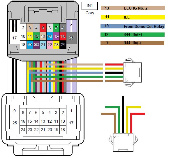

    Evo A SmartCap, Cali Raised Sliders (0 degree), 2WD low Mod, Puddle Pods, 3 switch overhead panel, 8 slot middle console panel, Custom driver's switch panel, Rek Gens, 265 75 16 Falkens, lil B Bed Stiffeners, All new Speakers, Diff Breather, AC Drain, Many interior bits...
    Do the pods work on mirrors that have the cameras?
    - I imagine that the pod's plug an play capability take advantage of the stame space where the cameras sit in the mirror...
    Can someone confirm?
    Thanks!

    According to #5985, they work.
    OZ TRD[QUOTED] likes this.

    Ah - It is a different location! - Excellent... Thanks for pointing me to that post.

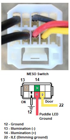

    Unless the there's a mod3 of the harness. Meso should clear that.
    Edit. It does not have the dimmable ground.:annoyed:
    But could...:burp:
    It would not illuminate without the dash lights ON.
    Then again it only has one led. If it had 2 then, it could.

    Thinking of just tapping into an illumination ground nearby.

    Maybe @DSIM or @MESO could assemble a Ver 3.0 of IN1 :boink:

    Nope, just no one had it or asked for it.:rofl:So many iterations already drawn, not many DIY'rs.
    Put it up for sale...o_O:D

    So sorry if this has been asked already - I've been pouring through threads trying to find an answer - but I'm trying to confirm if these will work with/affect the performance of the 360 degree camera system. I have a 2020 TRD Pro, for reference.

    MESO Puddle Light build

    Thank you so much. I had the same incorrect assumption that these lights were a ring around the camera; I should have gone outside and looked myself! Thanks again.

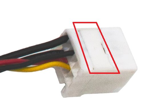

    One of the wires on the switch connector is not seated any longer. Is there an easy way to remedy this or am I SOL?

    Post a pic of it...maybe the terminal wasn't seated correctly and could still be secured by the retaining lock.

    Looks like the wire came out of the terminal. I can re-crimp for you don’t have pins and a crimper. Or you can buy JST pins and a crimper and we can talk you through it.

    This is what I’m looking at...

    What would be the process for you to recrimp?
    can you also provide links to what you would recommend for me to do this myself? Thanks!

    To remove the existing terminal you need a very small flat blade or de-pinning keys. There is a locking tab which needs to be pushed in to slide it out. It’s harder to do without the wire attached.
