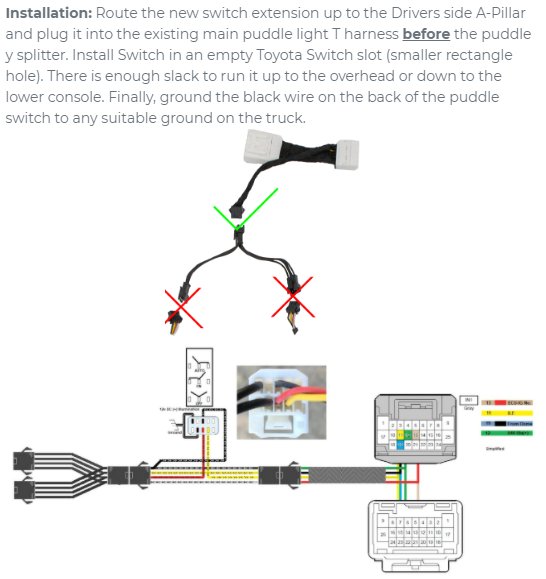

    Not sure if I’m missing something or just overthinking but when installing the switch how does the wire diagram look when connecting to the a pillar wiring?

    A-Pillar harness connection is at the bottom and switch at top left. I also have a DomeRock at the bottom left.

    Ok, so without the dome rock I would leave that plug alone and just plug in one clip?

    Got my puddle lights working, they were gravy as soon as I connected the negative cable to the battery. I did it over three days lol. First day was tear down and install of the LEDs into the mirror, second day was running wires through the rubber boot at each door, third day was A-pillar and hookup. About three hours total, I work slow..
    Aside from the gap issue in the driver-side cover, I am highly impressed. Another Meso success. :thumbsup:
