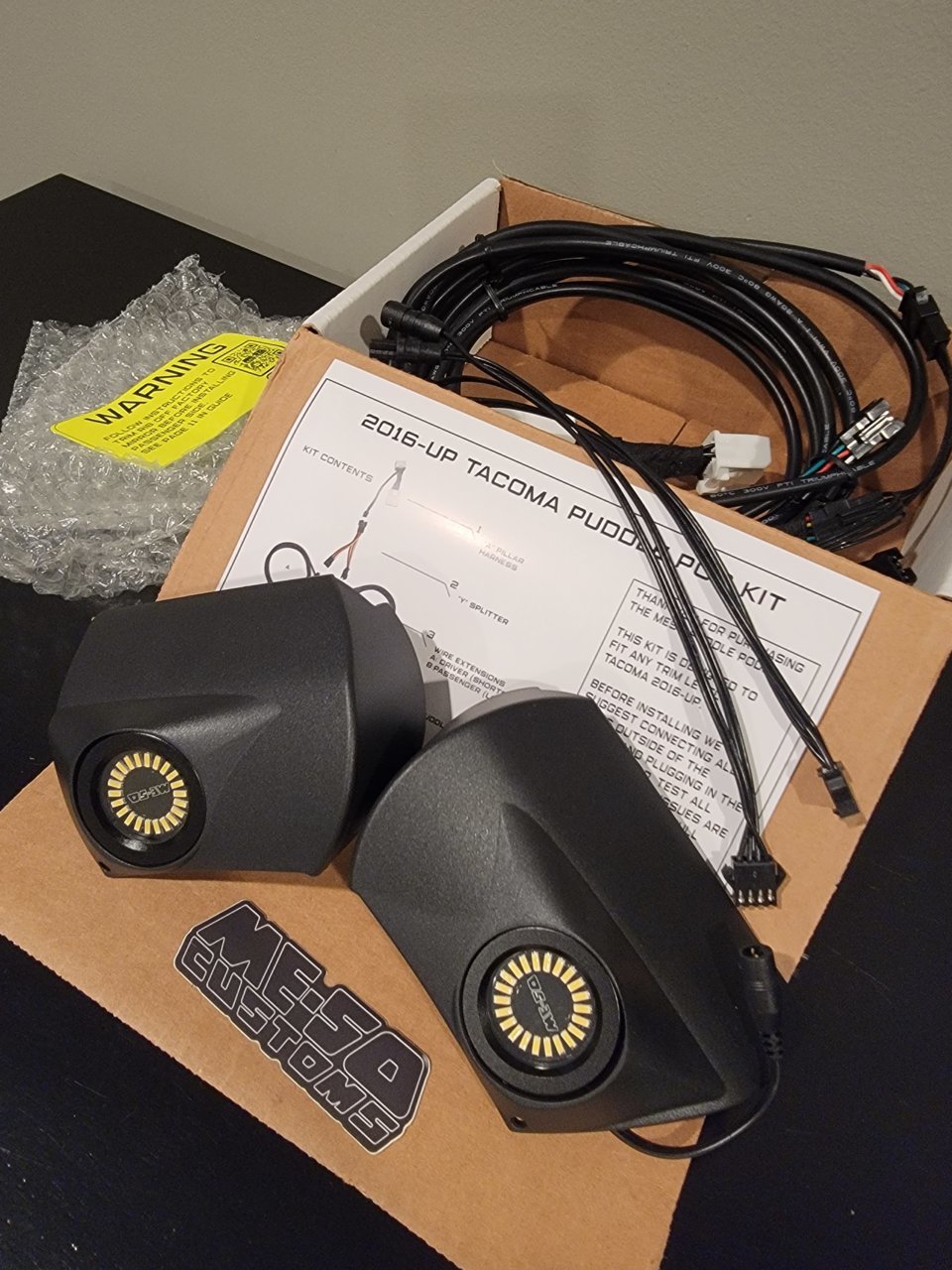

    Mine arrived a day earlier than expected, quite excited. Now I’ll probably skip dinner and install them this evening.

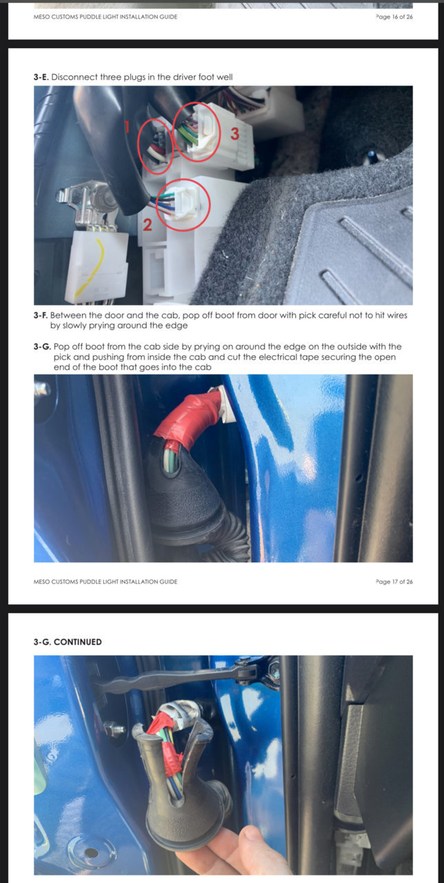

    In case anyone questions it I (as a random person on the internet and not qualified to offer advice) definitely recommend disconnecting the battery and when you get to the door pass through grommets, unhook the connectors that pass through to the cab so you can pull that section out in between and easily fish the wire through. Messing with the tape in the little recess is a pita… these steps.. when I installed the v5 mirror turns I tried to just take the tape off and it took more time than it would have this way.

    Thanks for calling this out. I wondered if this would be really needed while reviewing the install steps and you confirmed it.

    I had tried and tried unwrapping the tape and then using a big heavy duty zip tie and had no luck. Some may have but you still gotta take that tape off, and that’s no fun lol.
