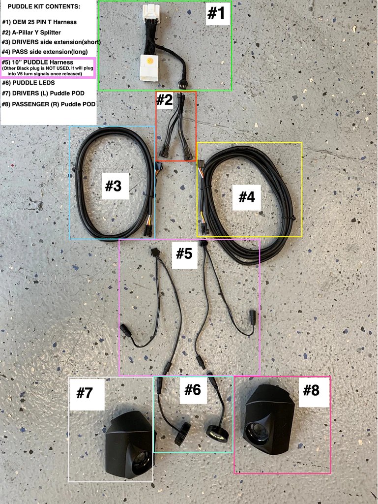

    So if we have the footwell lights already we would just have to connect it with the splitter? Also the v5s I have currently wired to the harness in the door, I could just plug that into the puddle pod harness instead? I researched before but that was awhile. Thanks!

    The connectors on the 1st pic, the wiring harness connectors.

    So will use 2 splitters then? One for the footwell lights and the other for meso pods. I guess i can undo the wire tap from the doors since I can plug the v5s in the pods now.

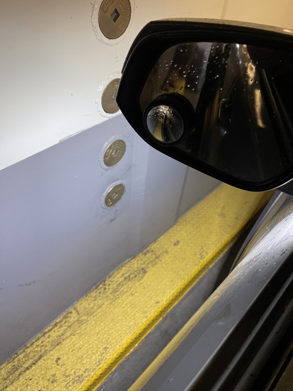

    Got mine in today. Too me a long time, like 5 to 6 hours I think. Most of the time was those damn boots. A couple quick pics on the ferry for now. Not quite dark enough for a glory shot yet. Glad I snagged them when I got the email, but not sure I’d like to go through that again.
