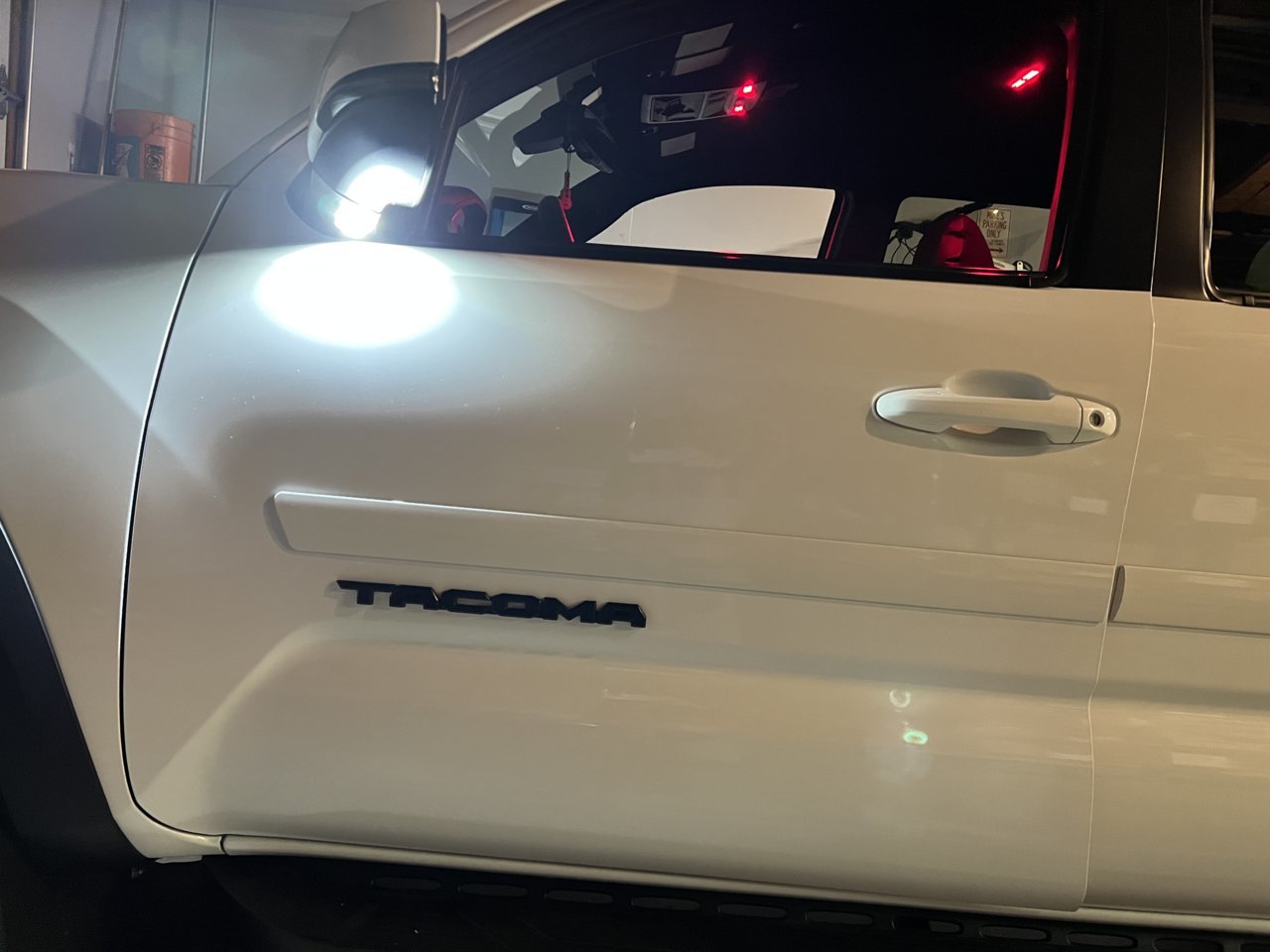

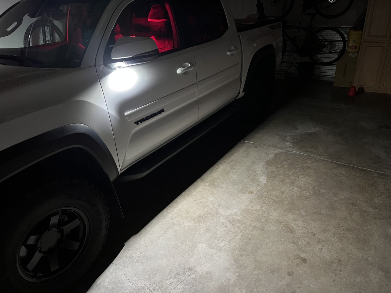

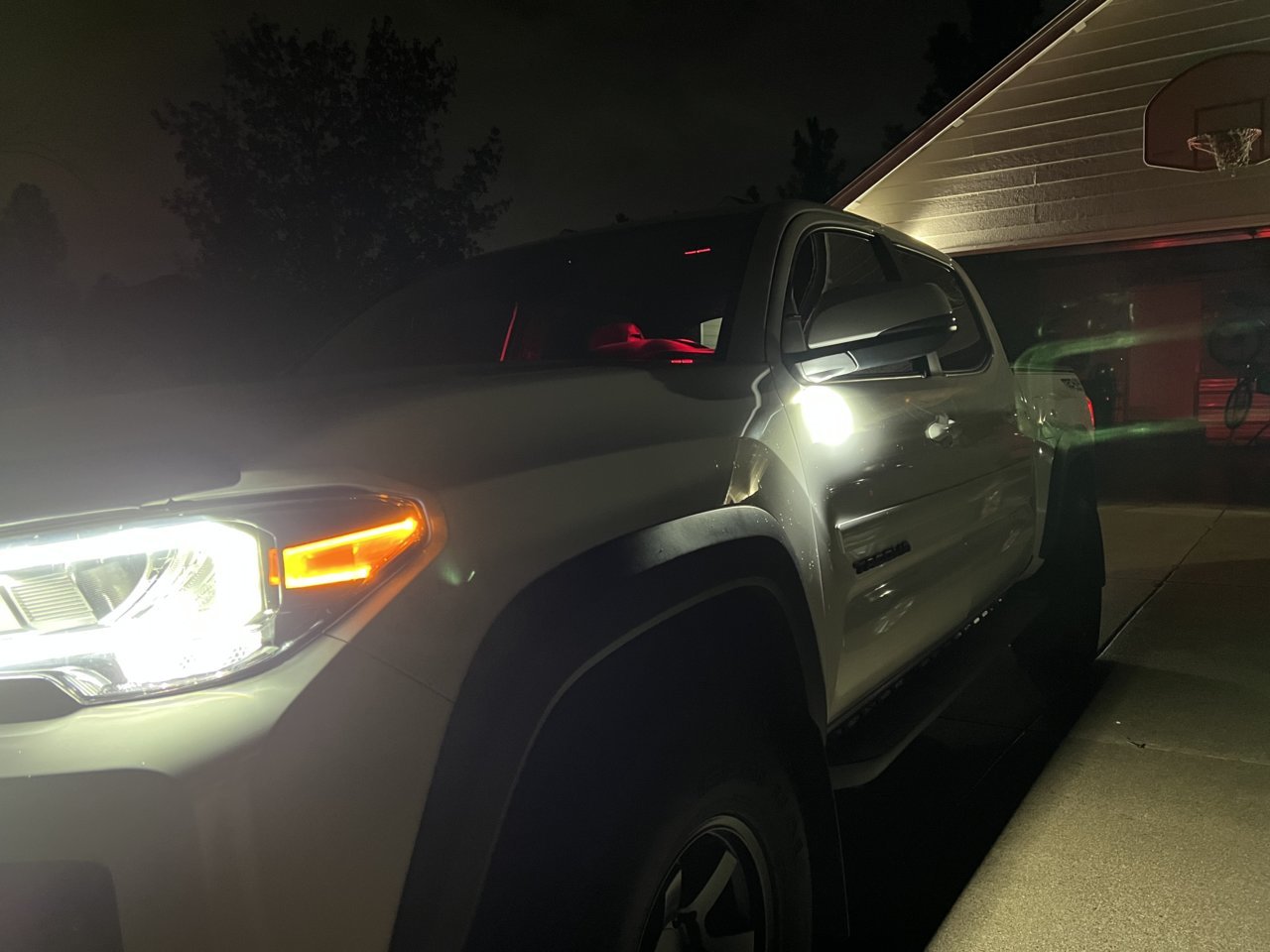

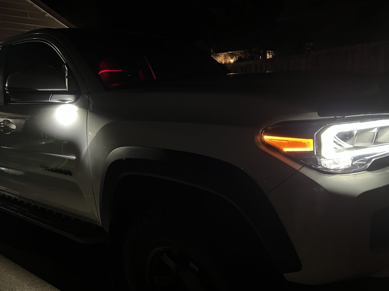

    Finally done! Didn’t break any clips! YAY!
    01633EE5-7E45-4A95-92A3-331FD202BDFA.jpg 782533B3-E83E-486D-B165-D026C80DFA03.jpg 9ED7AD17-20B3-41DD-AA2C-0B634FEDCBF6.jpg 8F9AB7DD-8D1C-4CBB-904B-C5F3521B2F32.jpg
    I wish the switch was available.

    the install is not hard, just tedious. Getting thorough the stock boot is the hardest. My best suggestion is to unplug all door connections in the kick panel(battery disconnected obviously) then you can pull the entire door jamb boot out and have it more accessible to route the wire. Tape the new end onto a coat hanger or zip tie and spray some water or soap solution on the end. Slides through like butter!
    Looks great! Switches are in production as we speak. Takes a while as they are custom made/laser engraved.

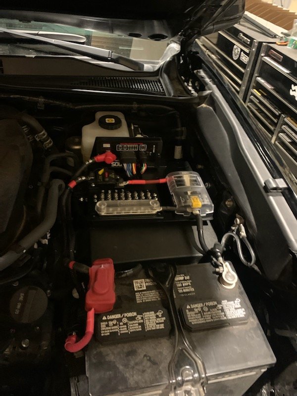

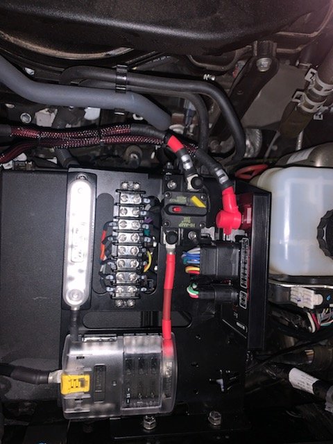

    My my, what’s this contraption we have here? Running multiple lights and coolers that you need a 100amp breaker? I dig it, you wired this all by yourself?
