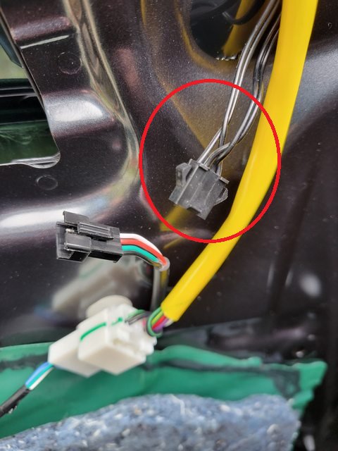

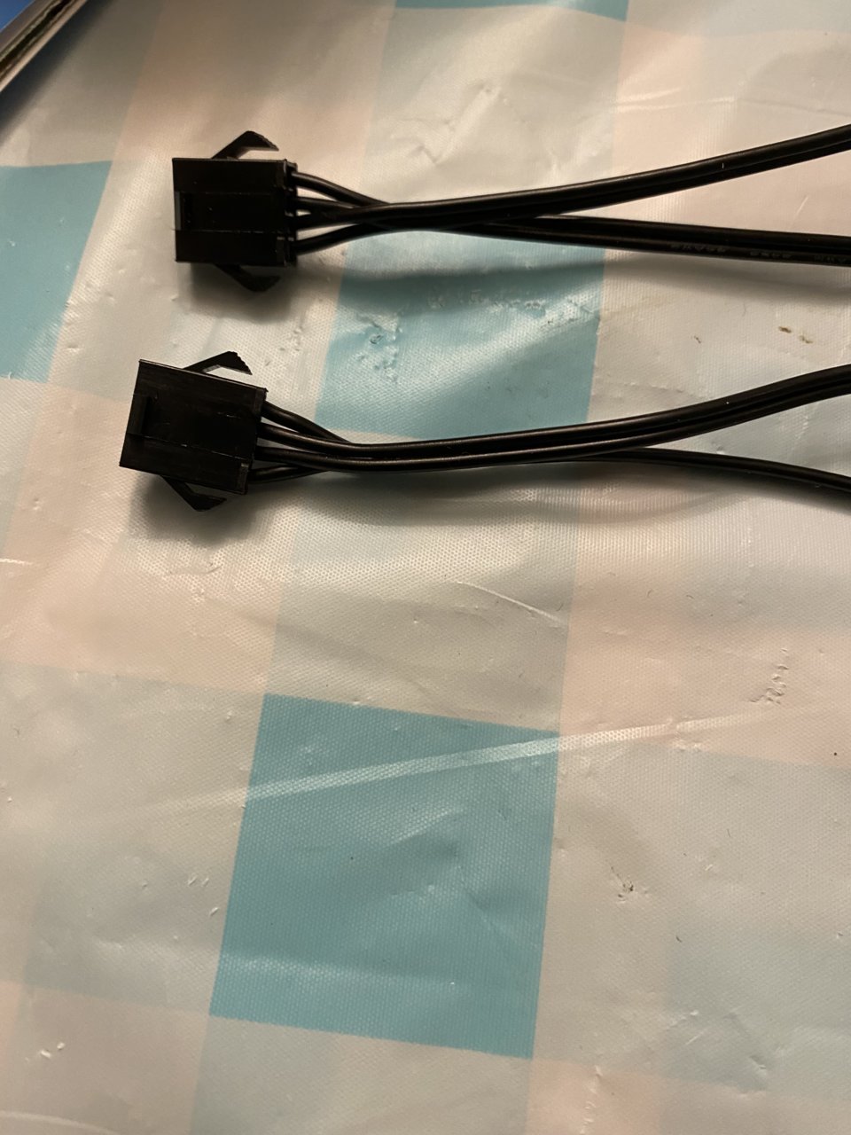

    I inspected wiring harnesses from the pigtail at T harness all the way to the connection behind the door that connects to the puddle pod light itself. all vled connectors have the same wire and pin locations as seen in the images below. I can't seem to find any issue with the wire unless it got damaged somehow but I'm not sure what else to check.
    I also swapped the puddle pod lights from passenger side to driver side just to rule out a possible bad led module but still blew a fuse after turning truck on with just the passenger light swapped so its def not a bad pod. The problem keeps going back to the wire harness between the T harness pigtail and the pod splitter in the door.
    I'm back out of options for troubleshooting and still only have the passenger side functioning.

    Looks like new colors. Anyone know if the pinouts have changed from before?

    I would check for continuity between the white wire to any other wire and the white wire to chassis ground.
    It's good that you ruled out the pods. It's only that cable running through the drivers side door that's left I believe. And, it is starting to sound like the wire has been cut and is now making contact with either another wire or ground.

    I just checked the wire closely for any kind of damage from both ends of the connector to the boot in the kick/jamb and the side mirror thru the door and neither end of the thick black cable was nicked or cut or would explain any type of short or exposed wire. These wires are pretty tough. How else would we explain how the driver side puddle pod works perfectly while connected while the truck isn't running? If there was a short, would it still work without starting the truck? Blows my mind how everything works exactly how it should until the truck starts.

    Sorry you are experiencing issues. Double check the short black 4 wire extension(12”) that goes from interior door panel and through the hole to the outside led pods. I have seen cases where the 10mm bolts(3 in total)that hold the mirror on pinched the wire, thus shorting it to bare metal.

    Could be a short or other on a 12V+ keyed source. Something could be bringing it to ground and would only cause issues when you turn on the truck.

    Yes, it makes perfect sense. Of the 4 wires, one of them is tapped into the ignition source.
    I think @MESO's suggestion is likely a good one (pinched by a bolt) because all your fidgeting hasn't made the issue go away. A cut wire would have to be in just the right spot for it to happen, and during troubleshooting the issue could vanish, but a pinched wire would hold in place pretty well.
