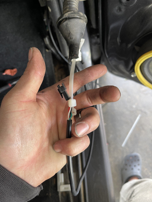

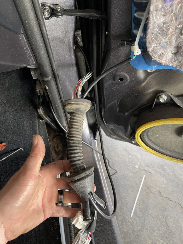

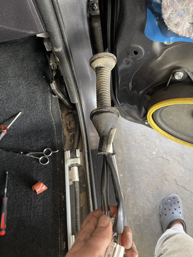

    Finally got around to installing them, took about 2 hours, wasn’t as bad as I thought it would be, definitely recommend a couple beers during install for sanity purposes :cheers:
    I have a couple recommendations for getting the wire through the tunnel..
    Pull the entire tunnel out with the connectors and straighten it out
    07470440-DDCD-4-F3-A-B263-A99-C2-D435-A3_22fdd0dacbfb2e2955ada0c56cbd8399c6880c44.jpg
    Stick a zip tie through the tunnel and zip tie the wire by the connector to the zip tie running through the tunnel
    FFB97114-B71-E-484-B-8669-F73-C82-CC46-B_341442753247751bd1ad08fcb514e27fbb64c602.jpg
    Pull it through while massaging the tunnel, easy 2 minute job
    098-FD848-738-C-4-F2-F-97-AB-E5-B3-DE7-D_c2009a3a104f0471e50bd7eebb6c6d0ceeec2b13.jpg
    Good luck y’all, I’ll post a night pic of the finished product soon

    the only different thing I would do here is to tape the connector to the zip tie. It keeps it straight and least likely to snag and possibly break off from the connector.
    thanks for the pics! Great visuals

    Prepped my truck Saturday and waited impatiently for usps. Was a fairly easy install if you're not rushing. I found the easiest way was to de-pin the connector and feed in through with just the wires. Much narrower profile. A great tool for snaking wires is a length of weed wacker string which most guys have in the garage. Super bright!

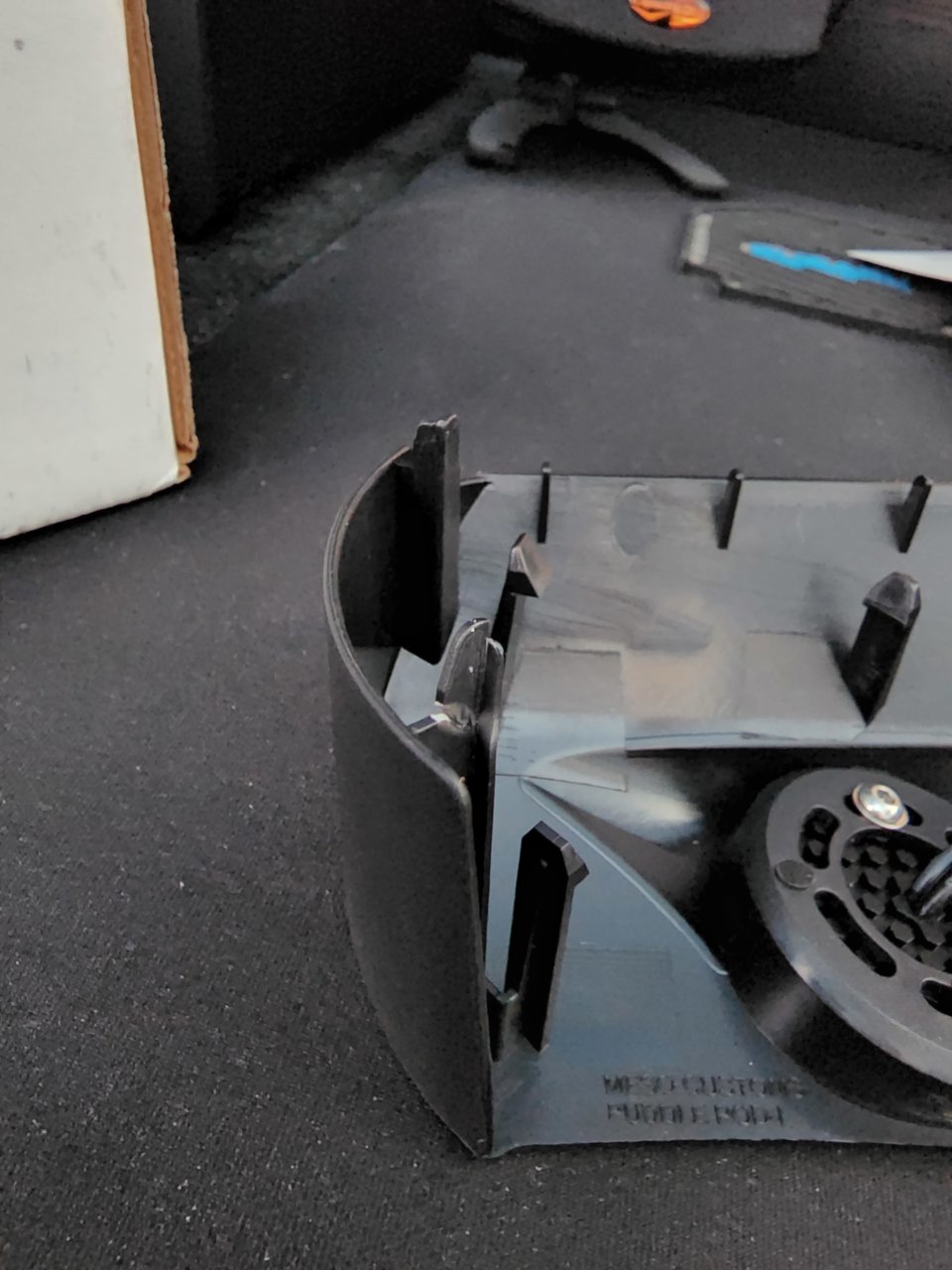

    Got my puddle pods kit today but noticed the one clip was half broken on my driver side. Submitted a ticket earlier.

    I broke one tab on each side installing.

    Once locked in they are there to stay. It’s taking them off which tends to be tougher and sometimes can break a clip.
    Shoot us a ticket though the website(best way to track redos) I have plenty of replacement plastics.
