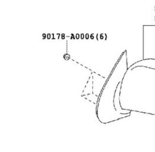

    ps any one have a part # on the side mirror 10 mm bolt head? I lost one
    Thanks as always fam

    The nuts that go on the studs?
    2002-2020 Toyota Mirror Assembly Nut - Toyota (90178-A0006)

    thank you!!

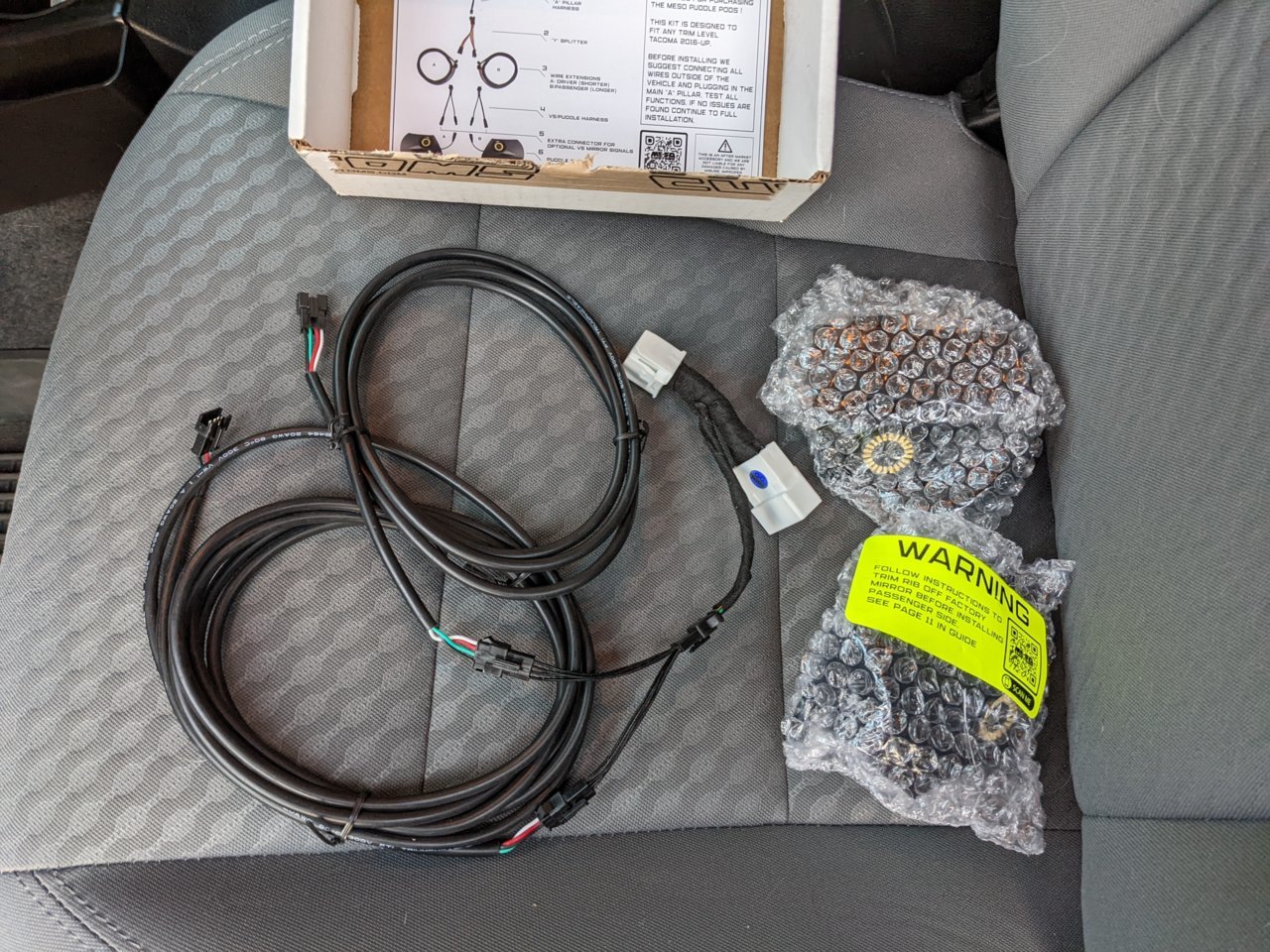

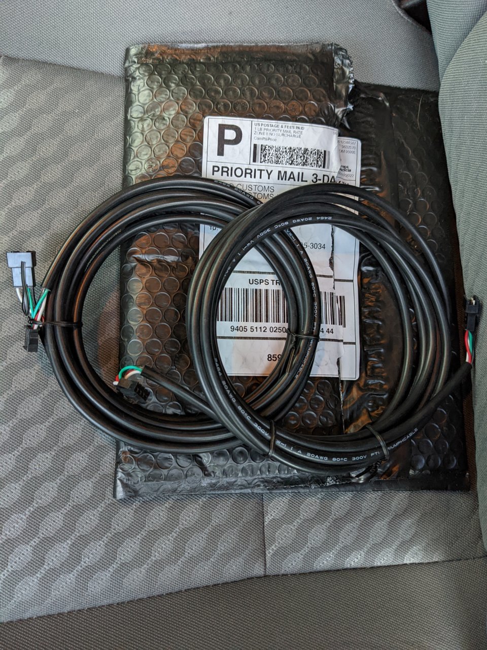

    I'm gonna cry. I ordered some puddle pods but was missing the V5 Harnesses. Created a ticket and ended up getting two passenger extensions :annoyed:
