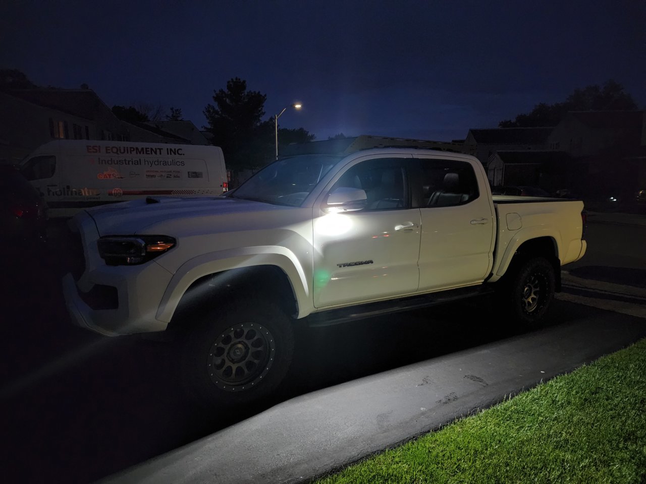

  13. May 15, 2022 at 1:19 PM
    #6573
    WhiteTaco20
    WhiteTaco20 Well-Known Member
    May 28, 2020
    #329685
    1,046
    Perkasie, PA
    SW 2020 TRD Sport DCSB
    I installed the driver side today, started at 12 and finally finished at 3. I originally wanted to install both sides but had stuff to do today. The longest part was probably running the wire through the boot. I finally was able to get it through when i applied some mission automotive dielectric grease (for lube) on the electric tape i used to wrap the connector with and used a straight plastic pry tool to push it up. I tried the zip tie and the metal claw trick but didn't work either. I guess I have more wiring because of the bsm and 360 camera. I also couldn't find a way to get the v5 harness in through the mirror hole to use the same connecter as the pods. I originally had the v5 tapped into the door wires and I pulled the harness from the mirror thinking i could use the v5 puddle harness but I couldn't so I had to run the wire back again. I did leave the taps on the wire though just in case. I'm going to do the passenger side probably next weekend.
    Dam325 likes this.

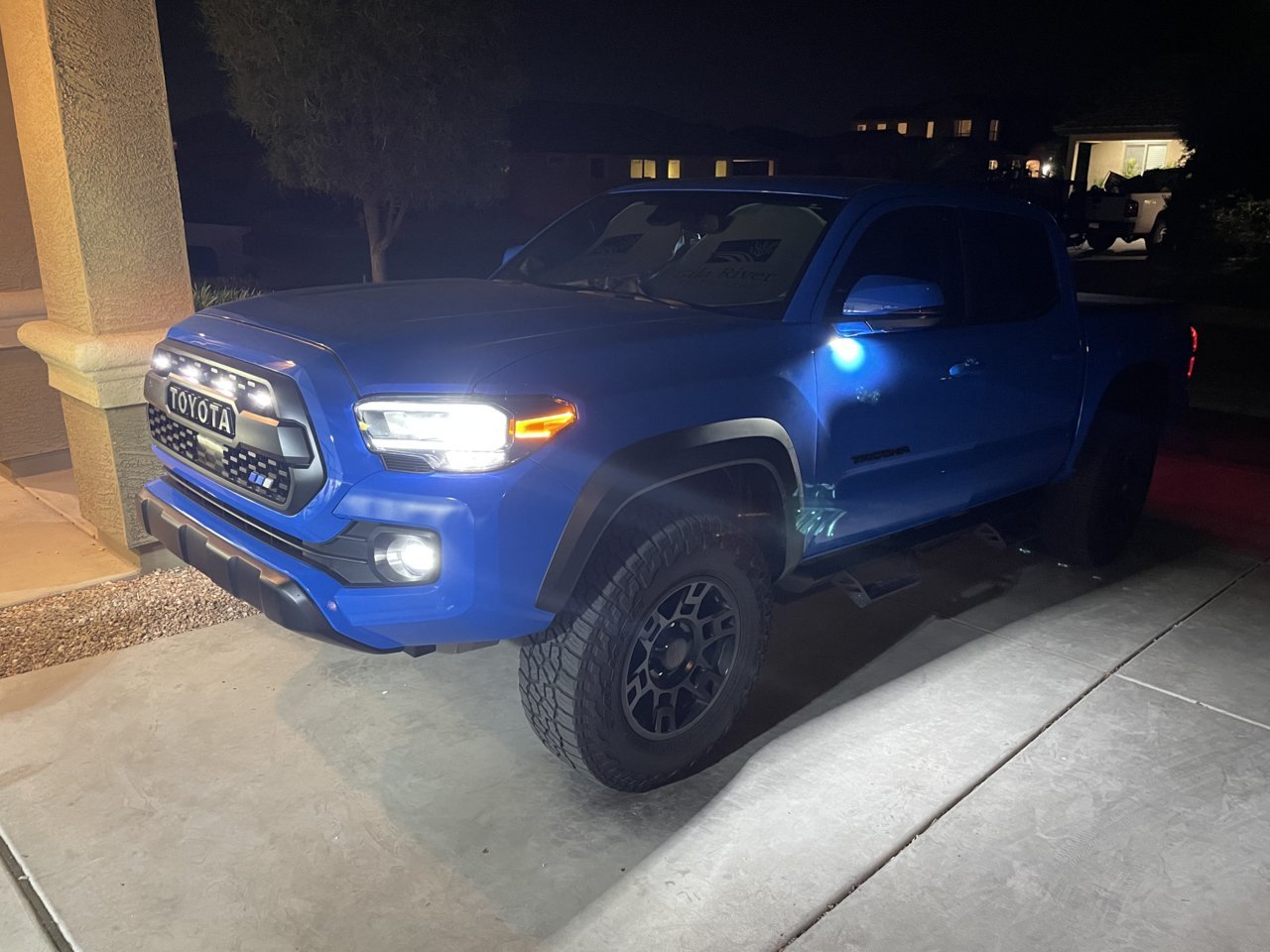

    7B06A656-E3CC-44D1-8D6A-07D00906E79B.jpg C388D205-9D4F-43D6-AA95-6E715B666BA5.jpg Got this done over the weekend! Pairs up nicely with the footwell lighting kit.
  15. May 15, 2022 at 5:48 PM
    #6575
    WhiteTaco20
    May 28, 2020
    #329685
    1,046
    Perkasie, PA

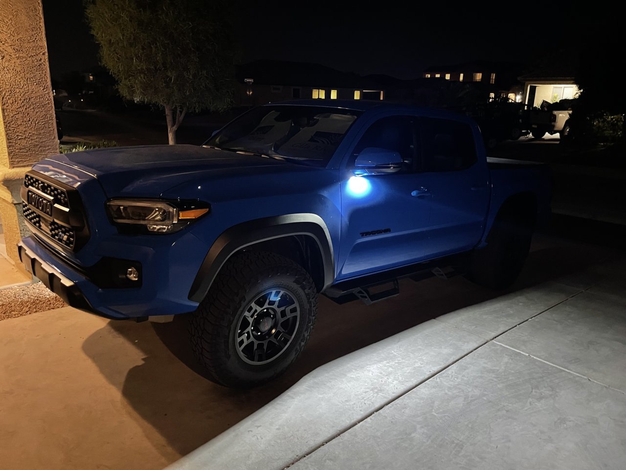

    Night time!
    jdrummer, ktbell444 and MiTacoTRD like this.

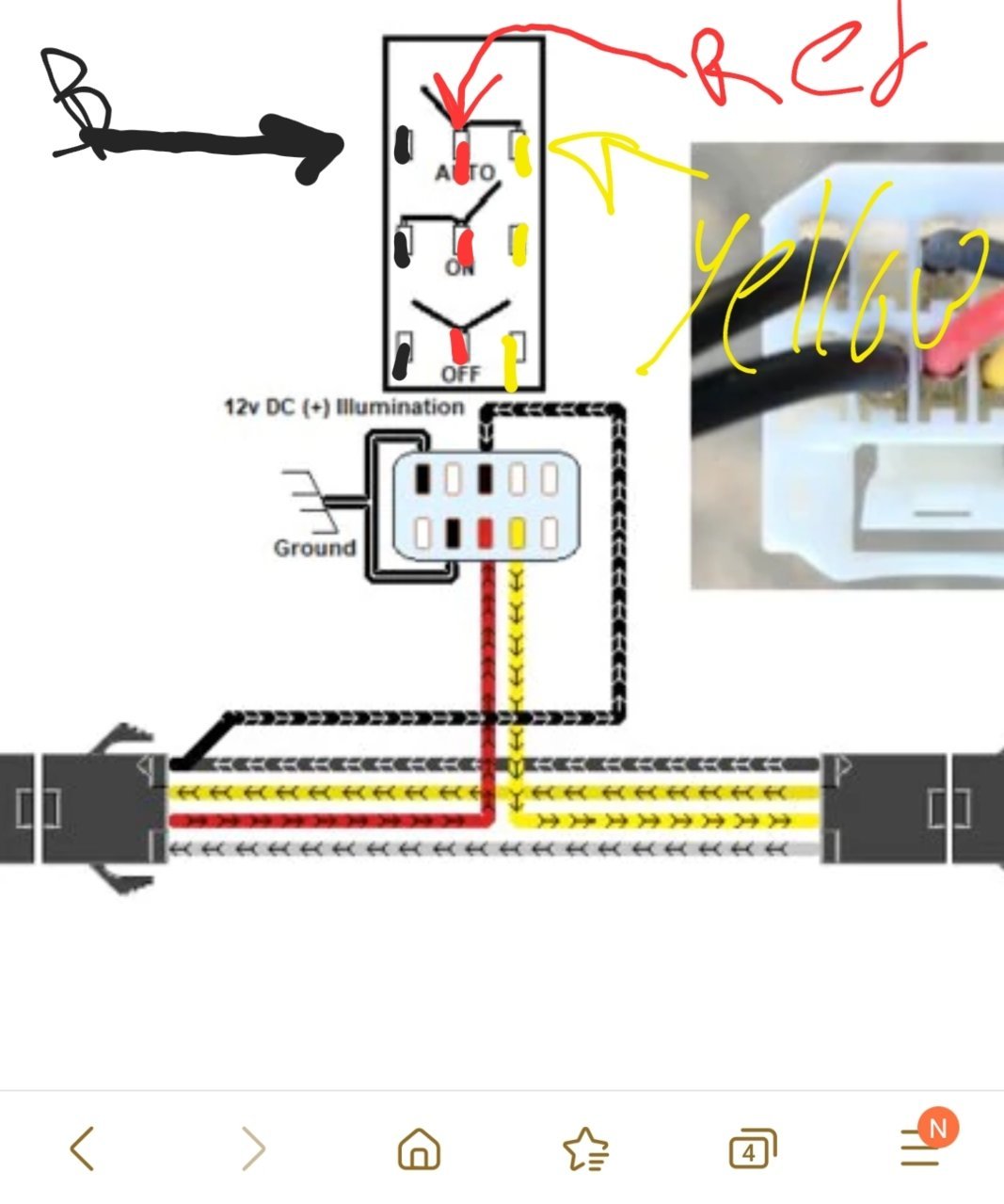

    So i got my pods installed over the weekend and love the look of these. There awesome, but I don't like that they stay on with the doors open. I was hopeing they could be tunred off with the OCP switch. The switch to do this is out of stock unfortunately and I don't see any ETA on restock. Can anyone confirm the photo I have is correct for wiring? From the switch ad, I just want to make sure my wiring is correct before proceeding. To turn these on red connects black to ground, auto connects yellow to red, and off just opens the circuit correct? Screenshot_20220516-130400_Samsung Internet.jpg 20220515_175044.jpg

    @MESO has said the switch kit is in production and shouldn't be too much longer if you willing to wait a bit.

    A kill switch wouldn’t be hard to do. Just in-line with +12v. But I think they time out when the dome times out so not a problem as far as draining battery.
