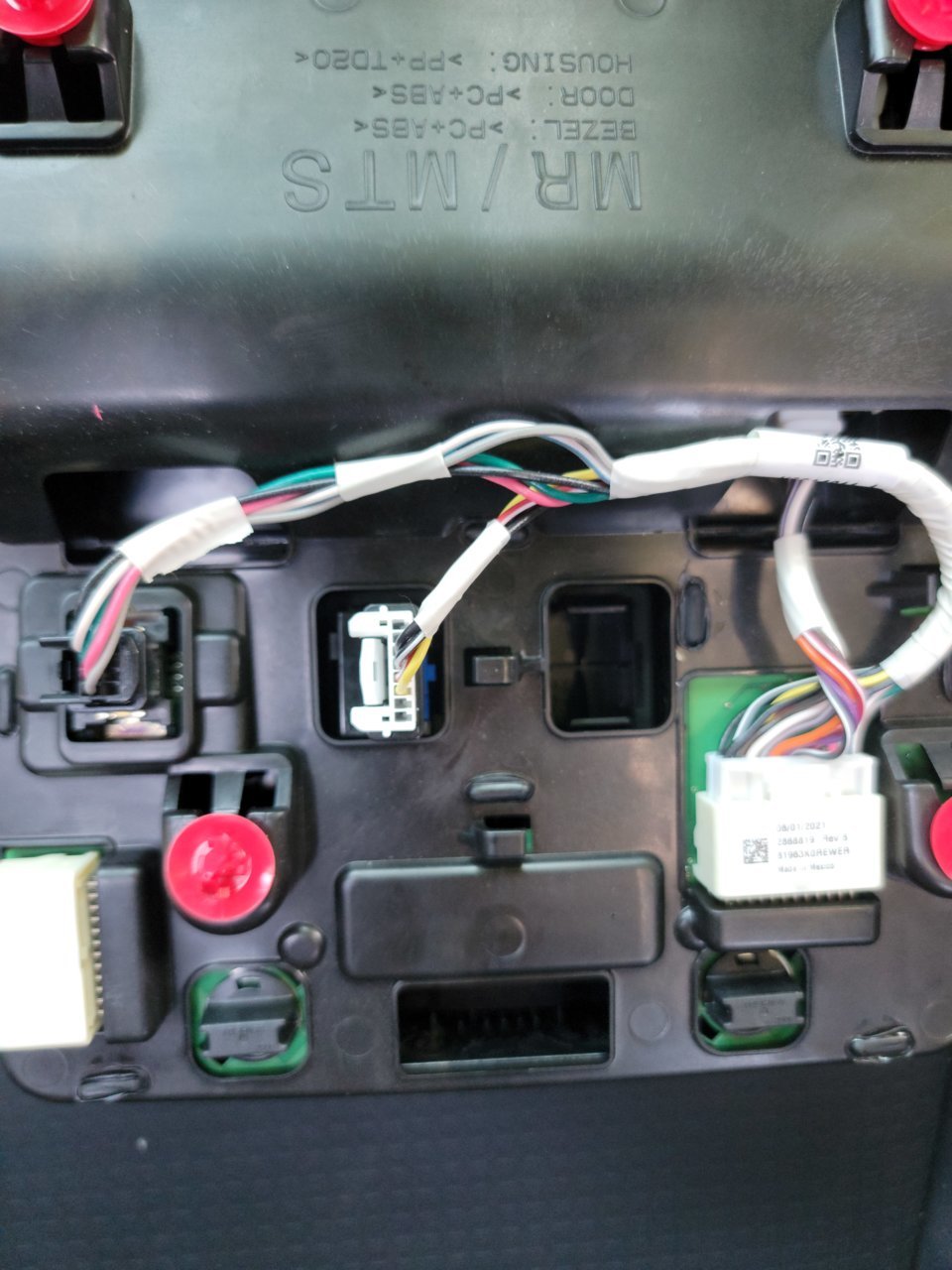

    There was nowhere to ground in my overhead. I guess I'll extend ect and put it up there unless I can figure out where to ground into the oem harness.

    Looks like you can ground to that center bolt.

    It's bolted to plastic.

    I extended my ground and re-sleeved, also added PWM - for switch illumination ground which is separate from the chassis ground for “on” then mounted the ground hoop to the driver kick panel OEM ground.
    For install in the overhead panel it might really be preferable to offer an extension harness to run up the a pillar and across the headliner.
    for now I’d probably just splice in extra wire and sleeve it.

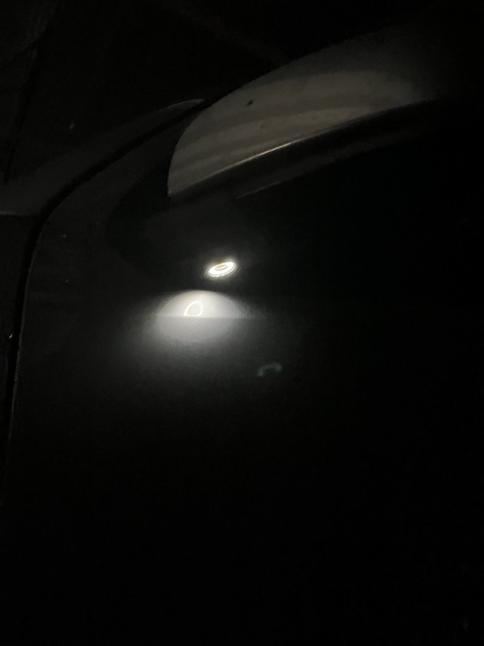

    The same thing happened again, I guess they were on all night..
  17. Jun 17, 2022 at 7:39 AM

    Oh man, that isn't good. Are you running the switch he sells for that by any chance?

    No, I missed the last drop of them.

    Hmmm, that is very odd that they are constant on then. I assume your dome lights aren't on since you didn't mention seeing them.
    I have a feeling maybe one of the wires in the A-pillar T-harness might be swapped or something.

    The problem is that it’s not all the time. This is only the second time (that I know of). After the first time it happened, I always duck down to check and see if they are on or not.
