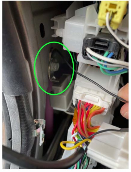

    I finally got around to installing my puddle switch. The OFF and AUTO work but ON isn’t working. Anyone know why that might be happening?
    EDIT: It was a bad ground. Moved it over to a proper ground and everything works perfectly! Thanks for the help guys.

    Check your ground.

    Funny I just thought about that.. where I put the ground is likely not great. Do you have a spot you recommend I ground to?

    Overhead or Driver's Left side area? (switch location)

    If the switch is on the driver side area...

    Here's another one behind the Head unit. If the switch is in the lower center panel area...

    Drivers left side. Thank you both I will go out and move that ground right now!

    Yes I did! I tried to find the bolt you had a picture of but my truck looked different for some reason. I ended up finding a good ground after dropping the whole panel below the steering wheel. It’s a ground point for something else on the bottom left of the steering wheel. Thanks for the help!
