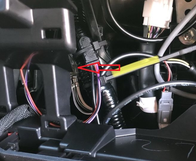

    2017 Toyota Tacoma TRD Sport 4x4 Magnetic Gray
    Where did you ground your switch too? I opened mine the the other day and didn’t find a convenient location to ground it too?

    Radio mourning bracket

  14. Jul 19, 2022 at 9:58 PM

    Here's a view of a ground choice in center dash area

    I did see that, and could not get my fingers to get that bolt off with just the switch cluster off to mount the ground there. Might need to remove the steer wheel back cover to access that area altogether

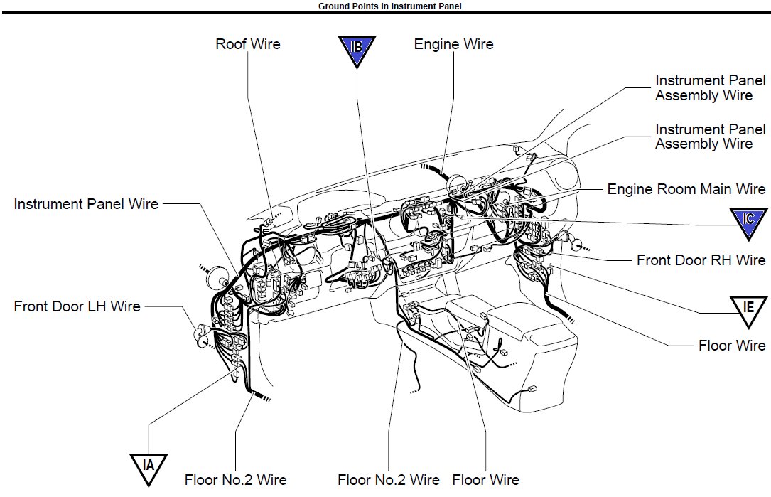

  17. Jul 20, 2022 at 12:00 AM
    #6737
    Ahomeofbones
    Ahomeofbones Member Well-Known
    Aug 11, 2021
    #373925
    500
    2021 TRD OR
    Is there a diagram similar to this for the overhead?
  18. Jul 20, 2022 at 12:23 AM
    #6738
    caribe makaira
    caribe makaira Well-Known Member
    Feb 13, 2011
    #51121
    11,761
    Caribbean, Puerto Rico
    05 PreRunner TRD Offroad AutoTrans
    Hood Struts, My version Fogs always ON, Map & Overhead Light Mod,
    Yes, what are you searching? (no grounds ID'd in the overhead)
    Ahomeofbones[QUOTED] likes this.
  19. Jul 20, 2022 at 5:19 AM
    #6739
    Ahomeofbones
    Aug 11, 2021
    #373925
    500
    2021 TRD OR
    A place to ground my puddle switch. I'm not a big fan of having it where ect is and wanted it by the dome light switch. Thanks for checking.
