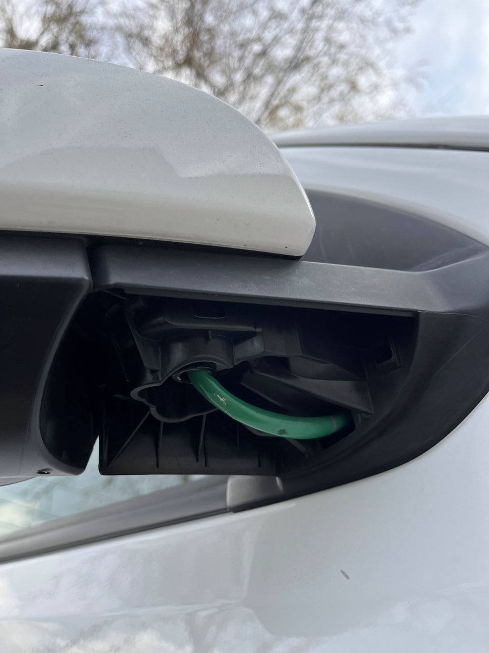

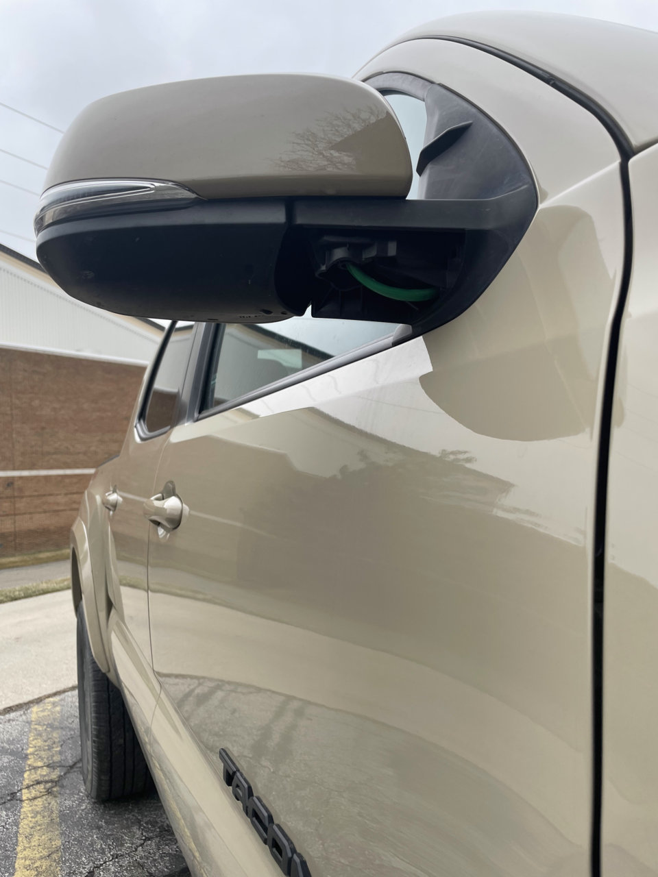

    I have been looking for a passenger-side lower mirror cover for a while and cannot seem to find them anywhere. If anyone can help me out it would be appreciated.

    I got you. Send me a pm and I'll reply in the morning.

    I have also been looking for a passenger-side lower mirror cover and have had zero luck. If anyone can help me out that would be amazing! Pretty sure someone took it off mine and would really appreciate any help.
