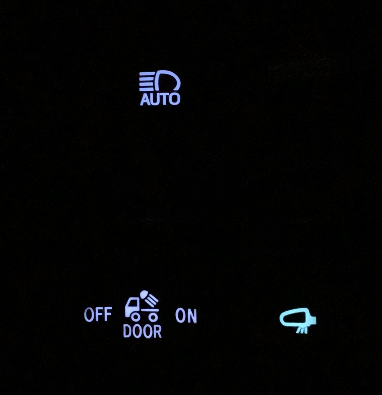

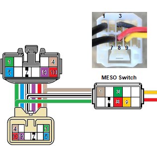

    This worked flawlessly, wired it exactly as pictured here with @kmorgan3 ‘s harness from guild outfitters, except for adding a 5.5k resistor on the positive side to get the illumination brightness in line with the other switches.
    Looks like it came this way from the factory, even at night.
    thanks @kmorgan3, @caribe makaira, and @daveeasa for helping me out with this one, would’ve been a ton of work without your parts and input!

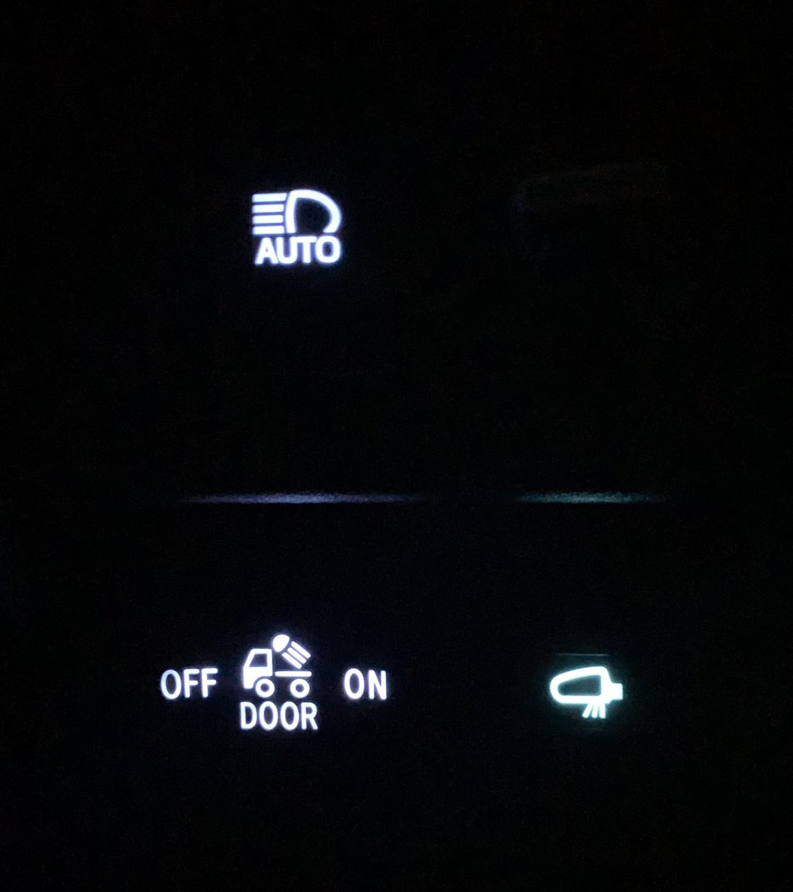

    Pics at dimmest and brightest:
