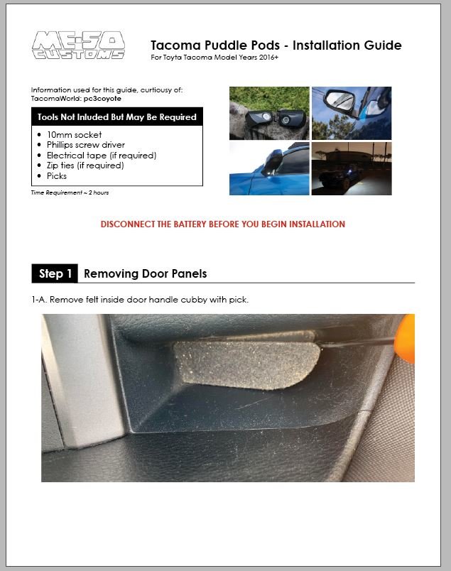

    That’s professional grade right there. Good stuff brotha! :cheers:

    :hattip:
    Fixed alot of spelling too :rofl:

    Little late to this but wanted to clarify few points. @MESO correct me if I'm wrong anywhere.
    MESOs puddles rests at 12v positive and the dome light signal provides the ground. So my harness isn't needed.
    For rock lights it's a separate deal. If you ONLY wanted courtesy lights then you could do the same thing to rocks lights where you keep 12v constant power and let the dome light do the switching.
    You need my harness (or equivalent setup) if you want either of two things. 1) The ability to switch on anytime with a switch AND courtesy lights. The module switches polarity so your just working with positive triggers. 2) Your running a relay on your rock lights which is recommended. And necessary for high current draw lights. The dome signal is a pulsed ground signal and if you hook it to a relay it will create chatter (relay turning on and off rapidly causing the contacts to move quickly back and forth making a buzzing sound. NOT good for the life of the relay and annoying). Module has a capacitor that holds charge on the coil to eliminate this.
    Ours will work together with a jst splitter for PNP. I am using the same T-Harness that plugs into OEM connectors, so only one of those required. I buy them from MESO who let me in on em. (Still super greatful for that).
    Been getting a lot of questions on how these will marry up. I will be getting one to test and can show it once I install but it's as simple as a splitter. The puddles look AWESOME alone and @pc3coyote I love them together, they look awesome! Can't wait to get it setup.
