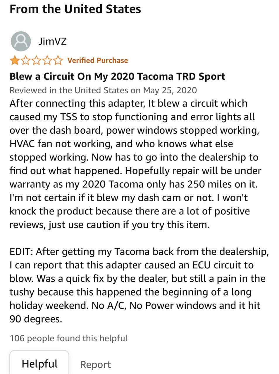

    So, when I read your post earlier, I had thought to ask about a dash cam as well. Do you have it wired to your rear view mirror with that special harness from Amazon? It’s only speculation but I remember reading in a thread here a long time ago about those causing issues.

    I do, but it is interesting because my setup has been status quo for about a year now with zero issues. Just overall a confusing situation.

    That is pretty odd but maybe they are all connected. I don’t remember when I saw that post but I’ll see if I can find it. Not that be bringing it up after they got your truck helps much…

    Still looking for the tread, I’ve found a few but maybe it was just the review I remember reading-
