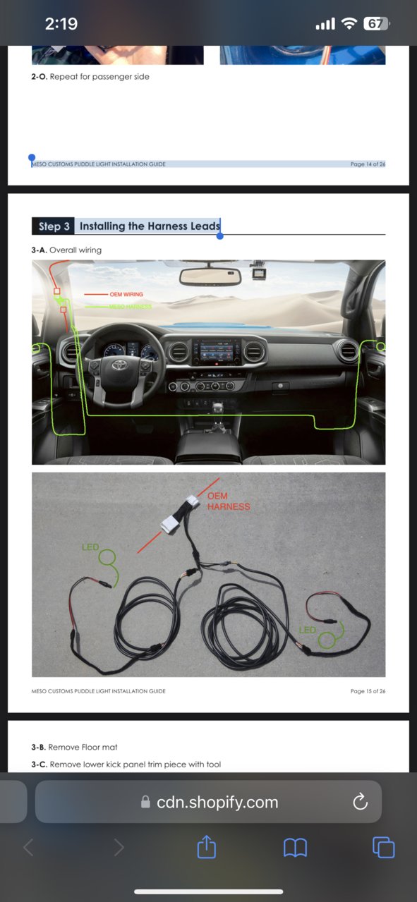

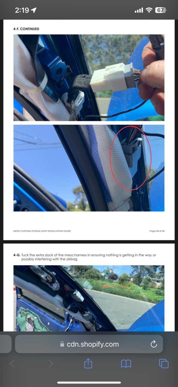

    so if you disconnect the puddle lights the interior lights work normally?
    where exactly are you connecting them...
  9. Dec 13, 2022 at 2:21 PM
    Lil Capo 503
    Lil Capo 503 [OP] Member
    Dec 13, 2022
    #413058
    11
    2020 toyota tacoma
    Yes!!!! It is connected to an oem harness. I’ll include the pictures

    ground side of those puddle lights are grounded somehow i think ...disconnect puddle lights and check for ohms or continuity to ground

    Oh that’s weird. If you are using the plug and play wiring and followed the instructions maybe something is wired wrong in the kit? It’s been a while but that kit seemed pretty easy to install.

    I just went through a few issues others were having (one I am glad I never saw) and there was more than one mention about wires being pinched during the reassembly and causing some issues.
    OP - maybe check for any pinched wires?
