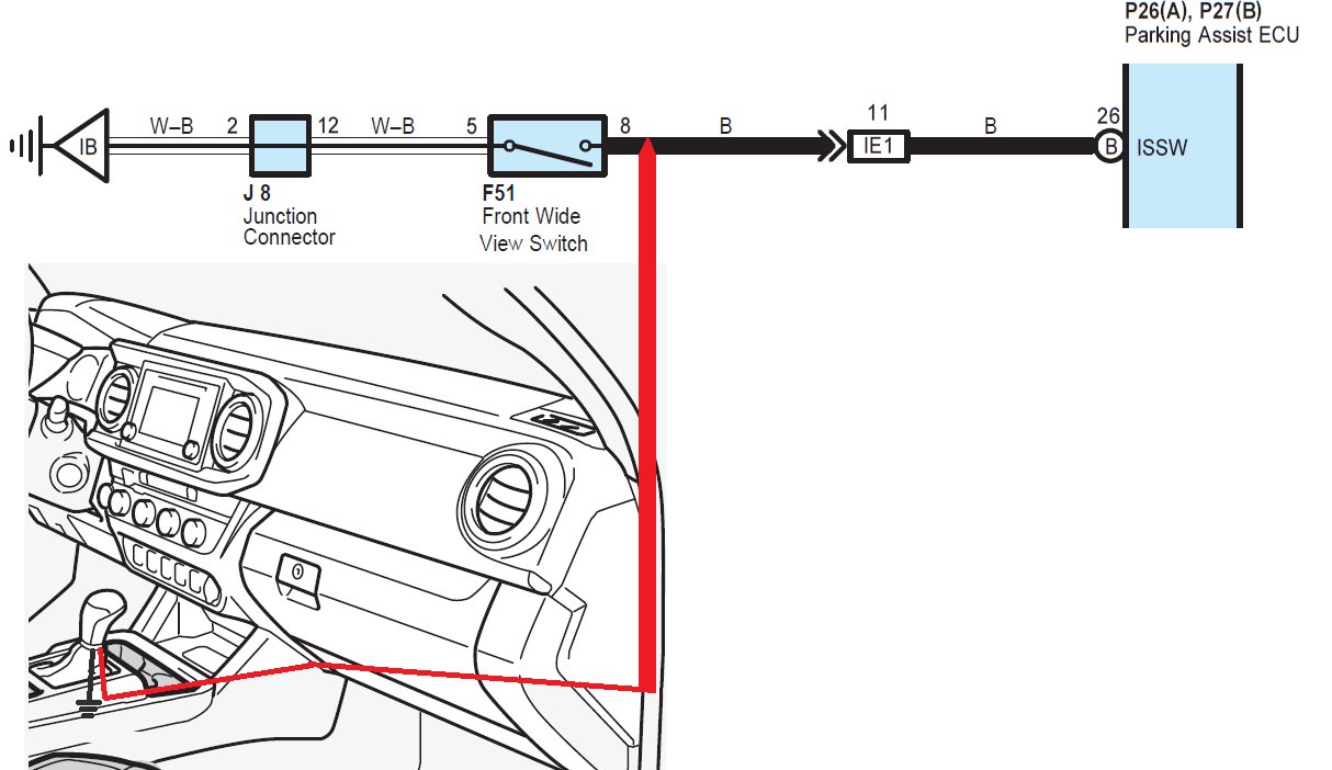

    The MESO switch will do the switching.

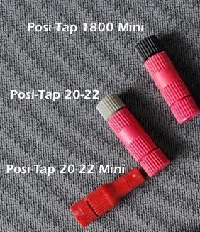

    You could also use these type
    WhiteyII[QUOTED][OP] likes this.

    Caribe help me…..I like posi taps as well but doesn’t the Meso switch get wired like a light switch only momentary in between the black wire? If not where is the second Meso wire going?

    To chassis ground.
    Red wire of Shift Switch to Black of Pano switch.
    Shift switch Black to Chassis Ground.

    Oh so we are completing a ground not power and that’s what make the screen change…….?
    So one wire from Meso switch to black wire with posi tap and the second Meso switch wire to ground……? Thanks for being patient.

    Just wanted to get back to you guys and let you know That the Meso stealth switch install went perfectly. I left switch on the left hooked to ECT switch and the right hooked to the view switch as Caribe helped me/us with…… it works perfectly cycles thru the different camera views. May change ECT later as the KDMAX tune pretty much makes the ECT not needed for me……..

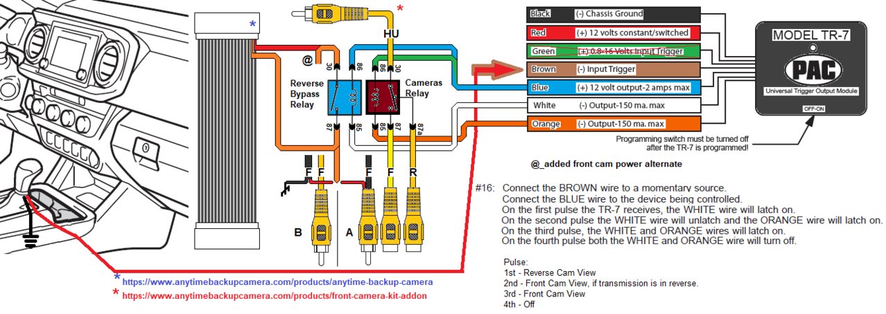

    Like this using the PAC TR-7 (don't forget to program it as I did):

    I have no idea how to program a PAC TR7....from the image, it looks like the blue wire from the lights go to the PAC TR7 and one of the wires from the shift knob goes to the brown wire on the PAC TR7. You ground the other wire from the shift knob but what do you do with the other 2 wires from the lights?

    The TR7 is easy to program once installed. You simply move the switch to program mode and click the button 3 times. If you don't like the wiring then you might try boomer's option.

    Was I correct on the wiring though? Do I just cap off the other 2 wires coming from the light harness?

    It looks like you'll use both wires, but not use the blue one. See around 3:00 here:

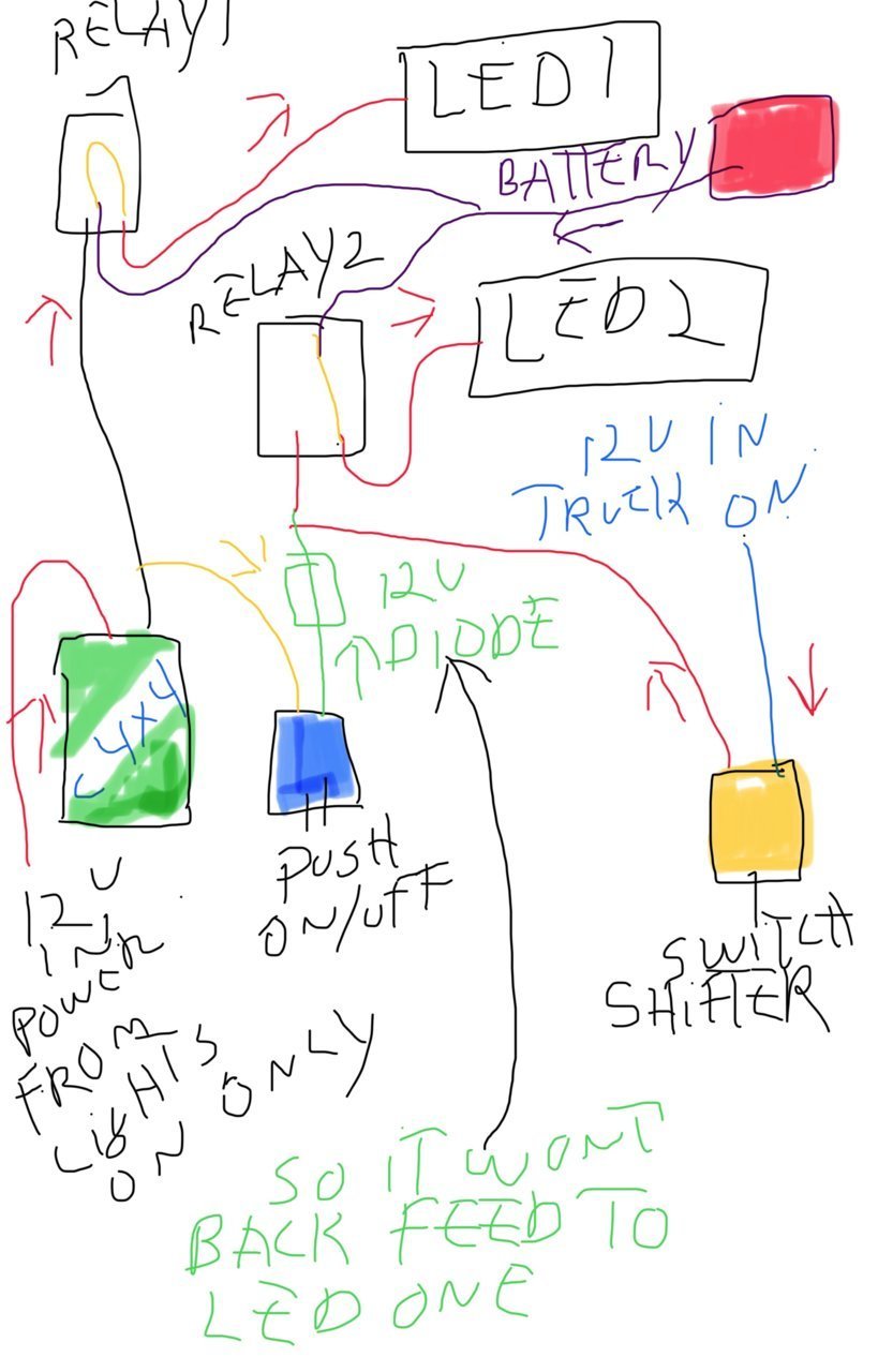

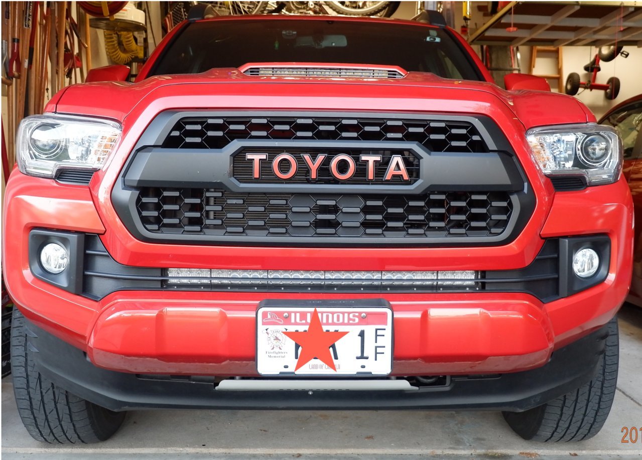

    I just bought a 17" Single Row LED Light Bar on Ebay back in 2018 for $40 and just used some 3m Tape to hold it in place. fits nice and tight, left the grill in also. it won't light the road but will light signs and trees on back roads,
    I also have a AUXBEAM 32 INCH 180W CREE COMBO STRAIGHT LED LIGHT BAR (5D PROJECTOR LEN) Behind the grill also down low for $80 at the time.
    This is what i did YES IT IS VERY CRUDE I drew it by hand on my tablet, so it is what it is..
    i have 2 ways of turning on the hood light. momentary with the switch and a over ride button when i have the bottom light bar on only, so i don't leave it on down the road (the cops will not like that)
    Hope this helps
