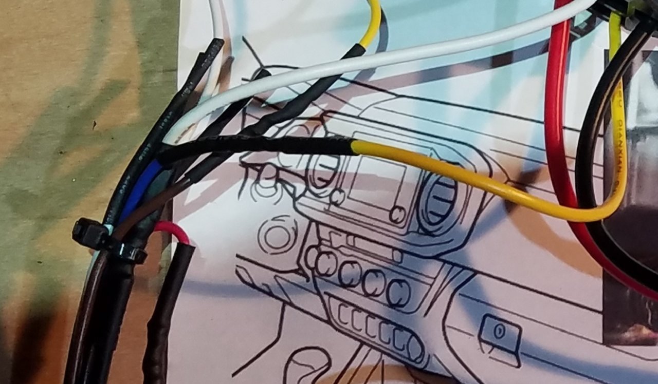

  13. Apr 16, 2023 at 10:59 AM
    #73
    RyanDCLB
    RyanDCLB Well-Known Member
    Jun 13, 2019
    #296235
    3,547
    4/19 DCLBOR
    It looks like the two whites are tied together for the ground. The yellow and blue are separate.
