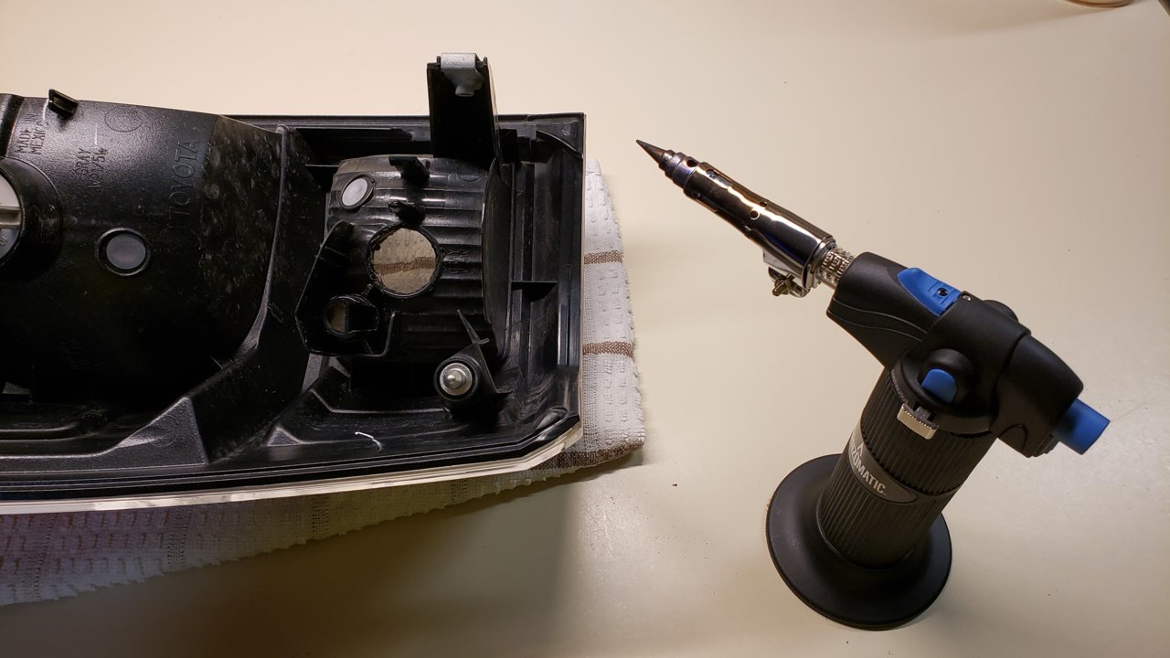

    BernzOmatic with the soldering tip, work great!
    MESO[OP] likes this.

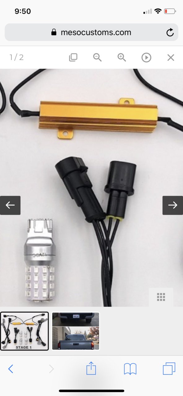

    I can’t tell from the 1st post- what is the plug for the resistors look like on stage 1?
  11. Apr 19, 2019 at 6:33 PM
    #2071
    NoOne
    NoOne El Taco Guapo
    Feb 6, 2018
    #243575
    5,871
    Ø ©
    Gulf South
    2022 Tacoma DCLB OR (AT) - BC
    2018 SR5 - (Sold) 2018 OR - RIPieces 2022 OR - BluCrush
    Tyco 150, from the looks of it.

    That looks to be correct.

    Working on stage 1’s, will be ready next week
    That’s a first version pic, the new ones have a standard TYCO 2 pin(resistor) and TYCO 3 pin(turn/reverse/ground)

    Which side do they need? Male (Pictured) or Female (has the latch)?
