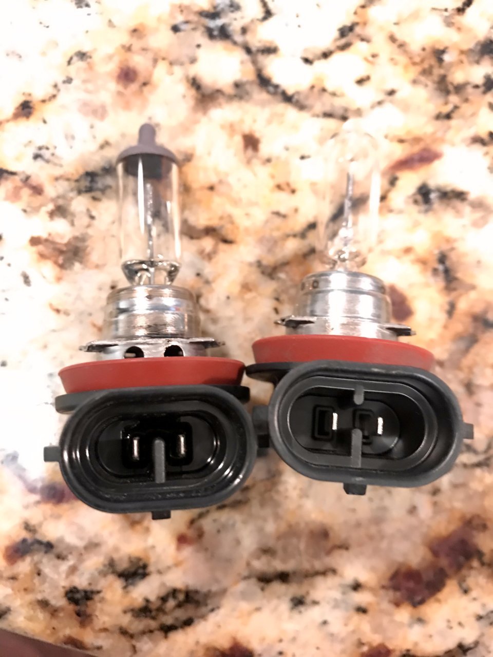

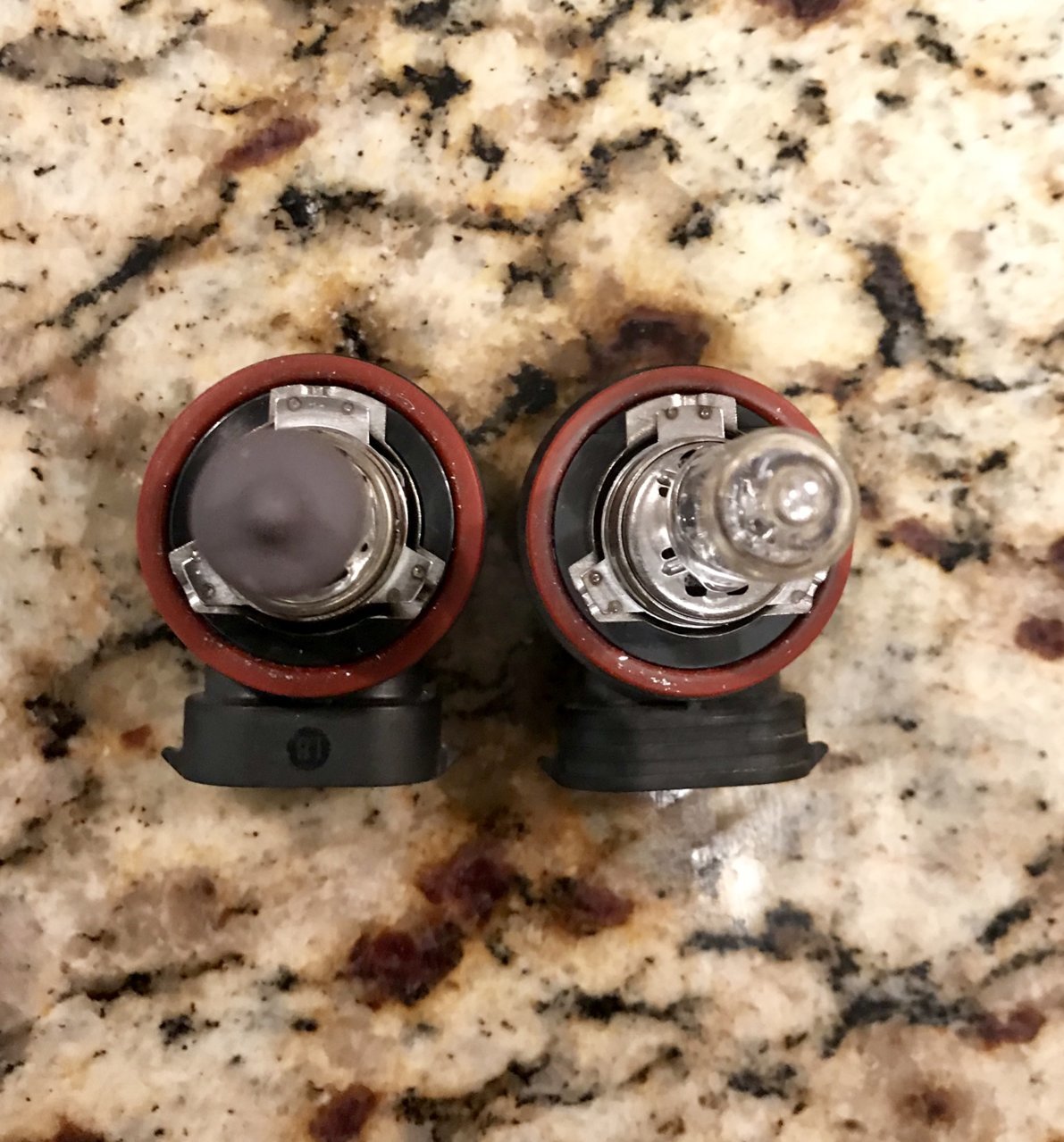

    I took a look at their site, looks like they're indeed interchangeable. The problem with other bulbs is the way the socket is shaped. Left is low, right is high:
    The way they actually mount into the headlight housing (the metal prongs) is the same:
    The VLED bulb connectors are universal and will plug into either socket. The tops of the socket that hold the bulbs in the housing are identical, so you should be good with VLED. Other bulb brands, can't be so sure unless you know it will connect to the stock headlight connection. Clear as mud?

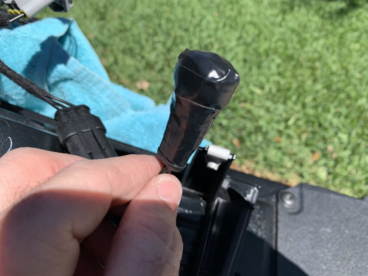

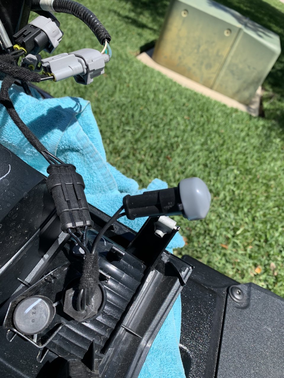

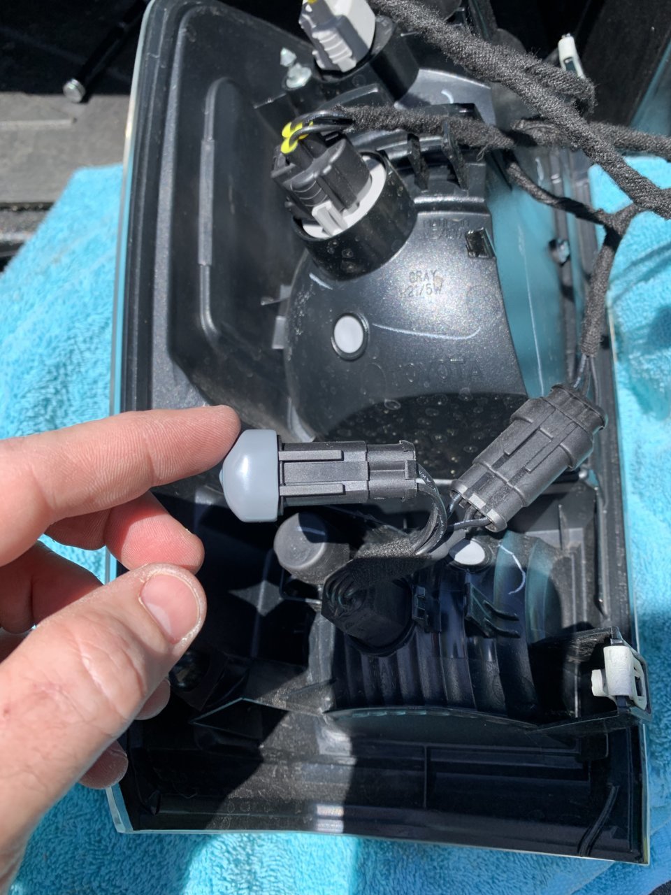

    For those trying to cap off the plug after removing resistors, I went ahead with 1/2” rubber caps from Home Depot and stretched them over the open ended plug and finished it off with electrical tape. Took a little stretching but it worked.

    Actually, I was just thinking this might be a better idea for most. I wasn’t 100% sure of the cap size, since I don’t physically have one of the connectors. I would perhaps suggest putting some dielectric grease inside the cap/tip of the connector to inhibit corrosion, prevent water. It should help with sliding the cap over as well.
    Good call @NuTacoma18 !

    Thank you sir. I forgot to mention I did put a little dielectric grease in the plug before installing cap. I didn’t use it to slide over but not a bad idea.
