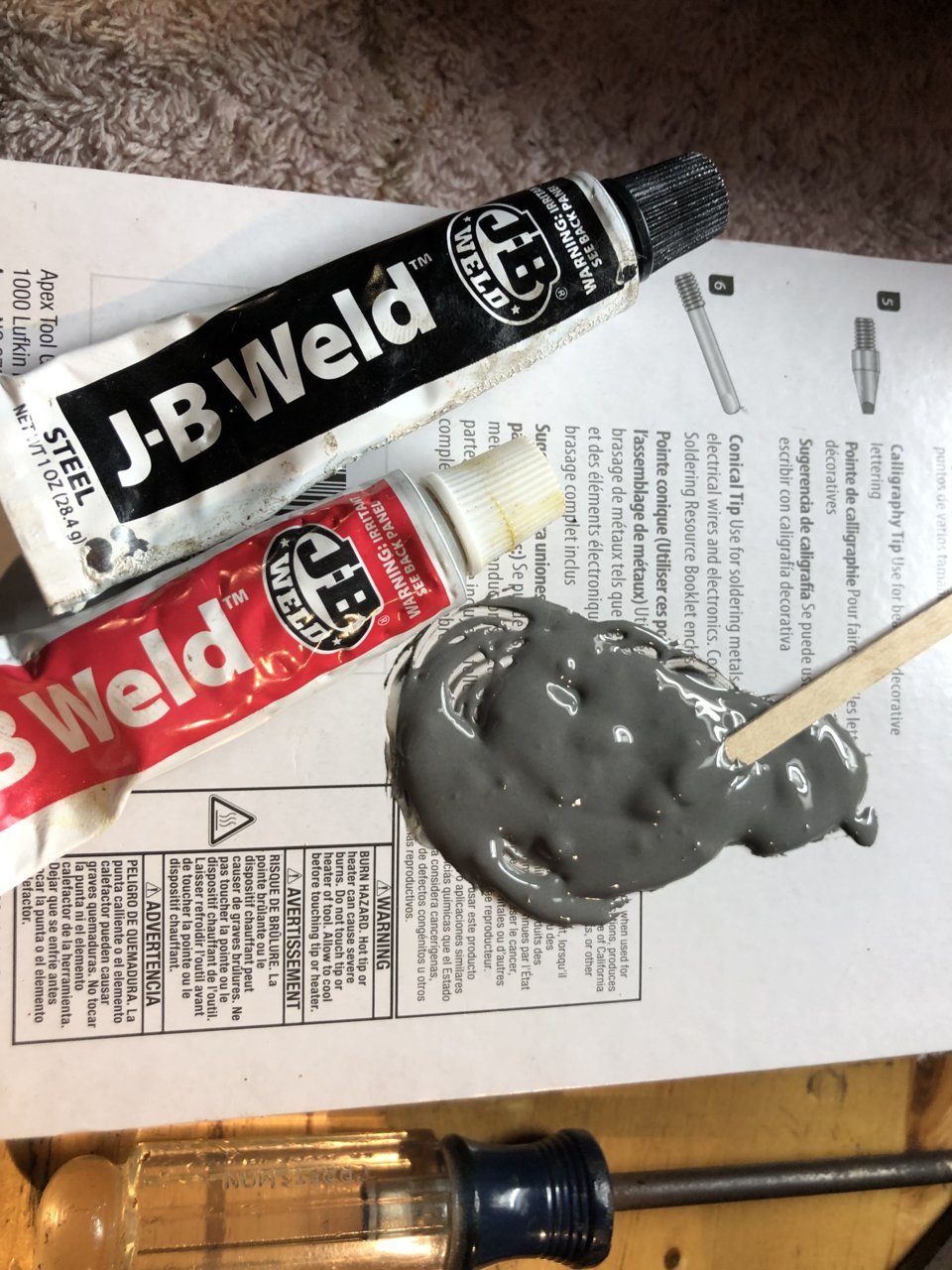

    For all those that have done the stage 2 - What epoxy is recommended? I see JB. I'm not smart enough to track all the polymer types..just a normal 5-min epoxy work too? Or is JB the best so far?
    Thanks!

    I used the JB KwikWeld. Just mix and put on. It set pretty quick.

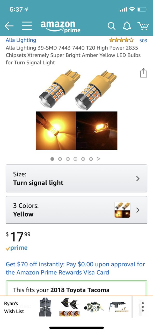

    I used these...

    Alla Lighting

    Wait, that's too affordable; something's not right. Can one of you kind LED guru's give me reason to spend $100 more on the VLED?

    A lot of cheaper Chinese bulbs are ran at maximum (often higher) output. Obviously to get the maximum brightness. But there is a trade off...life expectancy. Not saying they are not bright, as we can tell they most definitely are. But with higher priced bulbs you are paying for better quality components, and running more efficiently(while still putting out the same brightness or more)=longer lasting bulb. I mean for $20 its worth a try, and in no way am I bashing them. Just putting in perspective what differentiates cheap and more expensive bulbs:)

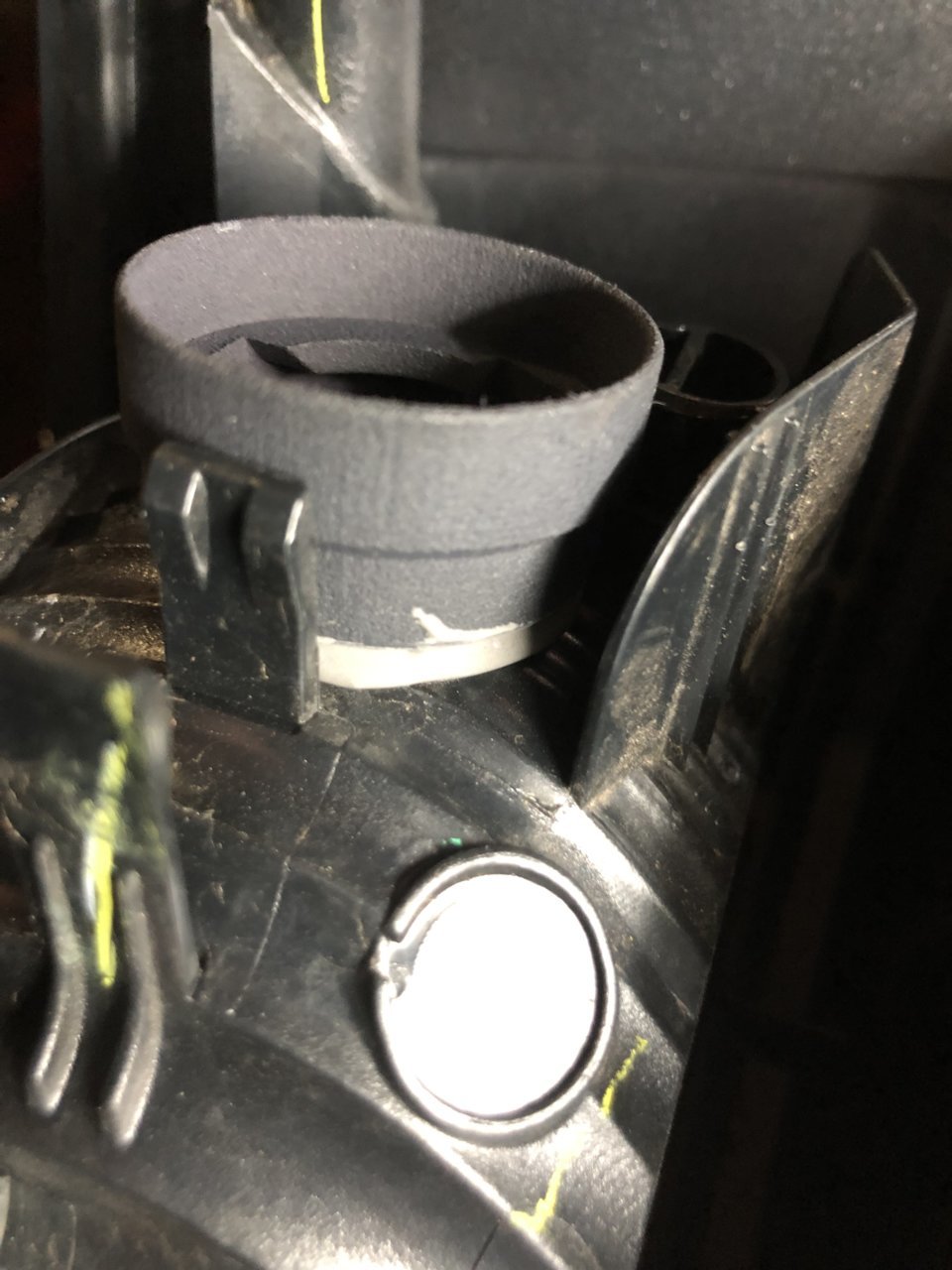

    I used 3M universal adhesive black PN: 08223.

    I used J-B Weld Plastic Bonder. 15 minute set, 30 minute cure.

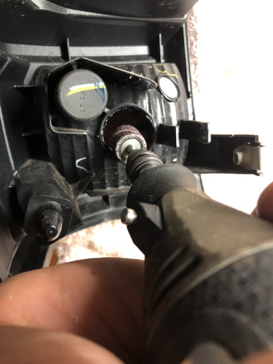

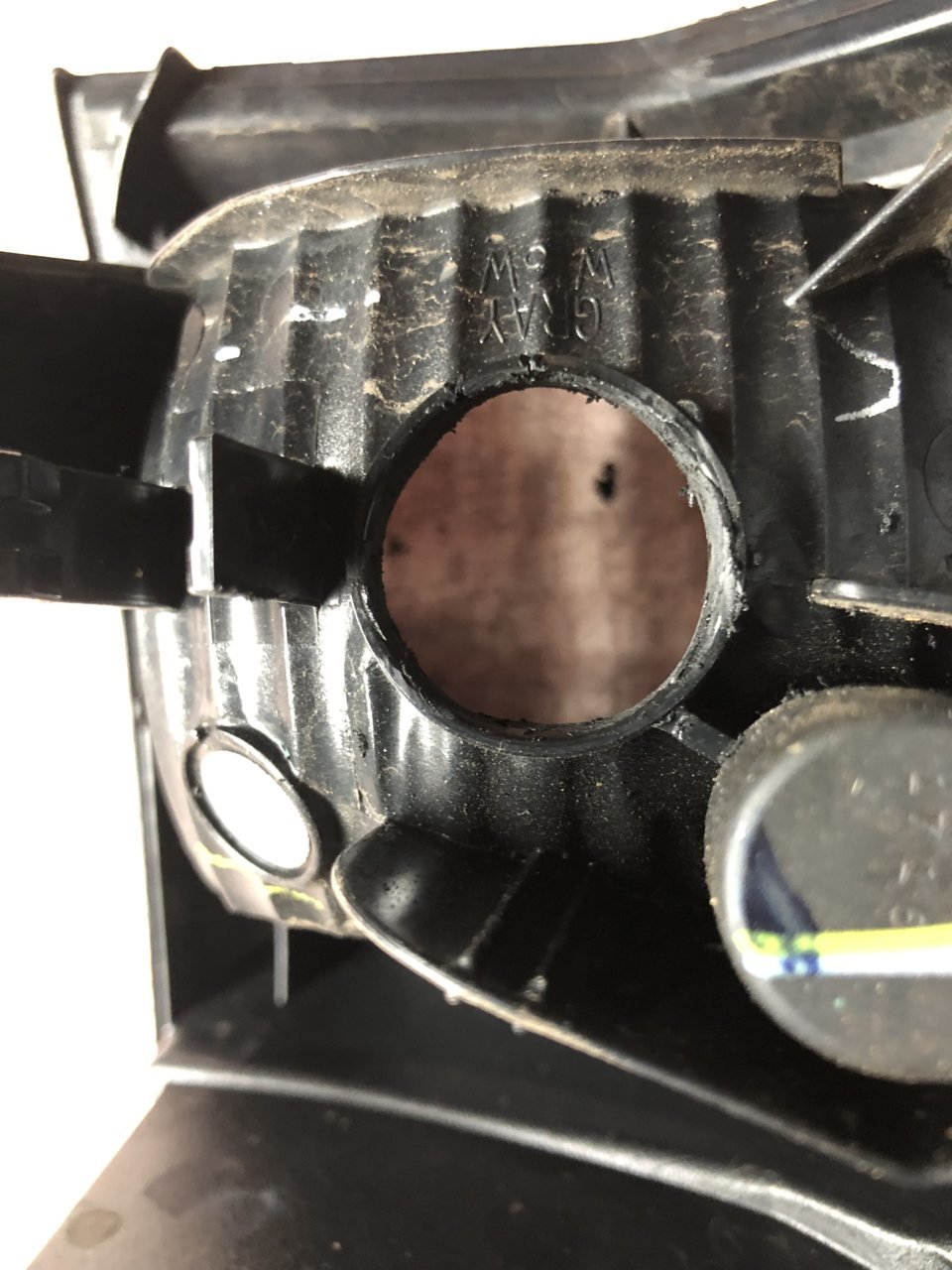

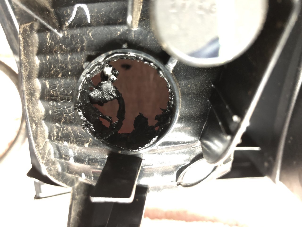

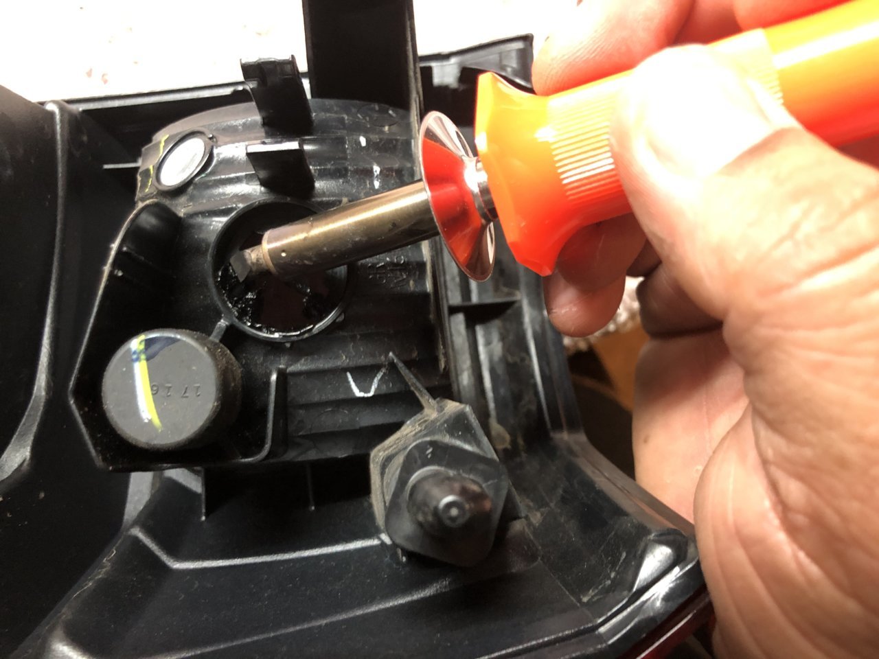

    I used a torch and xacto knife and it came out fine. The lip won't be perfectly smooth but it fit the adapter and epoxy.

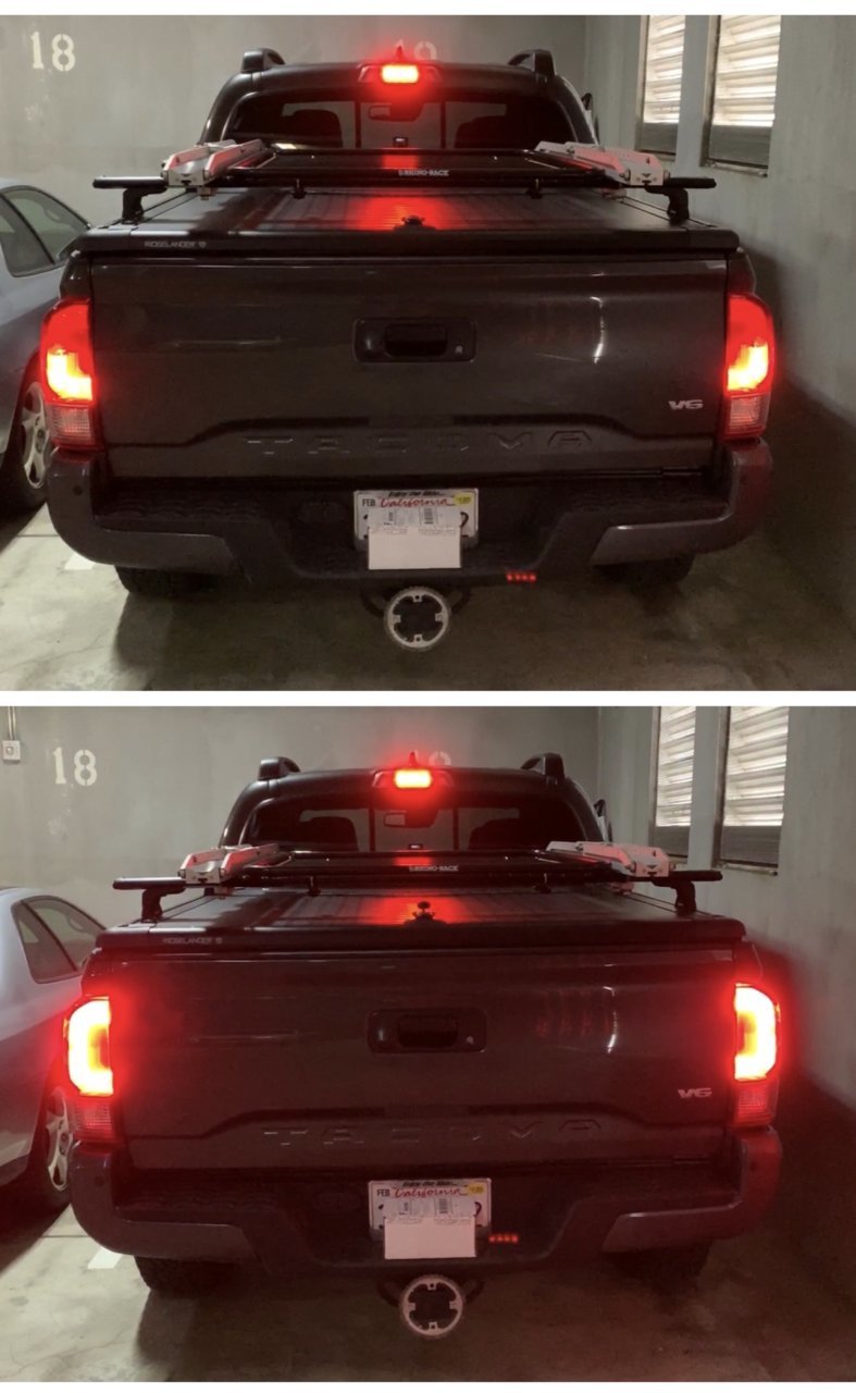

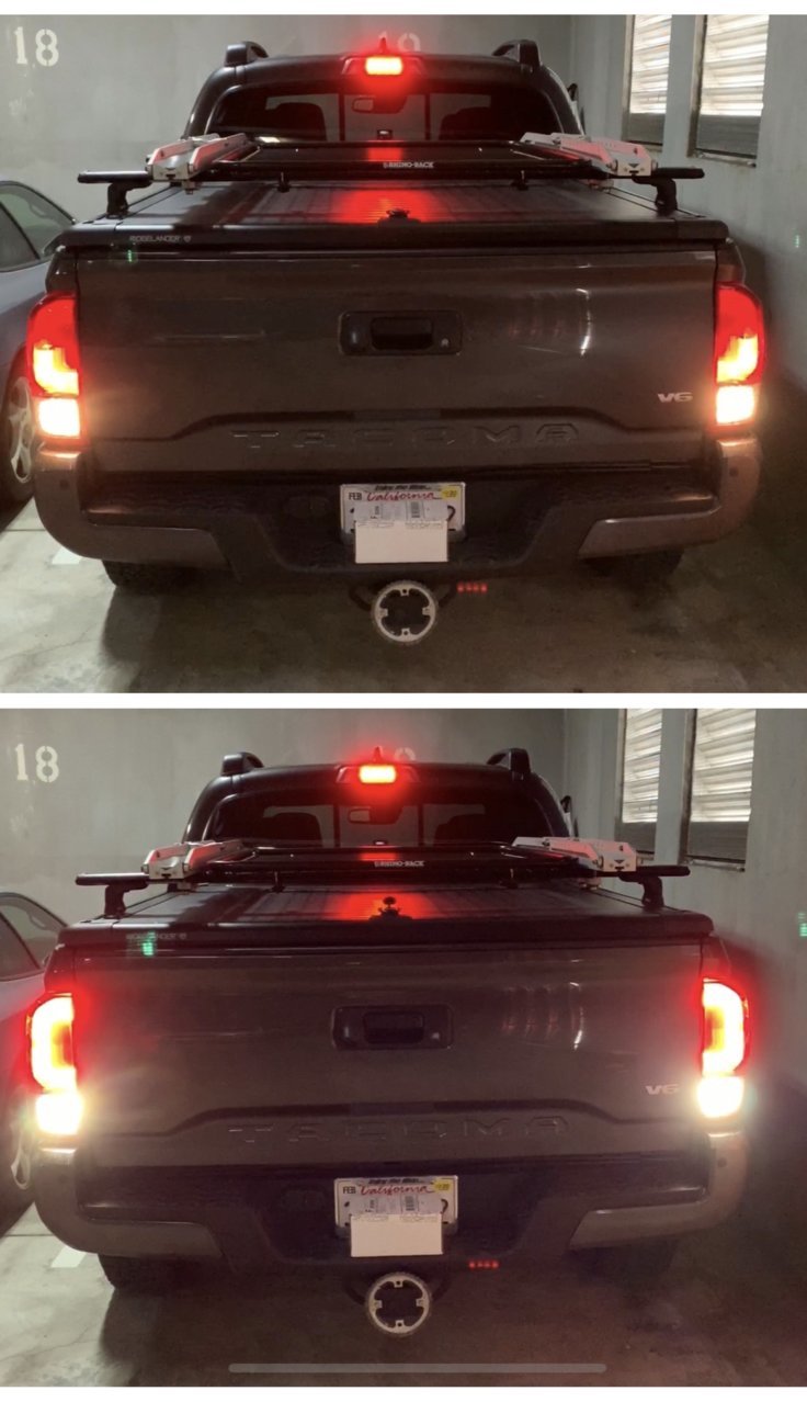

    Wow. Me-So impressed again! Thanks for an awesome product and quick shipping! Stage 2!
    brakes. before on top, after on bottom

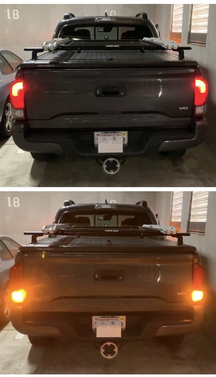

    hazzards/turn signalsF0D49F51-1071-4AD4-A6D7-A9D9209B58B0.jpgreverse

    God I hate the half horseshoe.
    Looks so incomplete.
