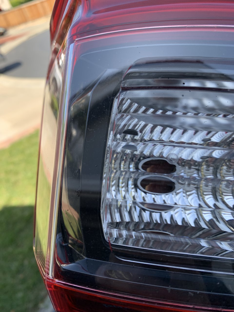

    Step drill bit + Dremel = messy. Any tips on how to clean out the housing @MESO?
    EDIT: air compressor actually cleaned it all out. Now waiting on the JB Weld to harden!

    I’ve noticed that even holding it upside down, small particals may find themselves still getting inside. I think it has to do with a static charge or something. Either way, hit it with some air and should be fine.

    For those that drill you can try stuffing a clothing dryer sheet into the light housing that will stop the static. Make sure its not one of the oily type sheets or you may get smudge marks on the inside of the lens and that would not be fun. To be safe I would try a used sheet it should still work to stop static. I use them for reloading ammo rub them in the powder feeder before adding powder to stop static cling.
    Just make sure not to catch the sheet with the drill bit.

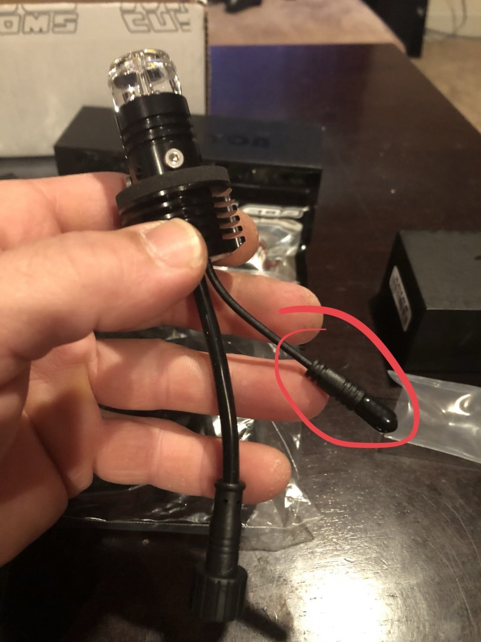

    I am installing my stage 2's and have a question about the triton bulb. It has an extra lead and comes a terminal connector... is it a ground wire? What are you guys connecting it to?

    You’ll just leave it be
    I think it’s for a dimming function of the switchback but that’s used for front drl function.

    Are you talking about that wire? @r_to_the_k and @Red18Taco707 mentioned that it is not used since no resistors are installed.

    Maybe I’m wrong then about the dimming function but I thought the resistor was used with a y splitter on the main plug

    Yup. I didn’t use it, just left it dangling... however I might cover the end with a rubber cap since it’s exposed.
    I have load resistors on my front turns, so I didn’t need them for my rears...
